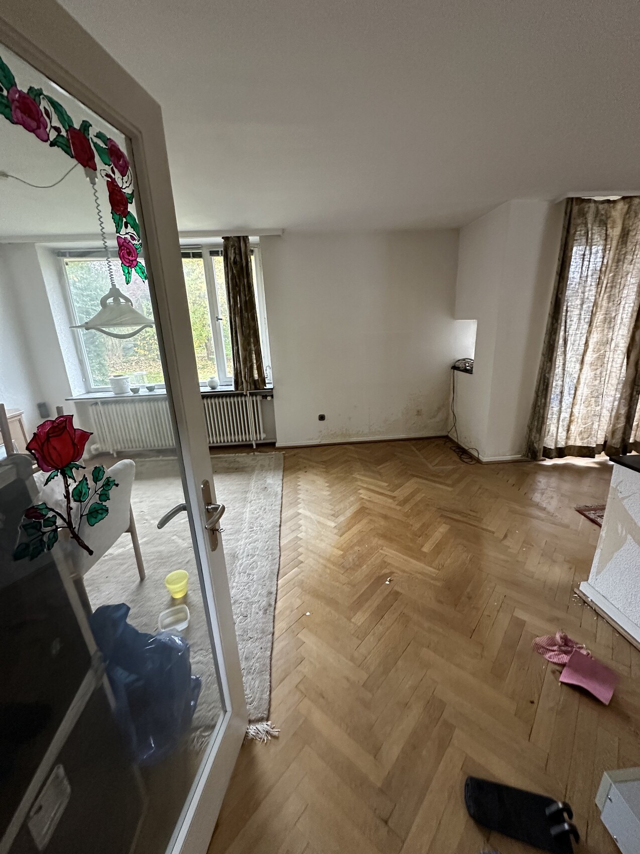

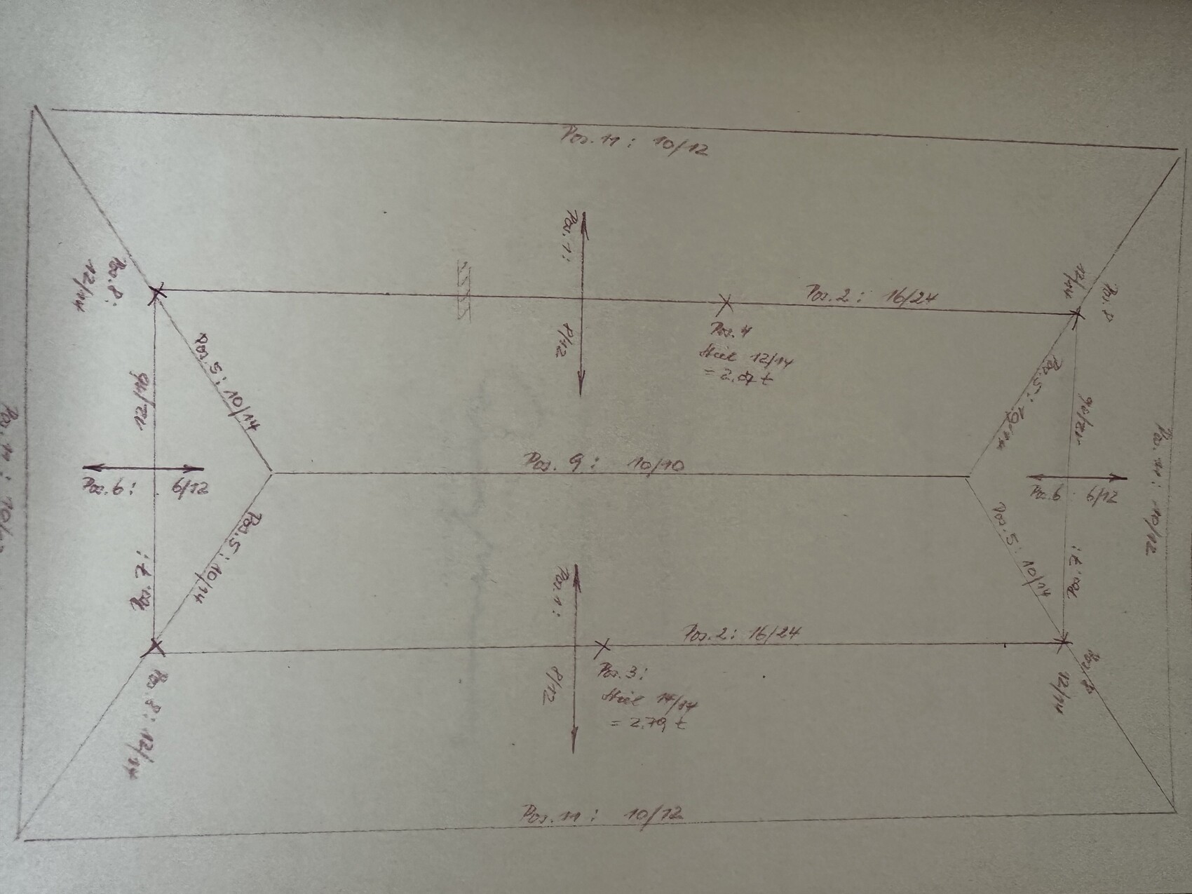

Bikerin9131 Oct 2024 12:49Hello,
here is an excerpt from the structural analysis. According to the structural engineer, the wall between the kitchen and the living room is load-bearing. But as I said, I’m not an expert (in picture number 1, the kitchen is shown).
I am also attaching photos of the current condition as well as pictures of the knee walls. These knee walls are present in every room on the upper floor. I would really like to remove them, but the question is whether they are also load-bearing. Do you need any more pictures or information?
Thank you very much in advance for your input.

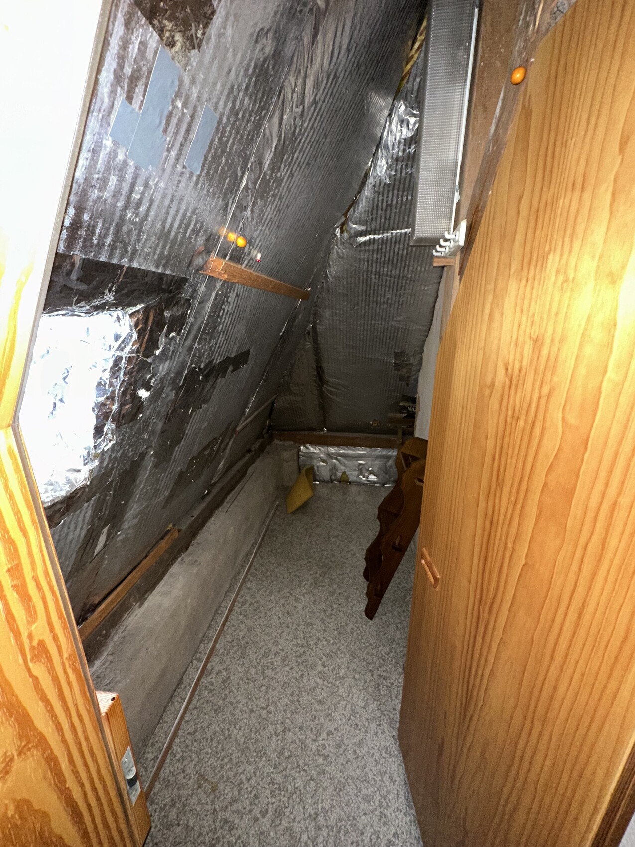

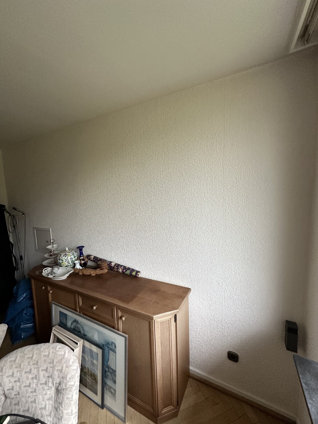

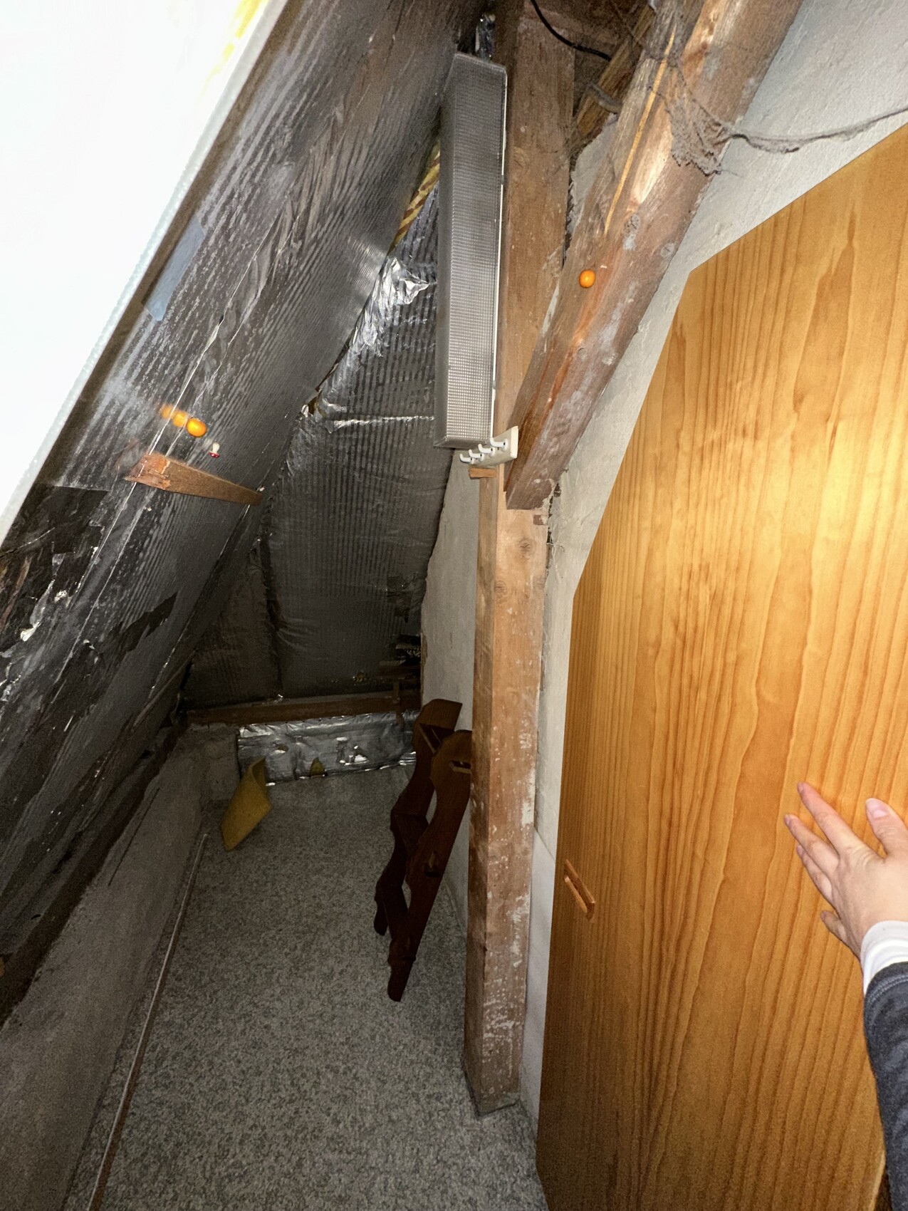

Regarding the knee walls, I have marked them on the first floor plan:
So, there are these knee walls in every room. The photo above is from room number 7 and shows a view turning to the right. My concern is to remove the wall on the left and also the one next to the window. You can see two photos of the knee wall adjacent to room number 7, and I would like to remove these two walls to gain more living space. These knee walls exist in every room upstairs. My idea is to install more windows to make the whole area brighter.
