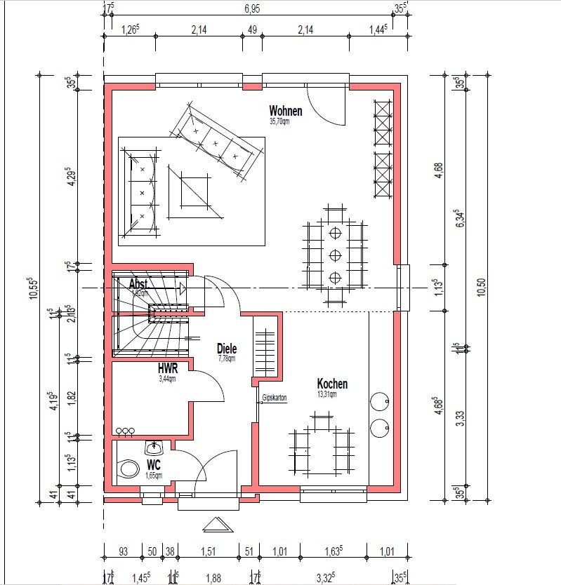

Is there actually a plan for the ground floor anywhere?
Not until now, because until recently I was only concerned with the compatibility of the shower and window.
I am now uploading the ground floor as well and preparing myself for the technical knockout.
And by the way, I have nothing to do with the furnishing. The house won’t actually be set up like that. 😀 Just accept it and don’t question why the furniture is arranged as it is.
Floor plan of a house with living room, kitchen, hallway, WC, utility room and staircase.

AxelH.13 Apr 2021 08:56
Hardi88 schrieb:
I’m now sharing the ground floor plan as well and bracing myself for the technical knockout.
I’m afraid that might actually happen... 😉
What immediately stands out is that the window issue continues on the ground floor—or rather, it starts on the ground floor and then becomes apparent upstairs.
And why is the direct access to the kitchen sealed off with drywall? Is carrying groceries over long distances part of the daily fitness routine? Especially if you also have to transport items stored on a small shelf in the utility room when you need them in the kitchen.
I think, seeing it like this, you can expect plenty of feedback from us...
Oh, and where is north on the plan? That could be helpful for the window and lighting design as well...

The current situation is catastrophic, and in my region, it is almost impossible to get any plots of land, which complicates things further and ties you to a general contractor. In my contract, I simply cannot move load-bearing walls as I please—load-bearing walls remain fixed.
AxelH. schrieb:
Oh yes, where is north actually indicated on the plan? That could also be helpful for window and lighting planning...
The living room side faces west. The side of the house with the window dilemma faces north.
I might contact someone privately to possibly avoid the worst. 😀 🙁
