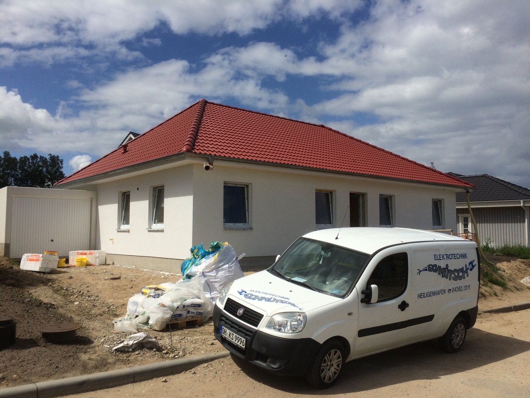

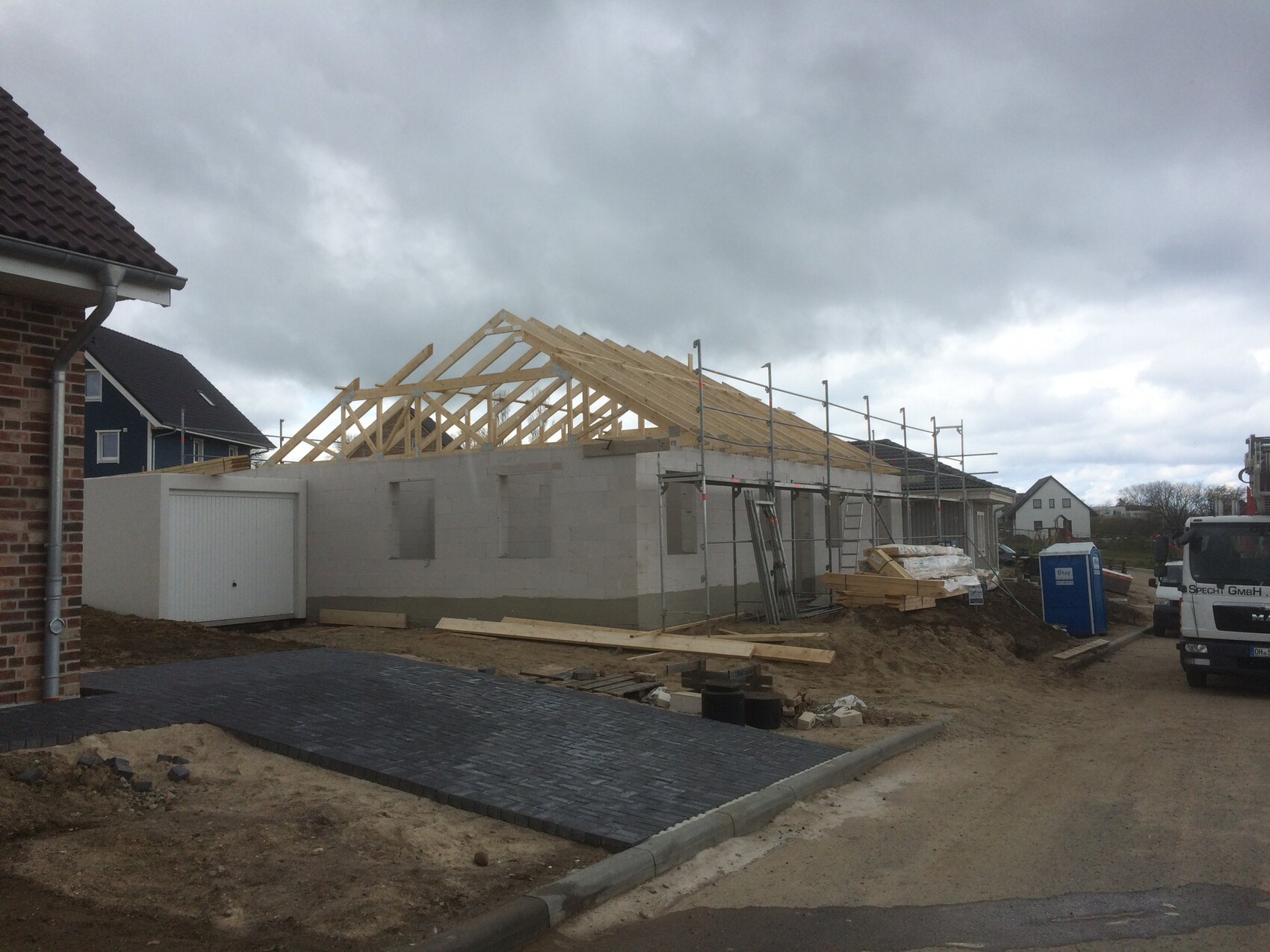

I find this all quite complicated. Why not put the prefabricated garage in place first? That way, there is space for the truck. Then Scanhaus Marlow would build the walls and roof. This is exactly how it was done for us. Now the house and Rekers prefabricated garage stand side by side, and the joints between them are sealed with MS polymer, with an angle bracket added on top. Karsten
