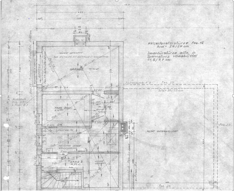

The basement is currently only about 200cm (79 inches) high, and we have a problem excavating below for our extension. I just had a detailed phone call with the architect about this, but the steps probably won’t help us anyway, and we will still need to underpin. Another issue with the basement is that we cannot or do not want to install a bathroom or toilet down there because we would then need a second sewage pump for wastewater from the basement, which is completely uneconomical. We already have one pump since the sewage connection is at street level. That’s why I am also hesitant to place the children’s rooms or the bedroom down there if there isn’t even a toilet.
Here is the floor plan of the “old” basement, which we have not yet redrawn with the extension added. We want to make the opening directly in the first window next to the stairs.
I think I just need to keep thinking about this. Many thanks for the great tips and ideas!!! But this is so far from our previous thoughts that I need some time to process it.

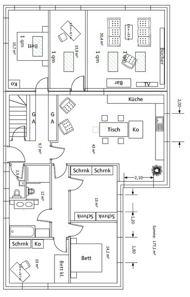

I haven’t posted for a while because we had to revise our plans. Unfortunately, we can’t build the extension at basement/souterrain level due to structural reasons, so we’re now going to extend on the ground floor instead. This way, all the living space will be on one level. Our current floor plan looks like this:
We initially plan to have one child’s bedroom, a master bedroom, a guest room, a walk-in closet, and an office. When we need a second child’s bedroom, the office will move into the walk-in closet, and the guest room will move to the current office space (or vice versa, we’ll see).
I’d appreciate your feedback!
Kerba
