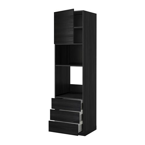

I have been quietly following for a while. I have now planned my kitchen and am almost finished, but I am having major headaches with my 220cm (87 inch) tall cabinet designed to hold a microwave and a built-in oven.
This is exactly the tall cabinet I am using:
Metod / Förvara
Tall cabinet for oven/microwave with door/3 drawers, black, Tingsryd black
I have a built-in oven that is 59cm (23 inches) high.
The problem is that if I install the oven shelf at the height it is intended, the drawer below will not close because it hits the bottom of the oven. If I raise the oven shelf by one level, there is a gap between the drawer and the oven.
I need to install a panel, which according to IKEA is placed between the oven and the microwave (the microwave is IKEA HUSHALLA, 35cm (14 inches) high)....
I am a bit desperate and hope you can help me.

IKEA-Experte16 Oct 2014 23:32Hello, since you didn’t specify a model, I assume the oven is not a new one from IKEA, so it doesn’t come with an installation manual for METOD. Have a look and see if the instructions help:
https://www.ikea.com/de/de/assembly_instructions/granslos-backofen__AA-718065-2.pdf

IKEA-Experte18 Oct 2014 11:32It already looks quite good. When installing the microwave, at least you don’t have to adjust a trim piece, as was necessary with Faktum.
