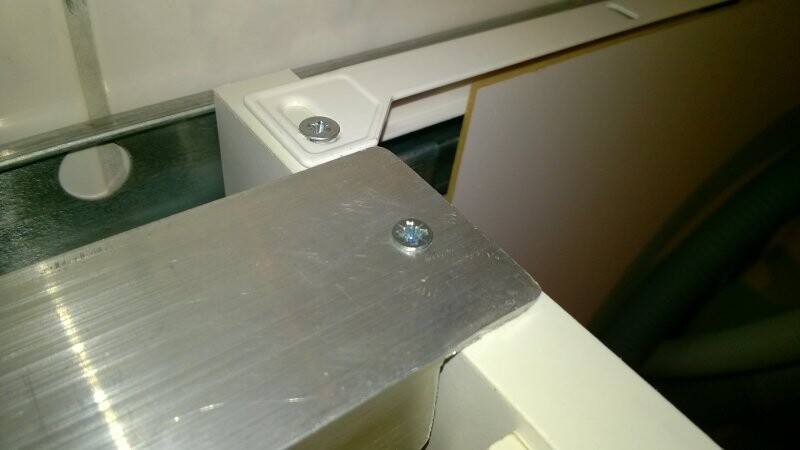

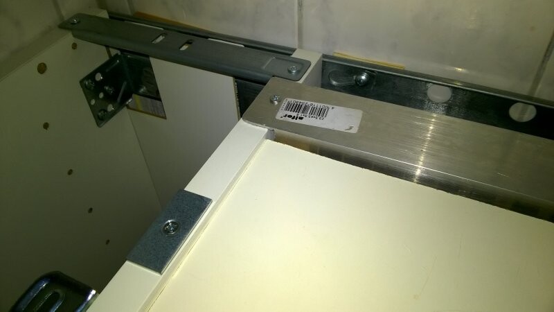

About "rotating" the side panels: what I meant is that if someone needs two cabinets with 40cm (16 inches) high side panels, they might only need one 80cm (31 inches) high carcass and can then cut the side panels into two pieces, using the cut-off sections "upside down." This way, you get 4 instead of 2 side panels (only for base cabinets) because the row of holes is equally spaced from the top and bottom edges of the side panel. For the two pseudo side panels per 40cm (16 inches) wide drawer in my picture above—so 4 in total—I only had to get one 40cm (16 inches) wide carcass.
Update: for the rails, simply buy an aluminum U-profile at the hardware store if you can’t find anything suitable in the clearance section. Then cut two recesses and drill holes yourself. It’s easy to do and very sturdy.
