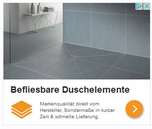

Funny that this advertisement appears in this thread:
Gray bathroom tiles on wall and floor with visible floor drain in shower
11ant5 May 2017 18:04
Hendrik007 schrieb:
Funny that this ad appears in this thread:
The picture clearly shows an elegant solution for the problem caused by the slope creating "acute angles" at the joint points of the tiles for the four funnel segments: simply cut the tiles again.
