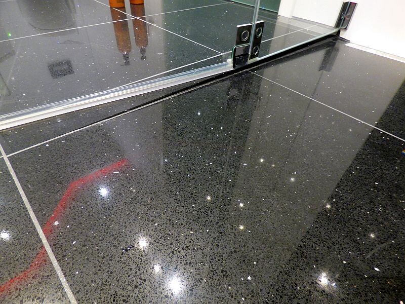

Unless you specifically need to build for accessibility, a narrow shower tray and peace of mind for decades is the better choice....it is easier for the builder to install a shower tray. The waterproofing is mainly done UNDER the tiles. The drain and slope are naturally additional challenges, as they require much more consideration during the screed stage. The tray is simpler in this regard.
There are also different techniques for the slope: either many cuts in the tile design, a tile mesh (mosaic), or a smooth, uniform tiling.
It depends on where the drain is placed / can be placed (center or against the wall), or possibly a large granite slab...
Depending on the skills of the tiler / builder, they will recommend what they are most experienced with and possibly speak negatively about other options!
Furthermore, it is a question of budget, taste, bathroom size, and overall bathroom design.
Attached is a photo showing how the slope can also be solved (drain against the wall with a linear shower drain).

this certainly has to be considered depending on the region; the photo was taken after one year of use.
