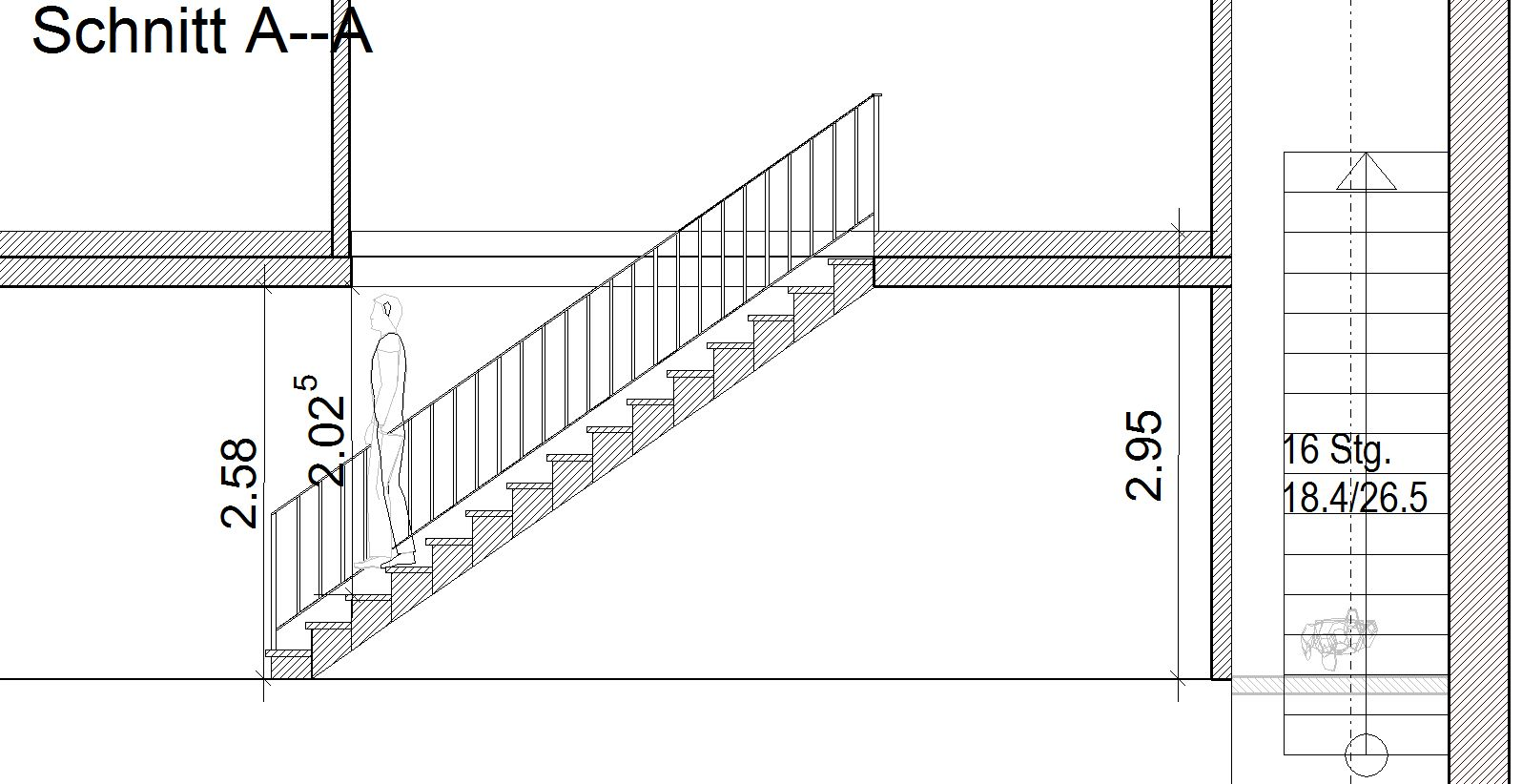

phibe100524 Mar 2026 20:14This is a planned terraced house. The attic will initially remain unfinished. Our primary preference was a concrete staircase from the first floor to the attic. Due to the height situation, two dormer windows are necessary. We do not like their appearance, and overall the costs are quite high. We are currently considering a space-saving staircase. However, we have difficulty imagining where to place the space-saving staircase—either in the hallway or in one of the children’s rooms, which would then become an office. For child number two, we would then partially or fully finish the attic space above.

When going up, you might still have about 185 cm (6 ft 1 in) of headroom, but consider what happens when going down. Here is an example of a staircase that has 202 cm (6 ft 7.5 in) of headroom at one point, with a person who is 185 cm (6 ft 1 in) tall. Without a dormer, this simply won’t work properly.

I would rather use the existing stair well. You can move the actual staircase about 20–30 cm (8–12 inches) into the room and use the space created either as a cable duct or install a shelf. For this, the first floor plan would need slight revisions. The ground floor plan is unknown to us.
Then choose stairs that are somewhat less comfortable in dimensions, to get about 185 cm (73 inches) of standing height at the top. A roof window positioned at the stair exit would gain about another 20 cm (8 inches) in height. I consider the dormer on the other side unnecessary. I think this is acceptable if the attic is not frequently used by adults who would mind having to be careful on the stairs.
