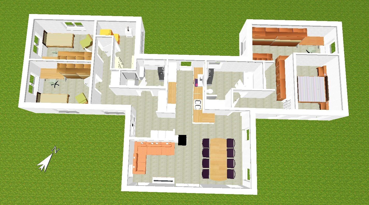

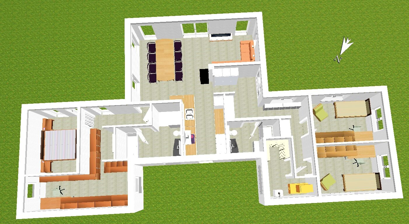

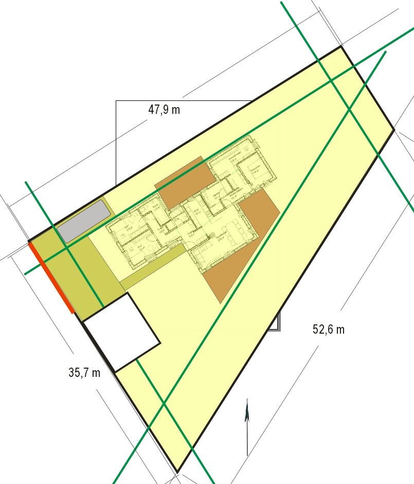

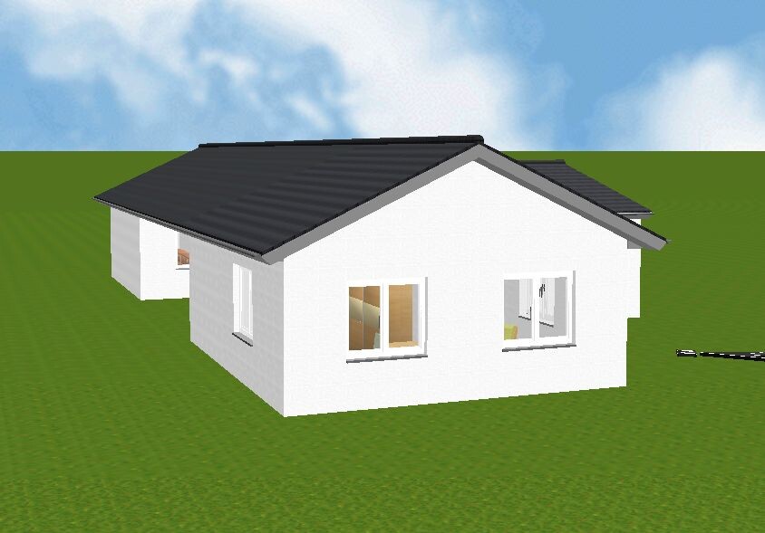

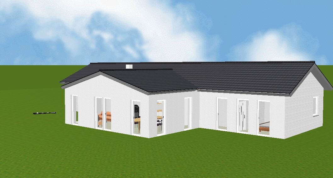

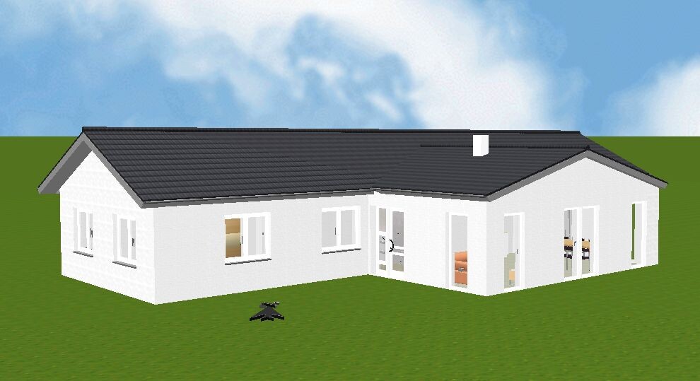

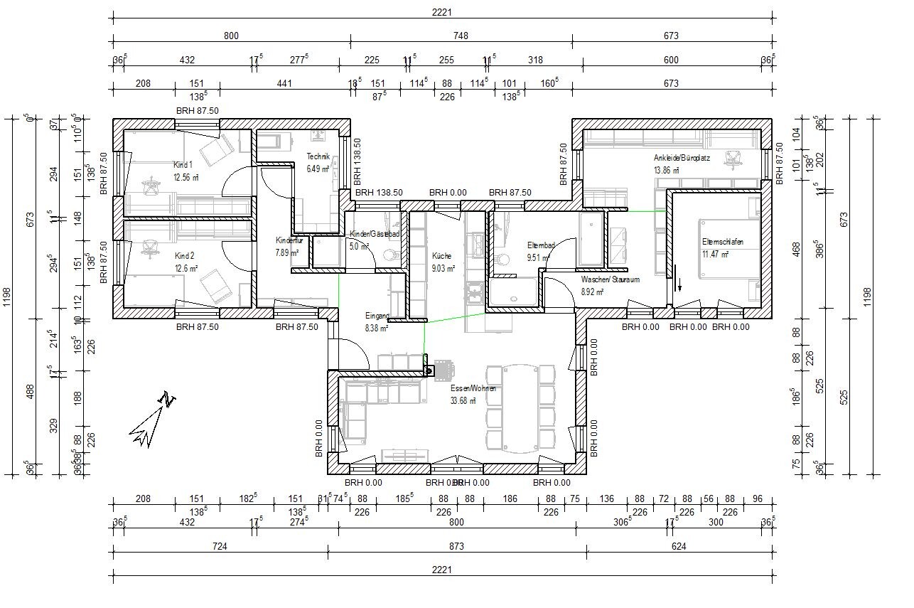

I have developed the earlier sketch into a more individual design. By the way, I never considered the hipped roof shown there. The initial floor plan was mainly about the basic concept.
The gable roof has now been extended, and above the open living area, a gable roof is practically added as well. One could also consider leaving out the intermediate ceiling there.
Children’s rooms are located in the southwest, parents’ rooms in the northeast. The office is just a corner in the parents’ area. The laundry machines are also in the parents’ area. The technical room is mainly for some storage, since there is quite a lot of storage space available in many places. For example, in the children’s hallway, there could be a cupboard for the vacuum cleaner, bedding, and towels.
In the hallway of the children’s area, shoe cabinets could be placed; the entrance area offers enough space to accommodate a guest wardrobe and seasonal jackets with accessories for a family of four.
The northwest terrace is fully covered and has direct access from the kitchen. It is an ideal place for grilling on summer evenings.
The dining area is now marked with a dining table measuring 120 x 300 cm (47 x 118 inches). The sofa corner is almost 300 cm (118 inches) wide.
Green areas indicate the driveway with a caravan parking space plus house access. Brown areas are mainly terraces.
Grundriss eines Hauses: Küche, Ess/Wohnbereich, Eltern- und Kinderzimmer, Bad, Waschküche, Flure.
