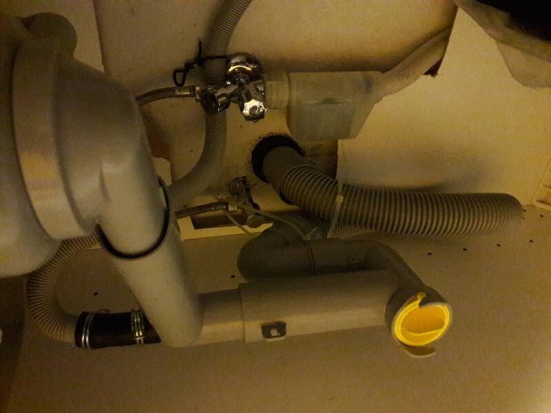

HansHubert4 Jan 2017 20:47Hello,
I have finally managed to install the overflow. However, I occasionally—and just now again—have the following issue: the water either doesn’t drain or drains very slowly, it bubbles and gurgles as if air is being sucked in. After filling the entire basin and then draining the water all at once, the drain works well, and sometimes it continues to work fine for a while afterward. Does anyone have any idea what might be causing this? Did I do something wrong? Earlier, when the dishwasher drained, the water rose up in the sink. Could it be that something is wrong with the trap or perhaps further along the drain pipe?
Here is a photo of the trap:
