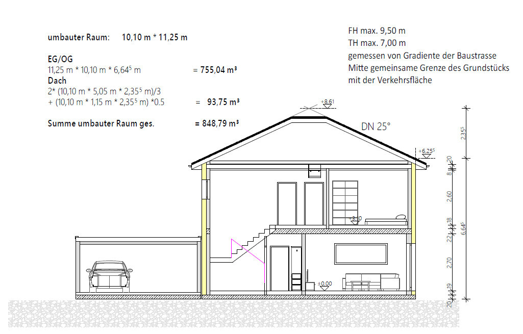

hanghaus2023
2 Mar 2023 21:02
The two steps above the door are meant seriously. In my opinion, it looks really bad.

dimba234
5 Mar 2023 00:23
hausbauer_93 schrieb:
Would it be possible to move the stair landing 50cm (20 inches) to the right here?
Moving the stairs is a good idea, but I feel it would mess up the entire floor plan — especially upstairs, where it would no longer work properly (space for the bathtub, children’s room door...).
One idea would be to leave the staircase open at the entrance area downstairs. That way, at least you’d have some space underneath for shoes. But I’m afraid it wouldn’t look good. Otherwise, the hallway is wide enough. So there could just be a wardrobe on the wall between the guest toilet and the office. Not perfect, but that’s how it currently looks in our apartment.
hanghaus2023 schrieb:
The two steps over the door — is that serious? In my opinion, it looks really bad.
This small slope doesn’t bother us, see the section drawing.
In practice, it comes down to a daily passage about one meter (3.3 feet) wide, which is more comfortable with a swinging door than dragging something heavy through. I often even see folding sliding doors combined with an outward-opening hinged door before them.
I’m asking about the folding sliding door and will also hear the architect’s opinion on it. Maybe I’ll be convinced after all.
First of all, the floor plan has been adjusted for the lift-and-slide door. Now it also makes sense to swap the sofa and TV/lowboard. That way you can comfortably look out into the garden from the sofa.
Cross-section of a two-story single-family house with garage on the left, stairs, living and sleeping area.
