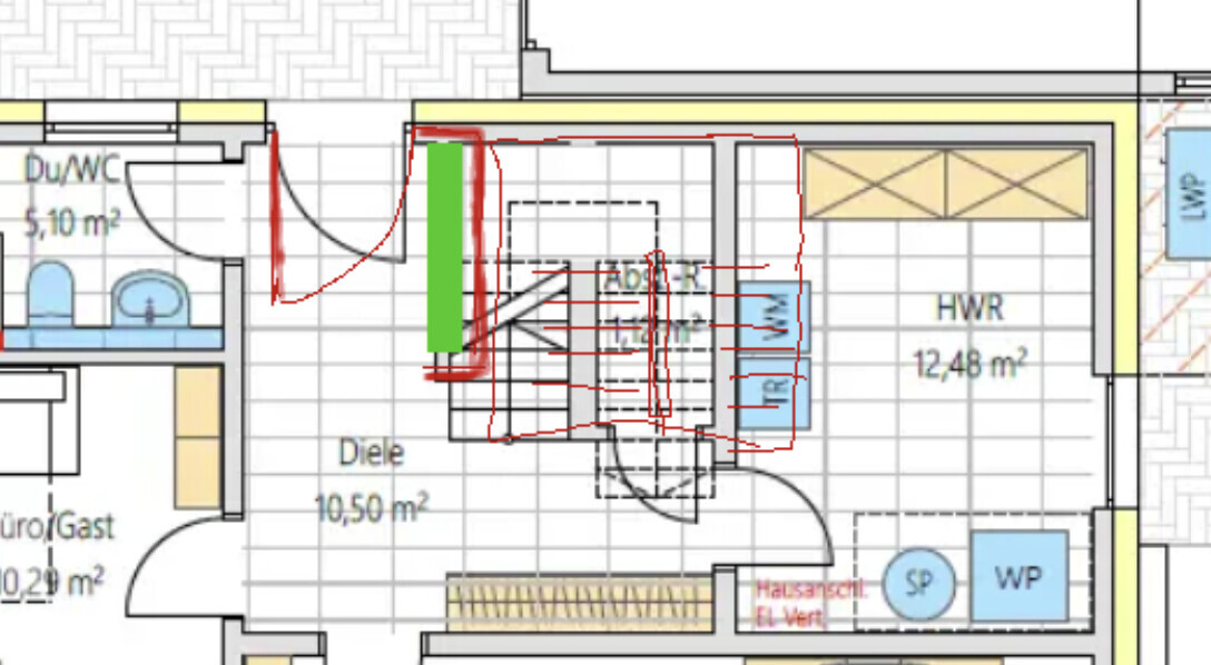

hausbauer_932 Mar 2023 20:51dimba234 schrieb:
In front of the staircase as shown in the floor plan. Not ideal, as it is a bit far from the front door. But there is enough space for a large wardrobe. Okay, that is really not ideal, and you probably don’t want everyone walking through your hallway with their shoes on, tracking dirt inside. In the end, you will probably leave the shoes somewhere near E1. The wardrobe location is not optimal at either E1 or E2. Overall, I actually prefer E2!
Could the landing stairs be shifted about 50cm (20 inches) to the right? This would make the utility room and the bathroom upstairs smaller, but you could then have a nice, spacious wardrobe (highlighted in light green) right in front of the landing stairs and immediately by the entrance. I quickly drew this up:
