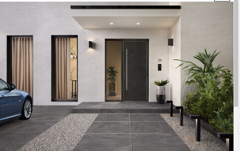

Not ideal, but I can’t think of another solution for a side entrance right now. You could give the entrance door on the ground floor a recessed area as a landing, starting right at the front corner of the house. That would also add a modern touch to the cube design and provide a canopy.

I’m a bit lost right now.In my post, I attached the picture with the rotated upper floor plan.ypg schrieb:
You could give the front door on the ground floor a recessed entrance area that starts right at the front corner of the house. This would add a modern touch to the cube-shaped building and provide a covered area. I can’t quite picture that at the moment. Something like in my picture—from the corner all the way to the garage? Or do you have a specific example?
