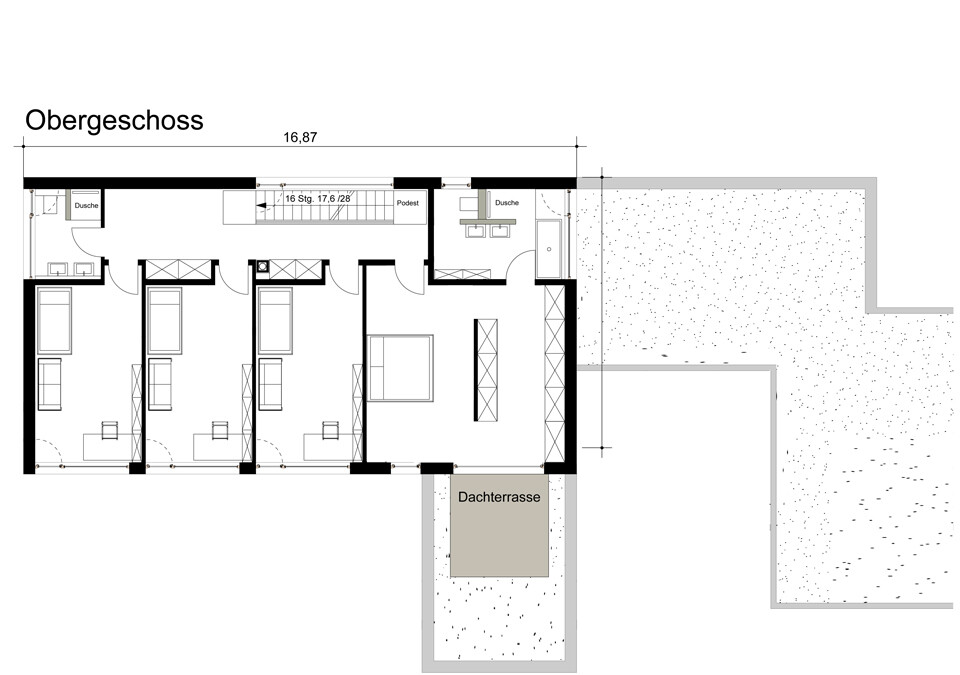

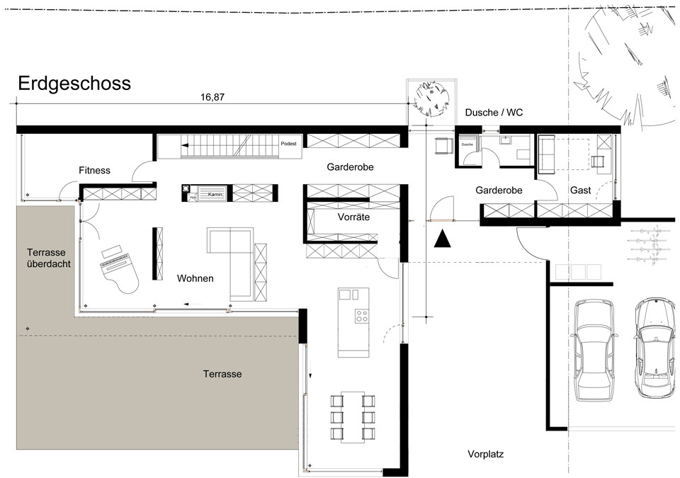

Attached are the revised plans for the ground floor and upper floor.
We tried to improve the entrance area to make it more inviting. We moved the bike and trash room behind the garage, creating a wide entrance that could also serve as a parking space for a third car if needed.
The front door was extended with an additional glass element—at the expense of a wardrobe cabinet.
In the hallway on the left, the walls next to the staircase were shortened to make the space feel more open and wider.
The kitchen unit at the back is 4.20 m (13 feet 9 inches) wide, and on the right side there is supposed to be a “hidden” door to the pantry (I can’t quite remember the exact term for this type of door).
We took some space from the fitness room to add a bit of storage—or should I say “dust room”—in the living room.
In addition, the ceiling on the ground floor was extended by 0.60 m (2 feet) towards the terrace. This provides more shade in summer when the sun is high, and it also allows the children's rooms to be enlarged back to their originally planned size while keeping the built-in wardrobes in the hallway.
We also redesigned the walk-in closet and the bedroom.
I know not everyone likes having access to the large bathroom through the bedroom. But typically, no one sleeps in the bedroom when we bathe the children. Also, the kids are growing up and may well bathe themselves and go through the bedroom if needed.
The furniture shown, like cabinets and so on, is only symbolic for now and not intended as the final arrangement.
What do you think?

17 Sep 2014 23:57
Did you miss something?
You still have to go through the terrible cloakroom airlock… just to be able to take a break with the shopping bags at about 330 degrees (from the entrance).
To make it clear: you first walk in a circle to get to the kitchen, the center of activity.
There is still no space for the coffee machine and opened beverage bottles.
The children’s rooms are more corridor-like, and they still have to collect their belongings from the hallway. At 16, they come home from the club around midnight and first walk past their sleeping parents on their way to the bathroom 😀
On the plus side, there is plenty of storage space (built-in closets) for secret visitors who have to wait until the airlock toward the exit is clear 😉
Manu1976
17 Sep 2014 23:58
Ah, yes.
I like the bedroom situation much better now than before.
I also think it’s good that there is more space in front of the house.
BUT! You can make your entrance area entirely out of glass, but it won’t help you at all in the airlock area of the cloakroom. Light doesn’t tend to bend around corners, especially not at 90 degrees. With glass at the entrance, you will only illuminate about the front third of the cloakroom, no matter how much glass you add there. To have enough natural light in the cloakroom during the day without artificial lighting, you need to install a window. My suggestion would be to have your beloved built-in wardrobes on one side and lower cabinets with a narrow, raised light strip on the other side. This way, you still have enough storage but also get some natural light.
Another suggestion is to move the glass element at the back of the entrance area toward the cloakroom and divide the cloakroom: two cabinets on the right, one cabinet on the left of the glass element. This would give you 1. light and 2. much more of that nice glass feature, which you would then see not only when you go to the toilet or enter the front door but also from the living room area.
In the living area, you’ve only created space for cabinets. This might make sense in the kitchen, but where the piano is, having more space doesn’t help you – except for more storage.
Somehow I get the feeling you live in a closet. Your whole house seems to consist only of cabinets and storage. That’s a pity, really a pity. You could get so much more out of this house if you could just do without all these (built-in) cabinets.
18 Sep 2014 00:05
Manu1976 schrieb:
... You could get so much more out of this house if you just did without all those built-in cabinets.
No! A few built-in cabinets are really nice. I think planned shelves next to a fireplace are truly commendable, I also like built-in cabinets in a hallway as a coat closet, and doors disguised as built-in cabinets (like here in the kitchen for pantry storage) are awesome! <3
But it has to fit – and here they’re installed poorly! The house is compromised by too many built-in cabinets!
Built-in cabinets support minimalism, but here it borders on starkness and – to provoke a bit – hoarding syndrome 😀
