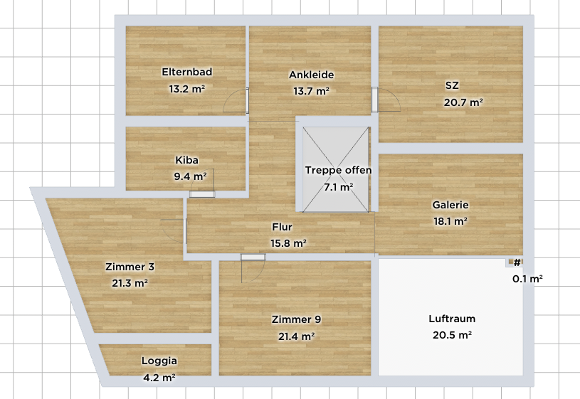

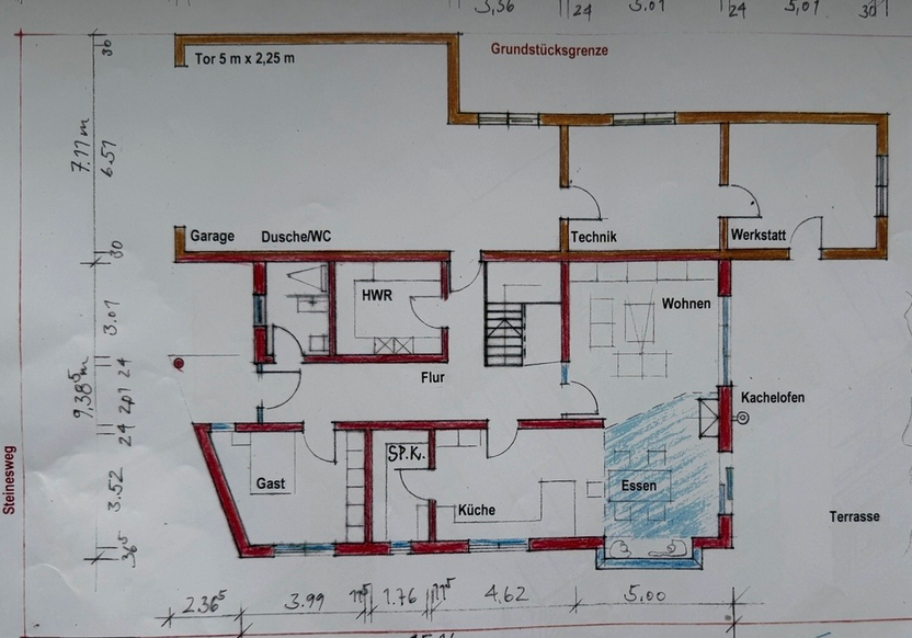

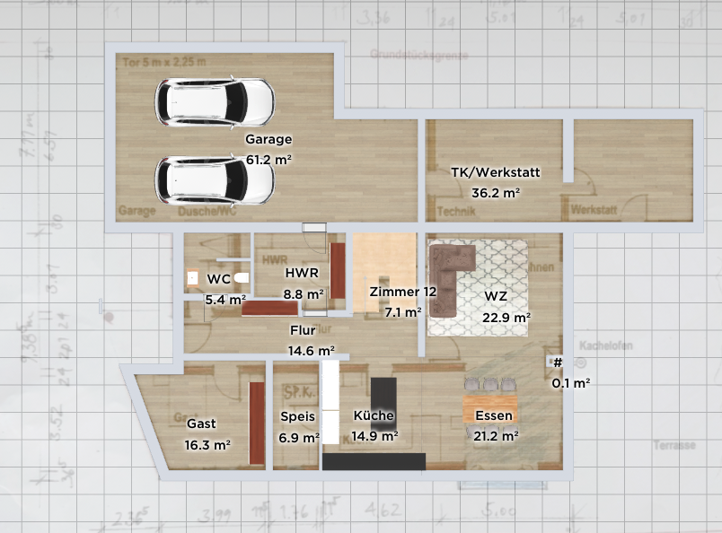

we are planning a custom-designed house and are very satisfied with this floor plan at first and second glance. Our wish was to have a large garage, and the house has now been adapted accordingly. We have a relatively narrow plot of land, measuring 18m (59 feet).
Planned changes still include:
We would be interested in your opinions.
Thanks in advance
- Utility room as a walkthrough from the garage
- Reducing the size of the technical room and thereby enlarging the living room
- Layout of the master bathroom/dressing room/bedroom is not yet finalized
- The front slant will cause problems when placing a bed
Thanks in advance

Since there apparently are no financial constraints, but mostly external knowledge is being relied upon, here is a revised draft, patched up a bit to make the design flow more smoothly and to allow the bathroom and kitchen to be furnished. The kitchen wall was extended from 3.50 meters (11.5 feet) to 4 meters (13 feet).

The layout had to be angled to plan the rooms as they currently are. Well, if the information were complete — for example, a site plan of the plot with measurements — then it would be easier to evaluate everything. Although it’s unclear why so many angled corners need to be added just to plan the desired room arrangement.

The wardrobe will also be planned. The hallway should probably be wide enough for that.
The unnecessary hallway will be removed, and the utility room will then serve as a passage from the garage.
The walk-in closet could also become the bathroom, and a door will still be planned there.
The exact room layout is not yet finalized. All three points are essentials in floor plan design and often cannot be integrated effectively or sensibly by just shifting things around a bit. Toilets and similar require wastewater drainage, typically pipes with a diameter of 10cm (4 inches). You also don’t want them to negatively affect the room below.
bluetoothtony schrieb:
The gallery is planned as a cozy seating area or a home office workspace. We like the open concept very much. If it becomes a problem later, it can still be changed. A cozy seating area combined with an open space below — where the kitchen, dining, and living areas will at least acoustically overlap with the seating nook — doesn’t really mesh well. Even less does a home office workspace fit into this concept, especially if it’s intended for remote work. Consider phone conferences, undisturbed work, and so on.

We are still going to a well-known kitchen studio with the floor plan. The kitchen will be planned there before the floor plan is finalized. Yes, you should remain flexible with the room layout and already have your kitchen preferences clear. Not every room allows for an island, desired workflow, special cooking or baking needs, etc.
Overall, I find this floor plan to be large but not generous, since a lot of space is assigned to hallways and so on. A huge utility room, technical room, and pantry — it somehow lacks a coherent concept. In my opinion, there are also too many floor-to-ceiling windows planned in the children’s rooms, at least according to the elevation.
The styling also seems quite mixed. Slanted walls, roof slopes, flat roof sections all rather chaotic — generally, I’m somewhat “old-fashioned,” but I can recognize well-designed modern houses as “good,” not as “chaotic” 😉.
