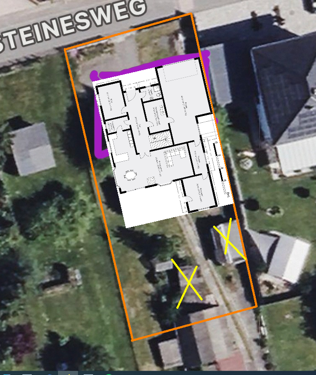

bluetoothtony schrieb:
bluetoothtony
The purple marking is supposed to represent the house I’ve fitted the ground floor plan (release post #42) into the purple marking. This calculation works if the plot is roughly 20.0 to 20.2 meters (65.6 to 66.3 feet) wide:
