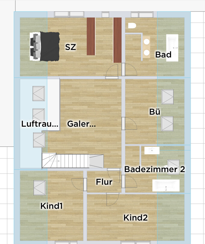

kati13371 Nov 2022 23:57
Grrr… revised again… this is how I could spend the Advent season 😉
[ATTACH alt="neubau-efh-begleitet-uns-dabei-603361-1.jpeg"]75939[/ATTACH]
Furnishing Child 1’s room will be quite a challenge, won’t it? At least a taller wardrobe will be tight in that space.
2 Nov 2022 00:34
kati1337 schrieb:
That space will be difficult to furnish for Child 1, right? At least a taller wardrobe will be tight there.
I don’t think so. The ceiling height is 2.50m (8.2 ft), and with nearly 19 square meters (204 sq ft), there are options. But yes, the walls still need to be finalized. At the moment, it looks tighter than it actually will be. The real challenge is coordinating the bathroom, pantry, and stairs with the entrance area; everything else will fall into place… and we still have two months to finalize everything 😉
Ysop***
2 Nov 2022 05:25
Hmm, what bothers me downstairs is that the dining room is planned rather far from the kitchen, while the living room is located directly next to the kitchen. For me, the kitchen and dining area belong together, with the living room ideally somewhat separated.
Upstairs, there is a lot of hallway space, or actually two hallways, although the second one takes up less space in the end. However, I can no longer recall the discussion about why this has to be.
Myrna_Loy
2 Nov 2022 07:03
Grrr… revised again… this is how I might spend the Advent season 😉
This clearly shows why I don’t like the design at all. There is a lot of space, but it’s neither used efficiently nor does it feel luxurious. Except for the gallery, whose usefulness I question given the amount of living space on the ground floor. The gallery takes up so much space that the adjacent rooms barely go beyond a classic one-and-a-half-story single-family house with a standard budget and awkward roof slopes. For this budget, I would expect more, especially on the upper floor. For example, a proper walk-in dressing room instead of just rows of built-in wardrobes.
If I understand the plan correctly: 180 sqm (1,937 sq ft) of floor area and a bedroom of just under 17 sqm (183 sq ft) do not match in my opinion.
Myrna_Loy
2 Nov 2022 07:22
Would it be an option to build the secondary apartment over two floors? This way, you narrow the floor plan on the ground level to the width of a townhouse, resulting in railroad apartment layouts for both units. I would suggest trying a design where the secondary apartment has the kitchen and living area on the lower floor and the bedrooms and bathroom upstairs. Think of it as an inserted cube within the main house, so that its basic shape resembles more of an L.
kbt09
2 Nov 2022 07:34
I would probably avoid doing that. It requires an additional staircase, and the apartment is initially intended for longer visits from parents/in-laws. There could also be issues with the stairs in such cases.
There are still 670 cm (264 inches) of width available for the main living/dining/kitchen area. No technical equipment, wardrobe, or similar needs to be accommodated there. Looking at my own dining/kitchen area, which measures 7 x 4.10 m (23 x 13.5 feet), I consider 670 cm (264 inches) of width to be quite generous.
