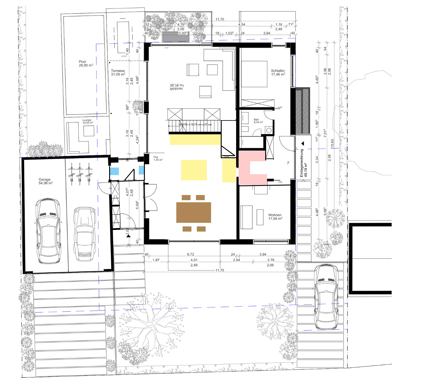

K a t j a1 Nov 2022 18:00
And what if the toilet ends up at the far end of the entrance? I would find it very uncomfortable to use the WC right in the middle of the living area, especially as a guest.
Grundriss eines Einfamilienhauses mit Garage, Pool, Terrasse, Wohn-/Essbereich, Bad und Schlafzimmer.
1 Nov 2022 18:48
K a t j a schrieb:
And what if the toilet is placed at the far end of the entrance? I would find it very uncomfortable to use the throne right in the middle of the living area, especially as a guest.
[ATTACH alt="neubau-efh-begleitet-uns-dabei-603317-1.jpg"]75929[/ATTACH]
Oops, you forgot the basement 😉
K a t j a1 Nov 2022 18:57
Oops, yes, that slipped my mind. So the pantry will have to be removed again.
Sorry, it stays that way. I really find the project interesting, but I can hardly warm up to the design. Let’s see how it develops.

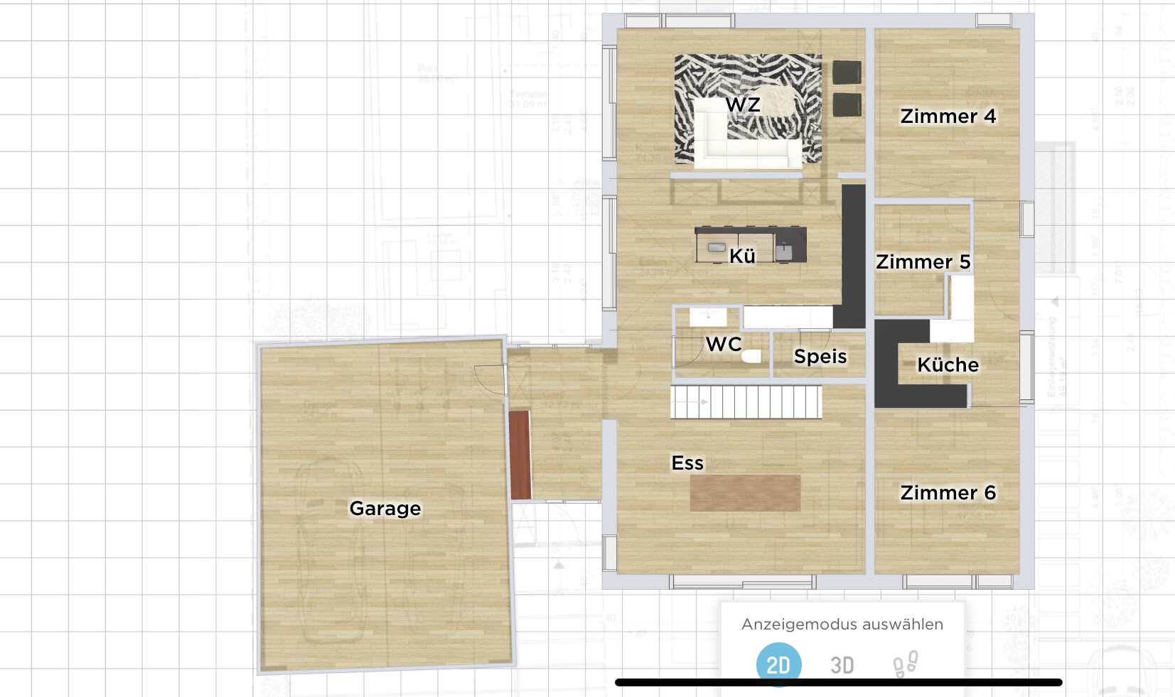

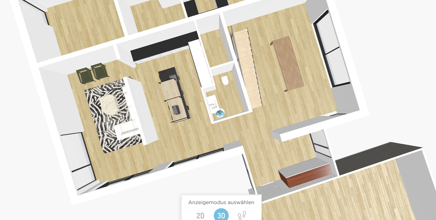

1 Nov 2022 21:46
Sooo… I also have some time while watching football on TV 😉
Floor plan: left side bedroom, open space, gallery, hallway; right side master bathroom, office, bathroom, 2 children’s rooms
Floor plan: garage on the left, dining room, living room, kitchen, pantry, toilet, rooms 4–6.
3D floor plan of a modern apartment with living room, kitchen, bathroom and dining area.

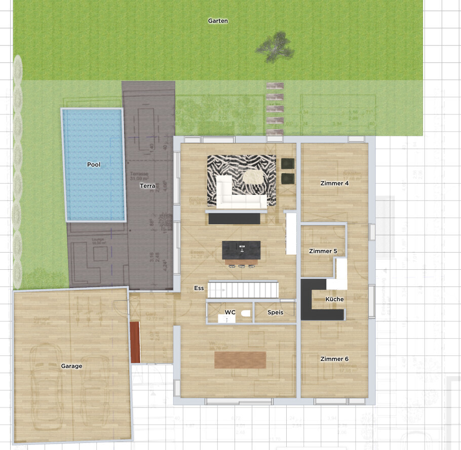

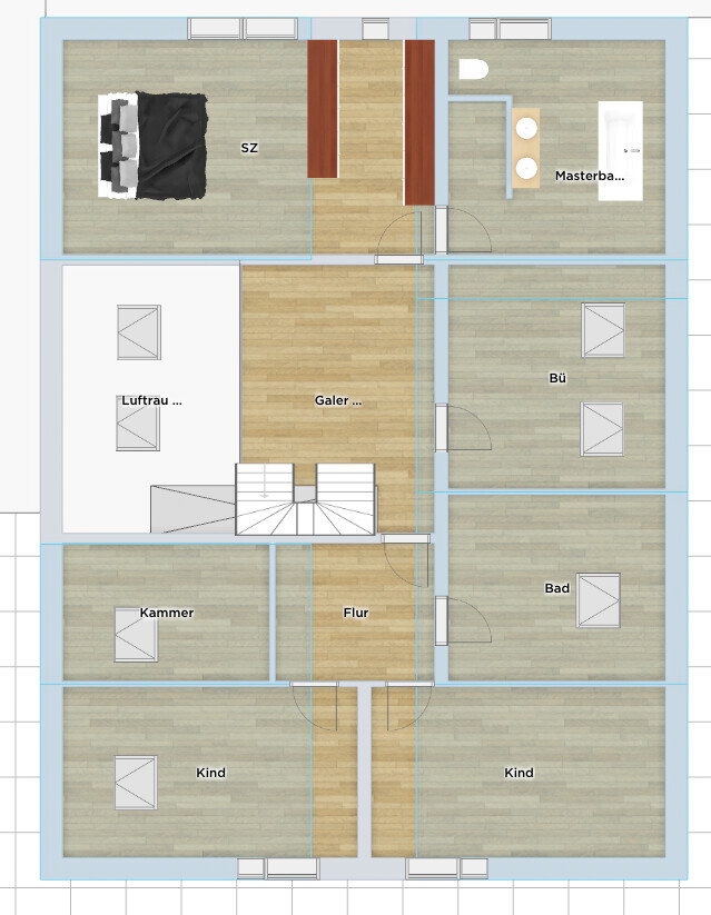

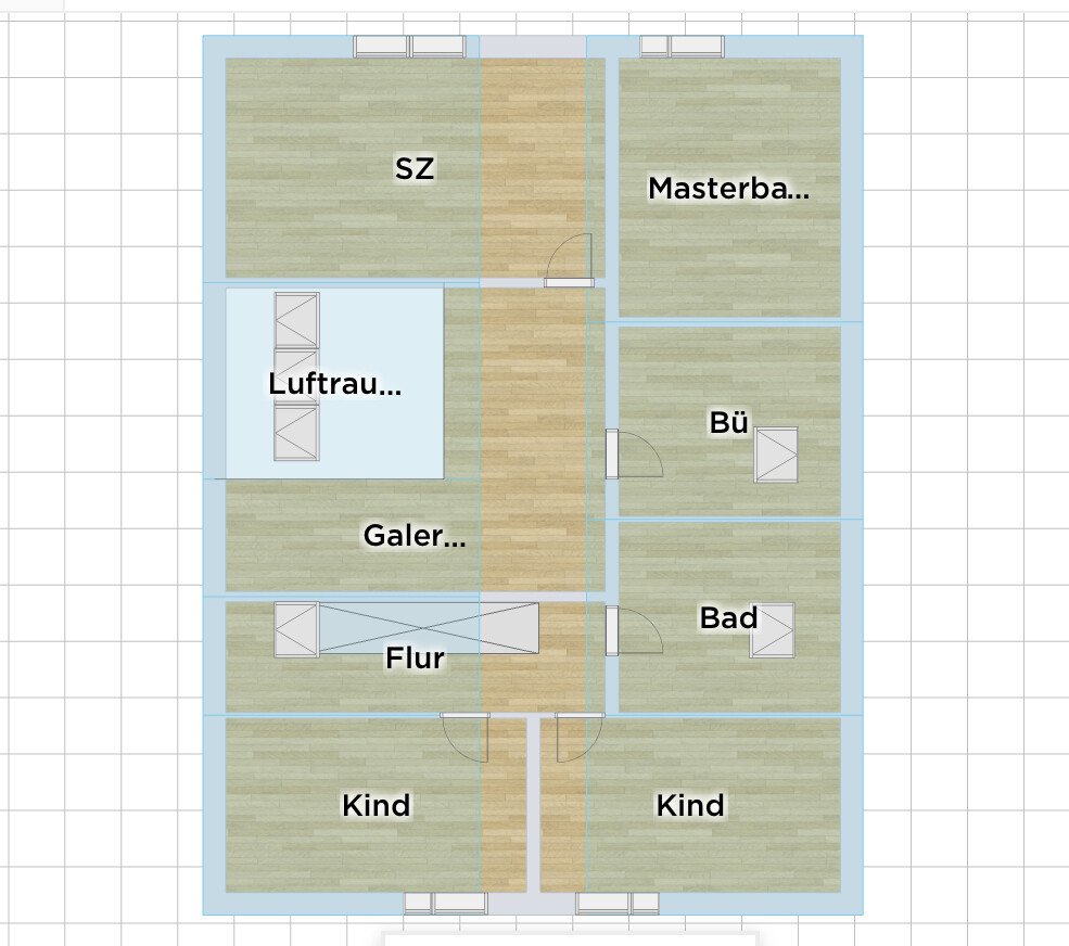

1 Nov 2022 22:44
And now a slightly improved version upstairs with the staircase... of course, the lower floor is different as well...
Floor plan of a house with garden, pool, terrace, living room, dining area, kitchen, and rooms 4–6.
Floor plan of an upper floor: bedrooms, master bathroom, office, bathroom, hallway, gallery, children’s room.

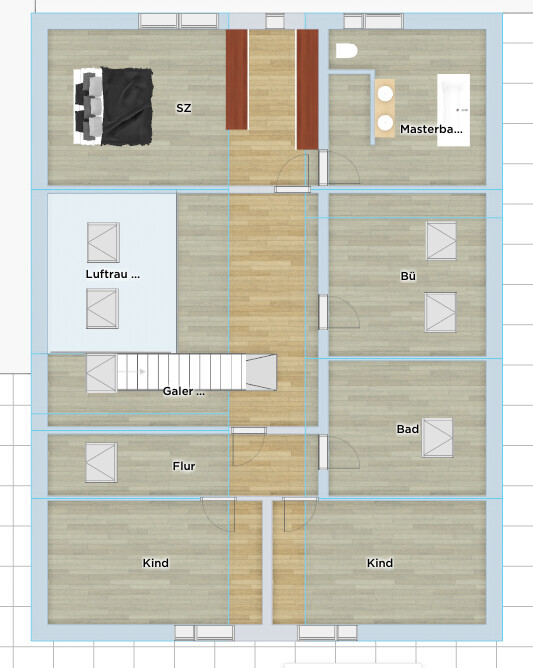

The upper floor could also be designed like this
Floor plan of a residential building: bedroom, master bathroom, office, gallery, hallway, 2 children’s rooms, storage room.

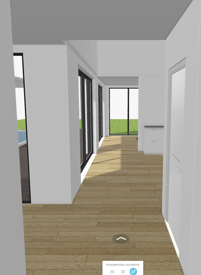

And this would be the line of sight from the dining area toward the living room
Bright modern hallway with wooden flooring and large windows; view outside to the garden.
