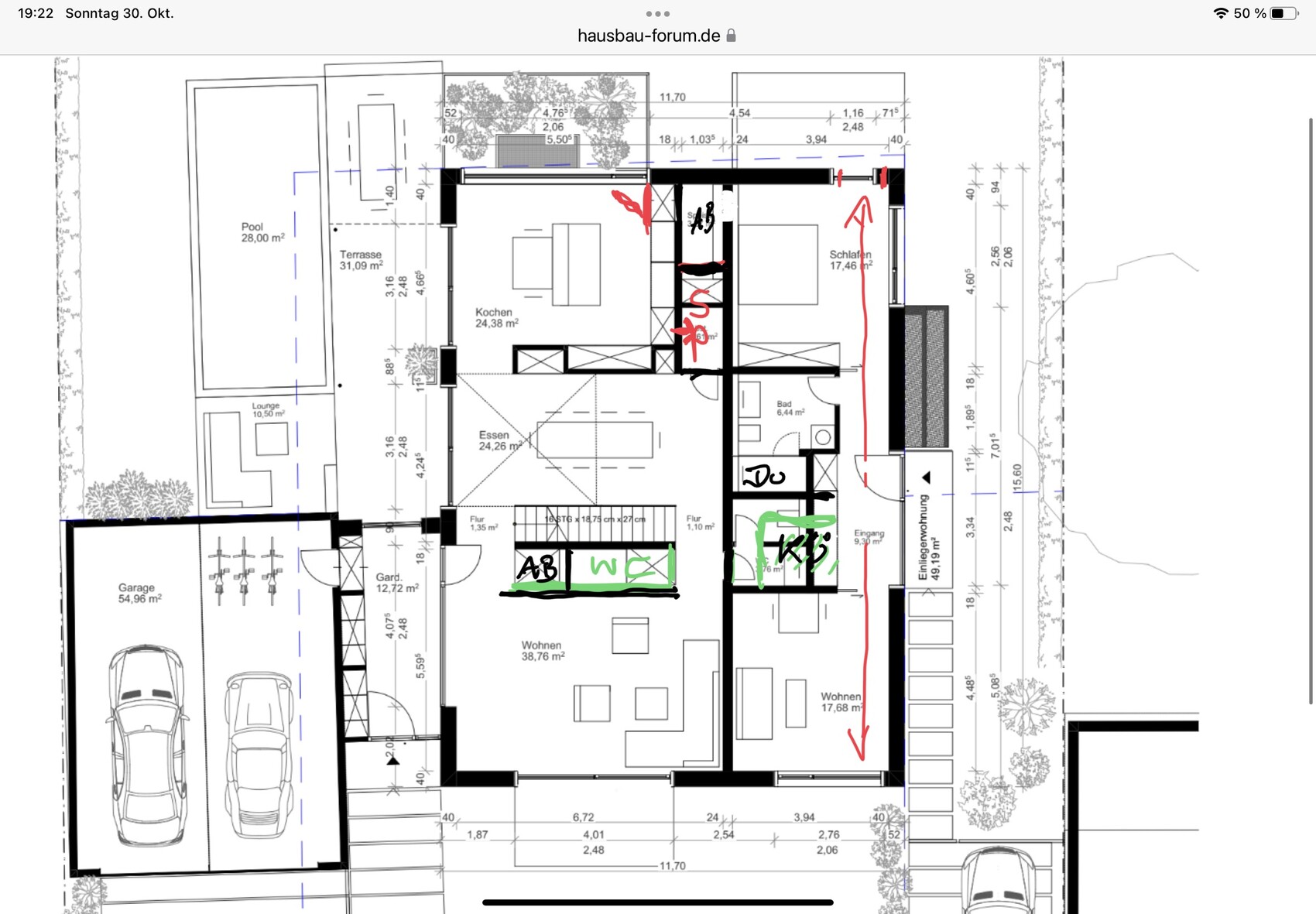

30 Oct 2022 21:27
gregman22 schrieb:
Works on its own -> I’m not sure if you meant that positively.
Yes, I like it. They are smaller than a main apartment, usually around 40sqm (430 sq ft) or similar to this. If the guest toilet could be moved elsewhere for you, it would still be nicer for the kitchen… Were you planning the secondary apartment without a shower? That would actually be a no-go — a living unit without washing facilities… that would be similar to post-war housing…
gregman22 schrieb:
Where would you place that? The light shaft to the basement is centered in front of the window.
To the right on the plan, near the pantry.
I have made some small changes that might be worth considering 😉
Floor plan of a house with kitchen, dining, living, bedroom, bathroom, garage, and pool.
gregman22
30 Oct 2022 21:36
It might be tight. No idea. If the budget doesn’t work out, we can scale back the attic conversion.
Yes, that’s Plan B.
For the same reason, and also because of this, I would swap the toilet and shower. Why is the toilet tucked away in a dark corner, but right next to the door where anyone looking into the bathroom sees and is disturbed by the person on the throne?! Basically, the toilet—which is used several times a day—belongs by a window.
That’s a very good point about the toilet. I’ll discuss it with my wife.
By the way, I didn’t find the announced storage room in the granny flat.
In the granny flat's bathroom, there is another door leading to a very small room. It should have enough space for a washing machine and some storage.
gregman22
30 Oct 2022 21:38
Did you want to plan the granny flat without a shower?
Definitely not. But I agree with you, I don’t really like the symbol for it either... I actually thought the symbol to the left of the entrance was the shower, but probably not. I’ll discuss that again... There will definitely be a shower; it makes no sense without one at all.
gregman22
30 Oct 2022 21:39
Legal right of way near the pantry.
That would also mean that we would need to create a small area there for a terrace, right?
gregman22
30 Oct 2022 21:40
I have made some small changes that could be considered.
I find that incredibly creative – great! I will discuss the two options (ours and your suggestion) with my wife soon.
Do you think the "new" WC you proposed might be too narrow?
gregman22
30 Oct 2022 21:43
I made a few minor adjustments that might be worth considering.
Could you please explain the open kitchen square to me? Does the square open directly into the living room and the hallway? Where would you suggest placing the coat storage, as many have pointed out is lacking?
