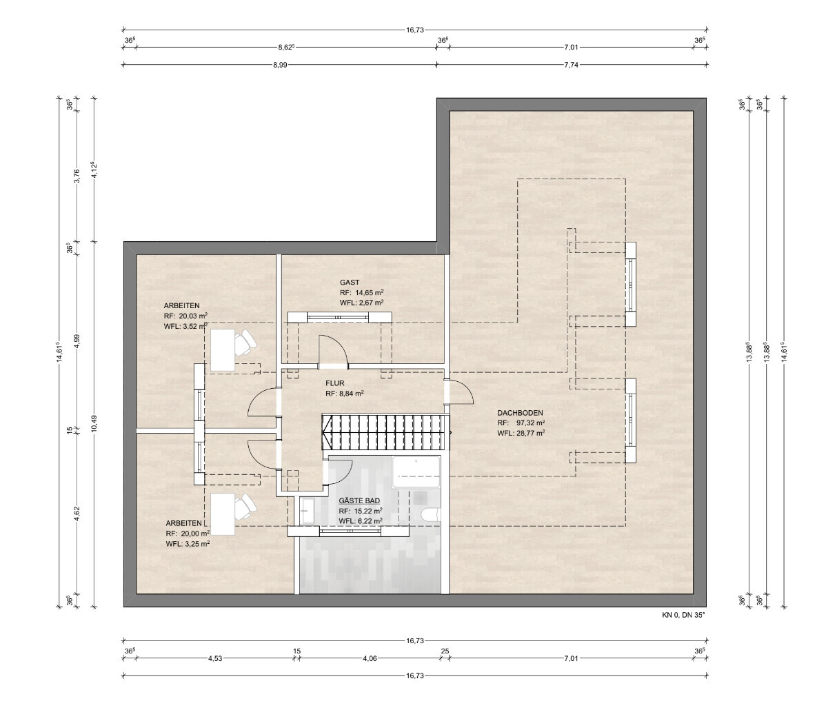

Note: I am still discussing this with the architect. Due to the hipped roof shape, the actual living area has shrunk too much. Therefore, further discussion is needed to accommodate the other rooms. I had underestimated the ratio of gross floor area to usable living space.
Basement:
Additional plans:
Now to my first questions for you:
My biggest construction challenge at the moment is the layout of the attic. There are two alternatives:
- Change the roof type, which would increase costs but provide more usable living space in the attic
- Give up the playroom on the first floor, convert it into a guest room, and build only the two offices in the attic (no guest room or bathroom)
Thank you in advance for your comments.

Attic:
- 2 separate offices
- 1 guest bedroom
- 1 small guest bathroom

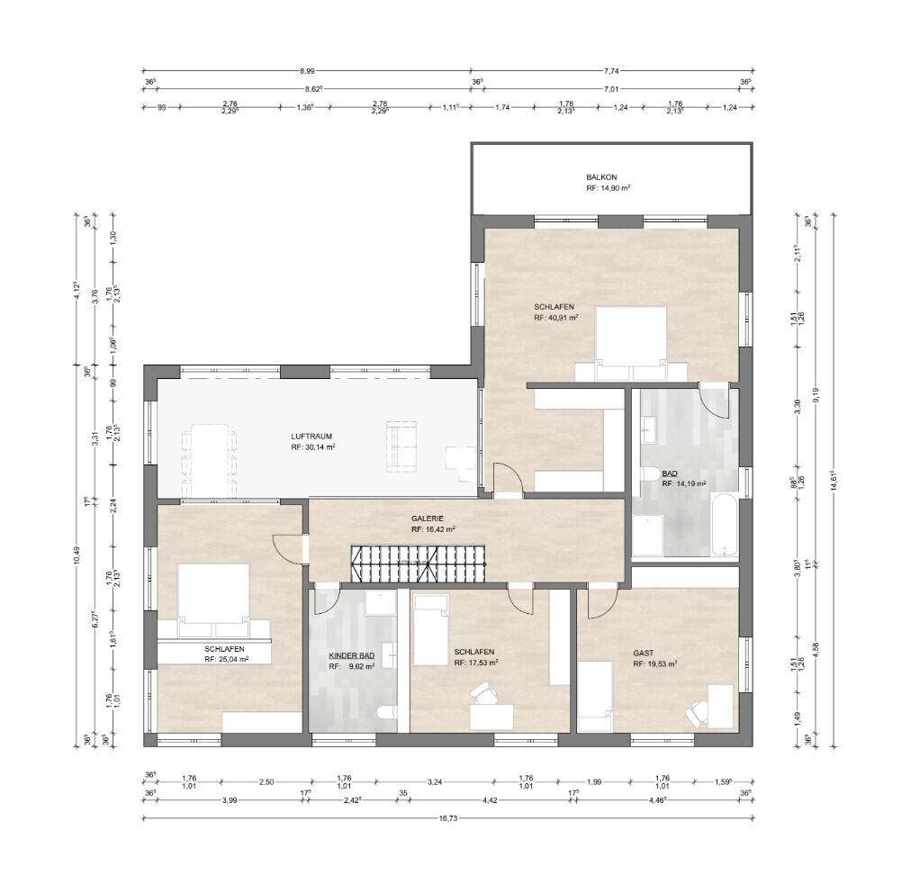

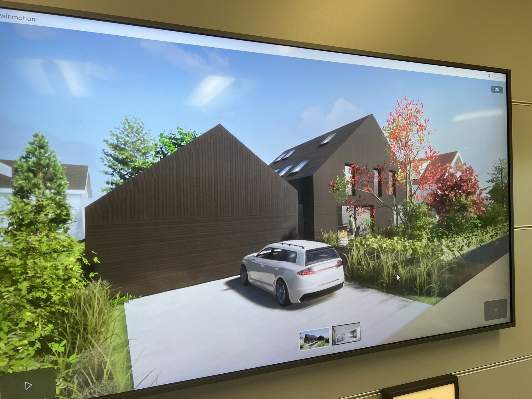

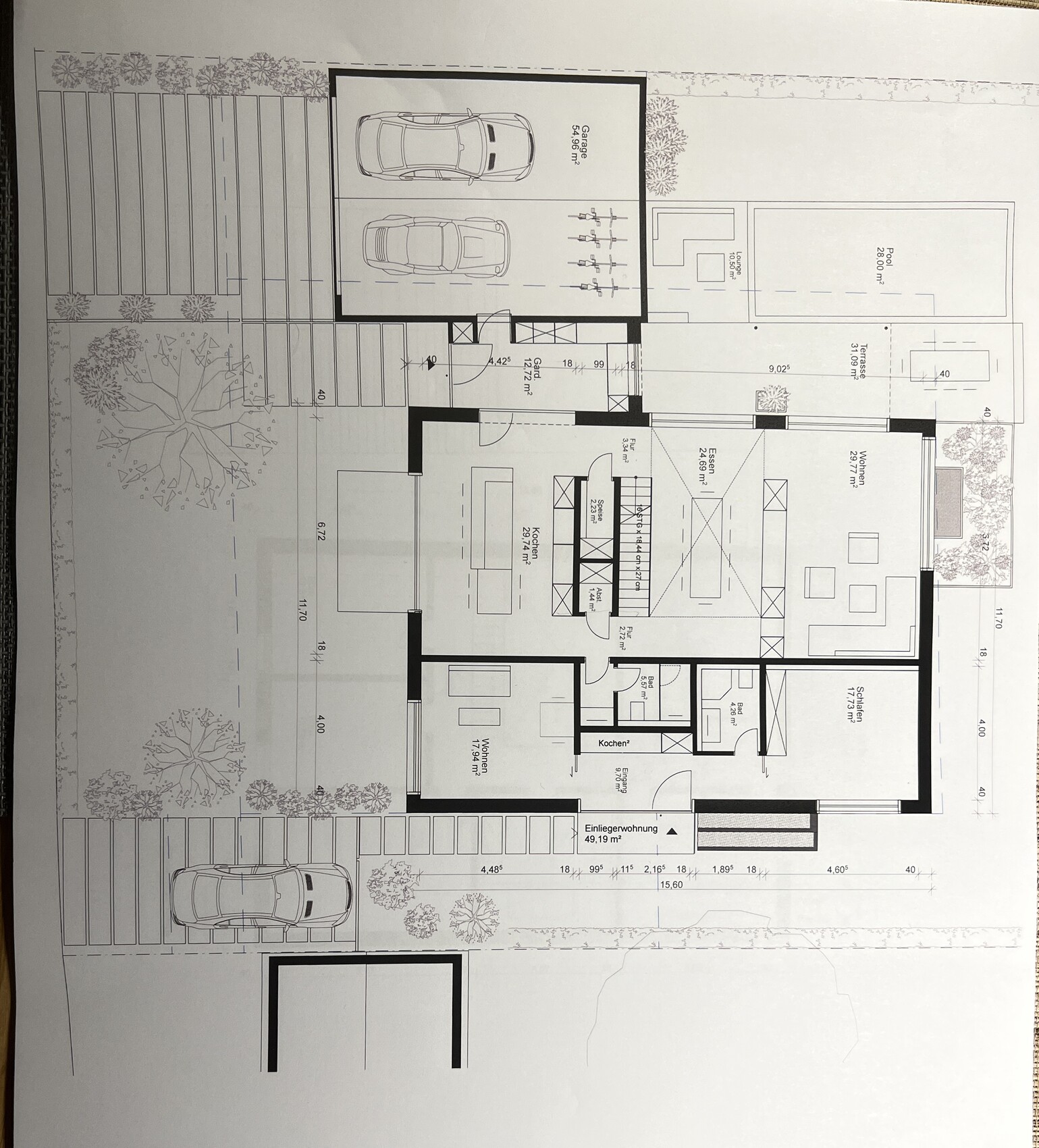

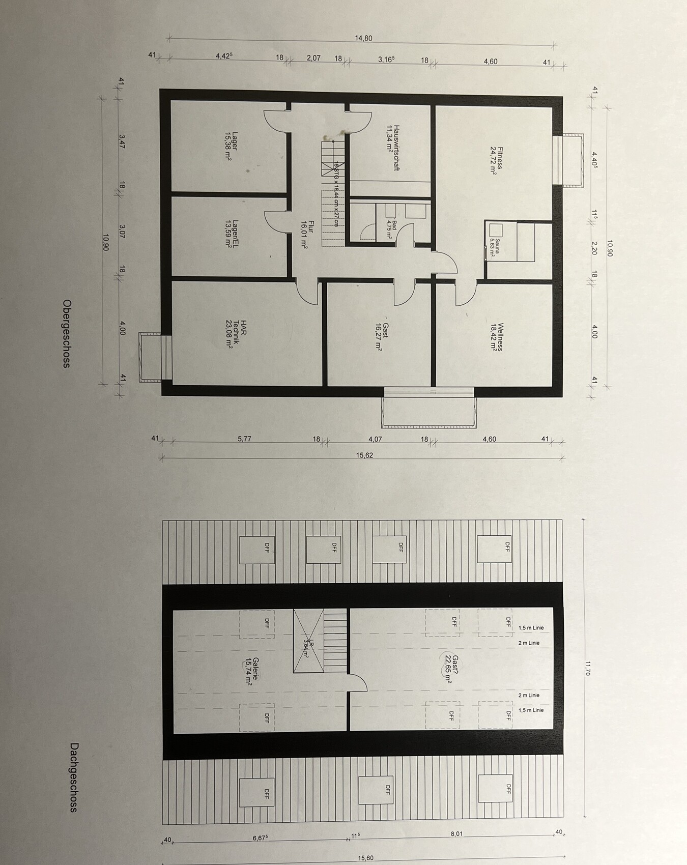

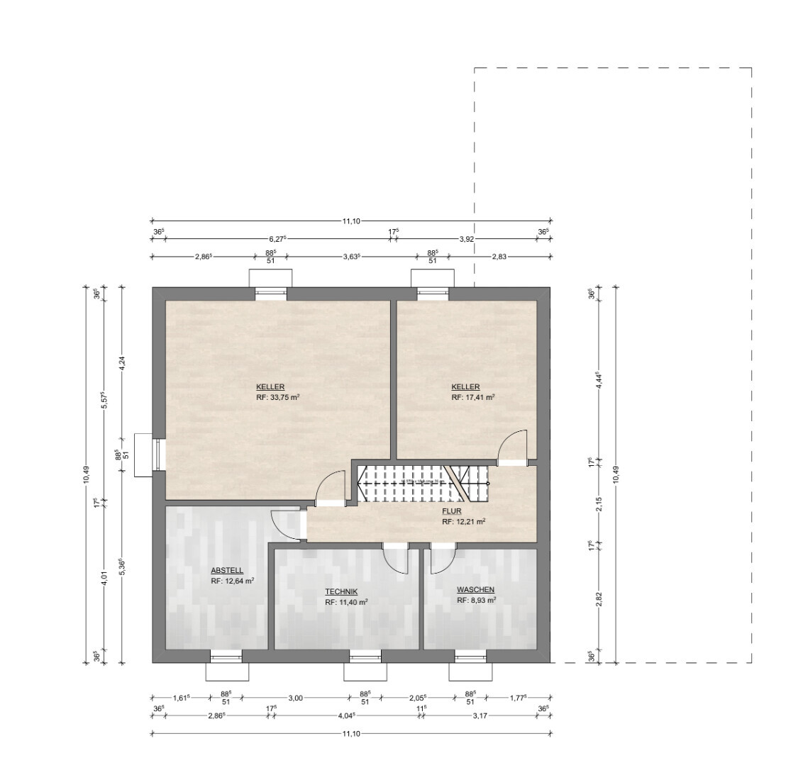

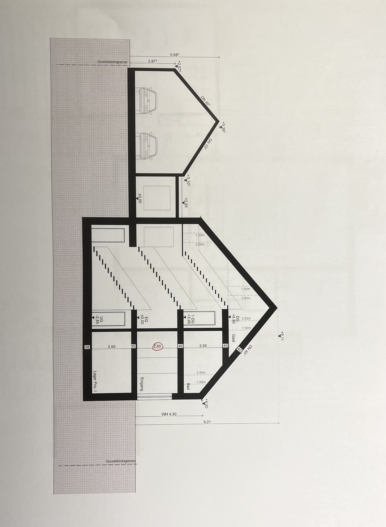

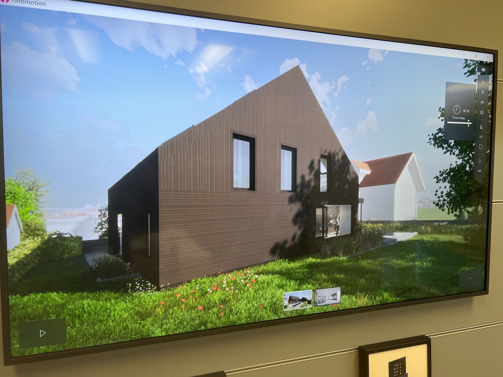

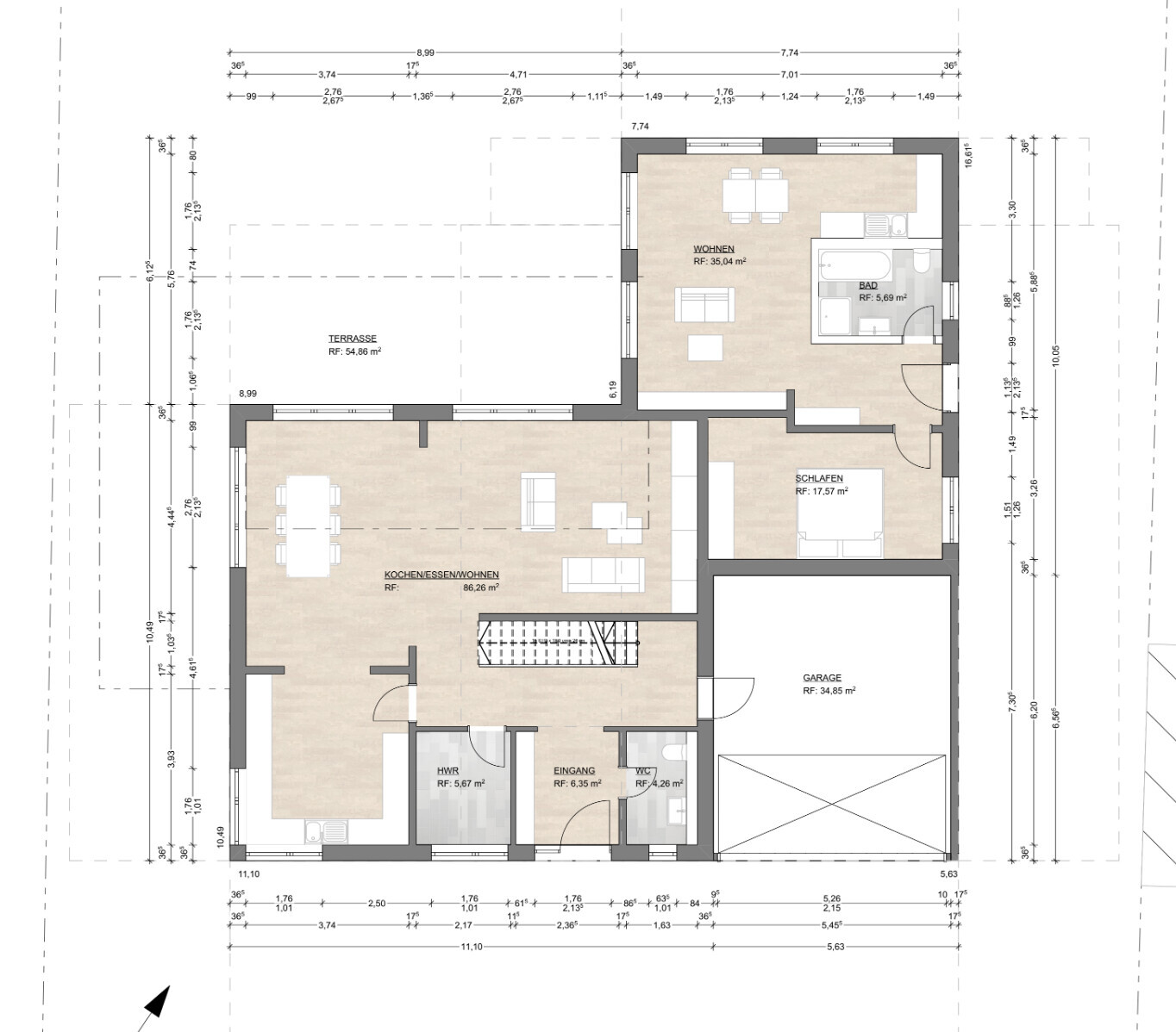

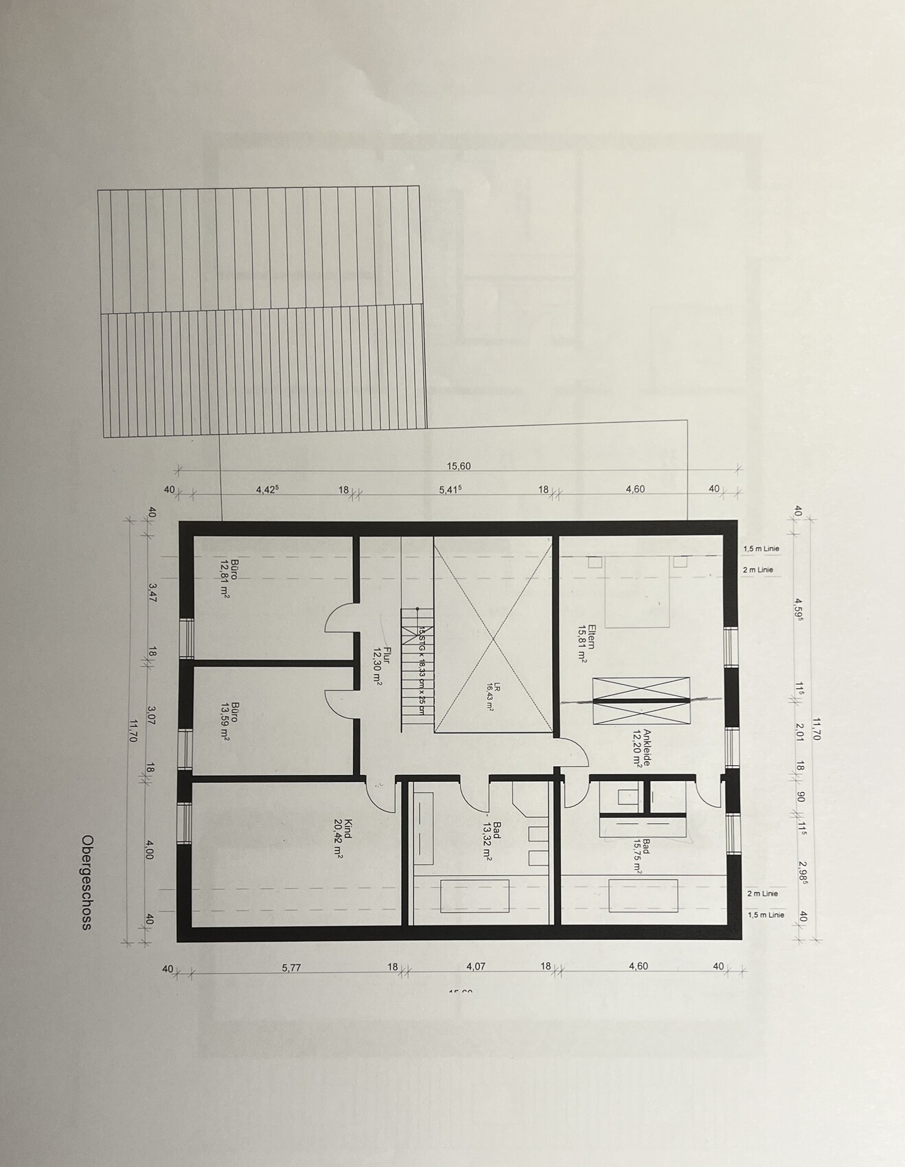

gregman2222 Sep 2022 20:50A personal major milestone has been reached: Today, we were presented with the first comprehensive design (including 3D visualization) and we are thrilled. At the same time, there is a lot of information to process.
Therefore, I am happy to share the current design with you. As always, I am very curious to hear your comments!
Side note: The design is currently somewhat larger than planned/budgeted. We have been presented with several options on how to respond to this.
Let’s get started 🙂
Let’s get started 🙂
Phew 😉 ... where was north again? I checked the initial post once more, and it mentioned an arrow on one of the views, but I can’t find it.
The floor area has gotten even larger now.
The rooms are all nice and spacious, and the entrance situation with the separate apartment (where is the terrace there?) is clearly better than in the original thread.
Bullet points: what stands out to me are the rather small showers in the master and kids’ bathrooms, even though the bathrooms themselves are quite large.
Then there’s the huge open space right above the dining table ... don’t forget to think about cozy lighting for the table.
Is there supposed to be another bathroom with a shower on the ground floor? And is it larger than the bathroom in the separate apartment?
The stairs from the basement to the ground floor have comfortable dimensions, while the stairs from the ground floor to the upper floor have different dimensions.
If the kitchen is already separated from the dining area, is it really desirable to have the kitchen as the first room you enter?
gregman2222 Sep 2022 21:36kbt09 schrieb:
Where was north again?The plot faces northwest. kbt09 schrieb:
The footprint has grown even larger now.Yes, that’s correct. The architect chose the option with one full floor instead of two because this allows 40% more floor area according to the building regulations / planning permission... This results in a more comfortable ground floor layout including the integrated granny flat. Additionally, with the steep roof pitch, we gained a small attic space. kbt09 schrieb:
Separation of the granny flat (where is the terrace there?)The granny flat is currently planned on the east side of the plot. For privacy reasons, it deliberately has no window or door facing north. However, this means it currently has no terrace either. kbt09 schrieb:
Then the huge void directly above the dining table... remember cozy lighting for the table.Good point – I need to think about that again. kbt09 schrieb:
Will there be a bathroom with a shower on the ground floor? And is that bigger than the bathroom in the granny flat?I’ll reconsider that... We might be able to skip that shower since there is one planned in the basement (combined with the guest room). kbt09 schrieb:
If the kitchen is already separated from the dining area, is it really desirable to have the kitchen as the first room you enter?We’re really struggling with this point. Pros for the kitchen: It gets beautiful morning sun, and my wife and I enjoy sitting at the breakfast table for about an hour every morning. Plus, the space is nicely open.
Cons: As a guest, you enter directly into the kitchen. If it’s messy there, it’s not a nice first impression.
Compromises?
- Swap kitchen and dining room – hmm
- Add a sliding structure by the kitchen to close it off flexibly when needed
What I don’t think makes sense is moving the kitchen all the way up next to the living room. Then we’d be working against the sun’s path.
Definitely an improvement.
The guest WC situation would bother me the most. I would move the toilet to the back part of the cloakroom and leave out the shower. The additional space could be added to the basement apartment. Maybe this way you could create a small recessed terrace. It’s a pity that the bathroom will have no window here. I really don’t like that in new builds.
I would probably accept the "kitchen compromise" in favor of light and openness.
How does the morning sun reach the kitchen if the granny flat is located on the east side? Wouldn't it be simpler to just add a north arrow to the floor plans? 😉
Why can't there be a terrace connected to the living room in the granny flat?
kbt09 schrieb:I have to revise that—I must have been seeing things wrong 😉
The staircase from the basement to the ground floor has comfortable dimensions, while the one from the ground floor to the upper floor has different measurements.
