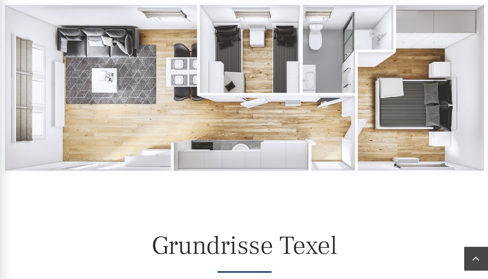

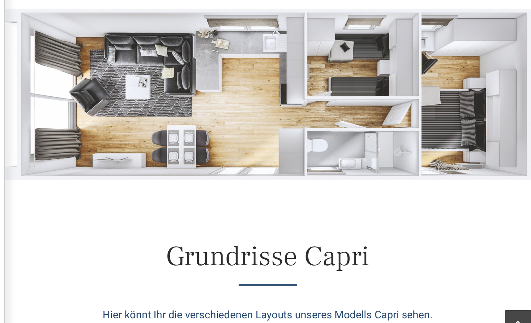

Here are some examples of how cozy mobile homes can be. Usually, the floor plans are designed for vacation use with four people and feature a kitchenette in the "hallway." With comfortable furnishings, it’s definitely more than just a hallway.
The latter is the €200,000 Flying Space from Schwörerhaus, as seen on Hausbauhelden.
