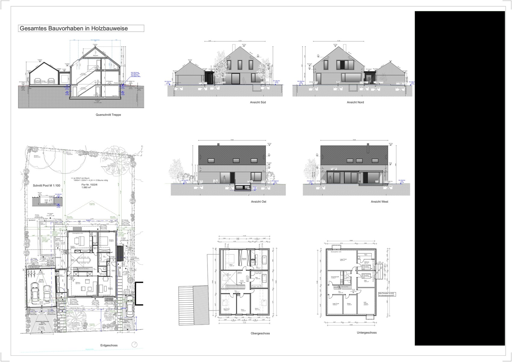

Dear community,
We are finally getting a step closer to realizing our dream of building a single-family home.
The plot has been purchased, building plans have been reviewed, construction method decided, and so on. We have now commissioned the architect of the general contractor (GC) of our choice with the planning task and are currently fine-tuning the house design. I would love to take you along on this journey and incorporate your valuable feedback.
At this stage, the focus is on the house design.
Basic data:
Plot: 1062m2 (11,433 sq ft); approx. 25.5m x 41.64m (84 ft x 137 ft)
Orientation: Northwest -> The arrow in the screenshot of the 3D view points south
Desired room layout:
Ground floor:
First floor:
Attic:
Note: I am still discussing this with the architect. Due to the hipped roof shape, the actual living area has shrunk too much. Therefore, further discussion is needed to accommodate the other rooms. I had underestimated the ratio of gross floor area to usable living space.
Basement:
Additional plans:
Now to my first questions for you:
My biggest construction challenge at the moment is the layout of the attic. There are two alternatives:
- Change the roof type, which would increase costs but provide more usable living space in the attic
- Give up the playroom on the first floor, convert it into a guest room, and build only the two offices in the attic (no guest room or bathroom)
Thank you in advance for your comments.

gregman2210 Dec 2022 13:32Hi everyone,
a new milestone has been reached and a lot has happened:
The following changes, partly or mainly suggested by you (thank you), may not yet be incorporated in the final floor plan. We want to collect all adjustments first before finalizing:
One topic currently occupying us: How can we make the best use of the attic?
It is clear we won’t create full living rooms there anymore. However, we want to make the most of the space and play with the room.
Ideas:
a) We partially lower the ceilings and have rooms (e.g., parents’ area) where you can see into the roof peak -> we are not convinced by this
b) We keep the ceilings as they are and create access from the gallery into the attic for storage
c) We actively integrate the space into the living area, especially in the middle where the standing height is greatest. Accordingly, above the walk-in closet and above Child 1’s room. These two “galleries” would be accessible from the adjacent rooms.
c1) Reading gallery above the walk-in closet, accessible from the bedroom
c2a) Gallery accessible from the office
c2b) Gallery accessible from Child 2’s room
c2c) Gallery “publicly accessible” and open towards the central area / main gallery; access via stairs from the main gallery
There is still the challenge of the stairways. Because of the roof slopes, it is likely not possible to walk upright up the stairs into the galleries. We still need to find solutions for this – possibly spiral staircases, which unfortunately take up space.
I am very curious to hear your opinions on the overall status (above) and on the gallery ideas.
Thank you – as always!
- There have been several discussions between the architects, the building authority, and us
- We have preliminarily discussed the desired deviations with the building authority and have already received an informal "ok" from the official in the current version
- There were several feedback loops between us and the architect -> the plans for approval are ready (see attachment)
- We will submit the approval plans before January 20, so we can be included on the agenda for the meeting on February 6 (already arranged)
- After several talks, we decided on an interior architect & interior consultant, with whom we have not yet started working. She will help us with the interior design and also provide ideas for the floor plan -> changes that do not affect essential features (building volume, ceiling heights, etc.) can still be incorporated later
- You will see the new ceiling heights in the floor plan (ground floor 3m (10 ft), upper floor 2.5m (8 ft 2 in)), which means there are no full living rooms in the attic as initially hoped
- The existing building has been demolished; soil surveys and surveying plans will follow in January
- We had to go through difficult rounds regarding flood protection. Ultimately, we do not have to raise the ground floor on a 50-60cm (20-24 in) platform, but the version of the plan is considered acceptable by experts.
- Guest apartment
- Shower in the bathroom of course, plus a normal door leading to the bedroom
- We accept the comfort issues you pointed out (e.g., kitchenette) in the guest apartment, as we don’t want to shift anything into our “main house” – we like it the way it is now
- The interior architect has already indicated she will address this
- Ground floor
- There will be a second door to the outside from the kitchen
- The glass wall from the living room to the cloakroom will be closed off
- No additional door or wall in the guest WC
- Upper floor
- Main bathroom: swap WC and shower
- Children’s bathroom: we may want to mirror the T-shaped layout of the main bathroom in the children’s bathroom because we like the long shower combined with the hidden WC. Everything, of course, a bit smaller
- Increase size of Child 1’s room at the expense of Child 2’s room -> very reasonable -> to be discussed further with interior architect & architect
- Walk-in closet: as you can see, we took your suggestion seriously and swapped bedroom and closet again. Now you enter the closet in the middle -> we like it; we will see if maybe a chest of drawers can be placed in the center of the closet for additional storage
Ideas:

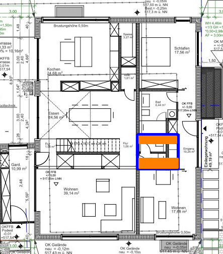

Sunshine38710 Dec 2022 14:15I would recommend painting the attic and taking advantage of the higher ceiling height. Since you only have 2.5m (8 feet) upstairs, the gallery area on the upper floor would probably feel too cramped given the size of the space. In my opinion, there are plenty of storage options available in the basement. With a maximum height of only 1.95m (6 feet 5 inches) at the highest point, spending time there on a beautiful large house with much better rooms probably isn’t very appealing. You would always have to walk hunched over with only 1.8m (6 feet) of headroom at the sides because of the roof beams. That’s why it’s better to use the full ceiling height so you don’t end up with a 2.5m (8 feet) apartment-like feel but really experience the spaciousness of the house.
What I don’t understand is why the toilet on the ground floor isn’t integrated somehow near the staircase, and instead a usable kitchenette is provided for the separate apartment. If someone is going to live there for a longer time and needs some independence, this almost 3m (10 ft) combination of wardrobe/kitchenette is not really practical.
