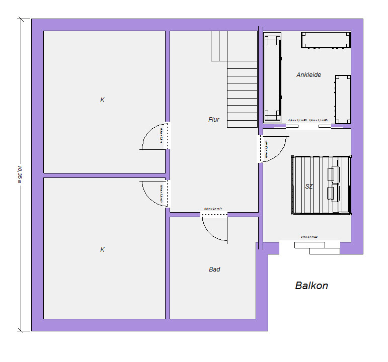

Good evening! After a long time, several discussions, and helpful advice from the forum as well as family and friends, we now have a new design.
The house has not been rotated; only the rooms are arranged differently. North is at the top.
We have read a lot about whether the master bedroom should be next to the bathroom, but not next to the children’s rooms. Now, the master bedroom is upstairs directly next to the bathroom. Having a direct door to the bathroom seems practical, but we don’t want to hear all the sounds from the bathroom in the bedroom. Do you have any experience or tips on how to reduce this?
Thank you very much in advance☺️

AJanJan schrieb:
Unfortunately, no one has responded yet. Could it be because of our own plans?You haven’t replied in #13 either.
It’s not very polite to simply overlook kaho’s work like that.
You are absolutely right...
kaho put a lot of effort into this and we didn’t respond... We are very sorry about that...
It seems we don’t deserve any more replies here then -.-
We favored kaho’s second design for a long time, although the distance from the bedroom to the bathroom is quite far there...
After that, we completely redesigned the upper floor.
kaho 674, thank you very much for your ideas, even if it’s already too late now...
