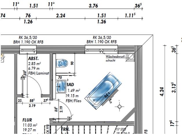

Mottenhausen2 Jul 2019 13:12apropos creative:
The drywall partition between the shower and bathtub extends to the ceiling and is about 1.1m (3.6 ft) wide. This allows easy access to the shower since the bathtub only protrudes around the leg area, leaving enough space for the upper body. Recessed storage niches for shower gel and other items will be built into the angled corner within the drywall and tiled.
For selecting the bathtub, a certain additional budget should be reserved due to its prominent location.

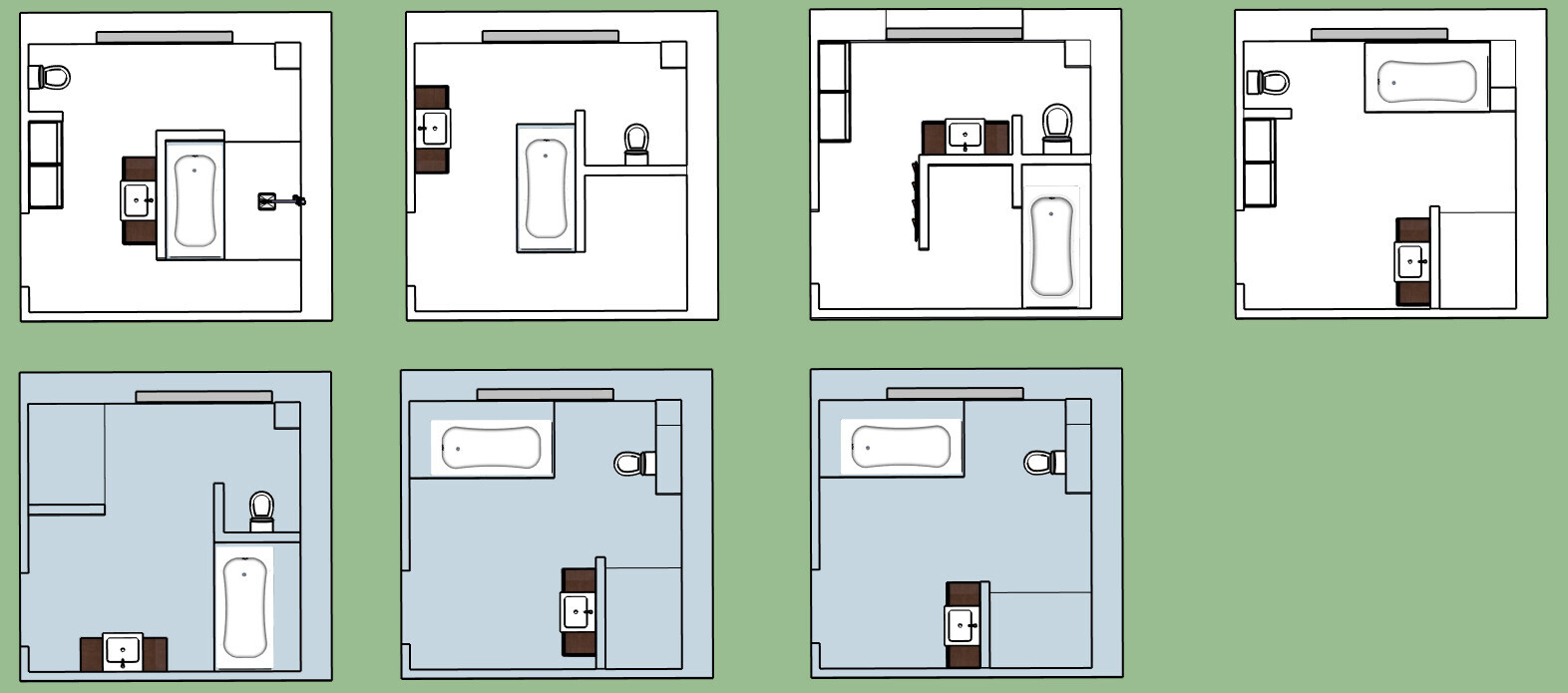

micric3 schrieb:
The first design is quite interesting. Shower as a bathtub exit. It would be interesting to see the look as a 3D model, but unfortunately, there are no daylight windows visible near the tub. The wall by the bathtub only needs to be just under 2 meters (6.5 feet) high. That would leave about 40-50 centimeters (15-20 inches) of space above to allow light through. I find the combination very efficient and space-saving, so I can’t quite understand some of the comments here.
I’m attaching a rough 3D model.
Mottenhausen schrieb:
Speaking of creative:
The drywall partition between the shower and tub is full height and about 1.1 meters (3.6 feet) wide. This makes the shower easy to enter since only the leg area of the tub extends into the space, leaving enough room at torso height. In the angled corner created by this partition, drywall shelves for shower products and similar items will be built in and tiled.
Due to the prominent location of the bathtub, a certain additional budget should be reserved for its selection. I don’t find it bad at all. We had considered the idea too, but thought it would require so much more space that we didn’t even try. We should have. However, I do miss some storage — one or two small cabinets should be in the bathroom. Perhaps a shallower sideboard could fit under the window; I’ll measure that right away. Thanks a lot for the suggestion!
micric3 schrieb:
@Mottenhausen Friends of ours have a nearly identical layout. It’s very stylish overall, but they have a freestanding bathtub (on feet), which I don’t find child-friendly. I don’t like bathtubs on feet because you have to clean underneath them, and it’s hard to reach under with a mop.
