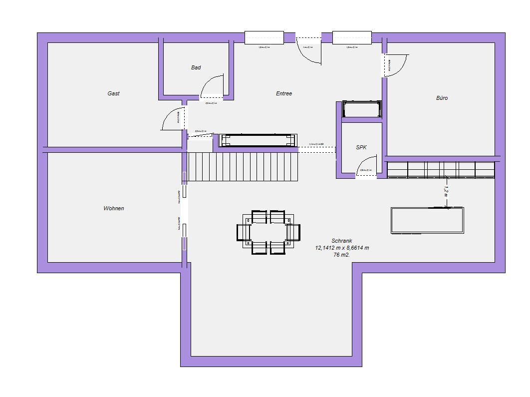

Some things are already different from the plans:
- All windows can be opened.
- Sliding doors open outwards, not inwards.
- All dormer windows will not be rectangular but have added triangular tops.
- Between the hallway and living area there is no central post; instead, a large double door is planned.
- The basement has a technical room beside the stairs, designed as a through room. In my opinion, this is a poor solution; we probably also need to plan a separate boiler room.
- Where the embankment is drawn, doors will be installed. This will allow the large rooms to get natural daylight and be usable living space.
- The stair step projecting into the hallway is bad and will definitely be removed.
We have also been thinking about other things:
- The hallway upstairs is planned as a “library.” To bring in light, we intend to use two light wells with diameters of 30–35cm (12–14 inches). The advantage: it will never be completely dark at night when someone needs to use the bathroom.
- The fireplace will be a soapstone stove; no plan exists yet. Strictly speaking, it will not stand against a wall but form the wall itself. We also planned a second connection in the fireplace room; originally we wanted a tunnel fireplace but were convinced it’s not a good idea as a room divider.
- The children’s rooms are not ideal — one faces north, the other south. We could make two narrow, elongated rooms and a corridor so both face south, but we consider that clearly suboptimal.
- All doors on the ground floor will be 1m (3.3 feet) wide to at least accommodate wheelchair access reasonably.
I think that’s it. Thanks for your opinions!
As expected, your contributions have indeed had some impact. On one hand, we share some of the criticism; on the other, when trying the new design within the existing exterior walls, we understand why we arrived at this solution in the first place. Therefore, we first took up the suggestion to redesign the staircase and entrance area; the rest will more or less have to follow from that. To make this staircase more elegant and fitting for the house, we set the premise that we will not accept a steep or uncomfortable staircase. With a height of 332cm (131 inches), we assumed a step height of 17.45cm (7 inches) and a tread depth of 28.1cm (11 inches), resulting in 18 to 19 steps, depending on whether the top step is counted.
I have attached two images that we can envision. There is always a door under the staircase, but we have at least 2.20m (7 ft 3 in) of space, so enlarging the doors should not be a problem — another good point. Both staircases allow a practical open space underneath, which we like. Regarding lighting, it is still borderline, but should be manageable.
Upstairs, we wanted from the beginning to separate the children’s and parents’ areas. Our previous solution only connects the bathrooms to keep plumbing routes simple. However, the large hallway offers enough space for a family bathroom with a bathtub (let’s be honest, the children will probably use it more). The downside is that this bathroom is directly adjacent to our bedroom, so it might be necessary to insulate the dividing wall significantly better. The wall insulation will be done with 100mm (4 inches) of wood fiber insulation, which is said to provide better acoustic insulation than mineral wool.
With the new staircase, we could enlarge the north room as a kind of compensation for the south-facing view. Another idea was to place both children’s rooms on the south side, but that would eliminate the separate parents’ area completely. Dividing the dormer results in noticeably smaller rooms, which is possible but seems unfair given the available space.

How about a straight staircase?
The staircase is often a central element in the design. What is important to you?
Does it have to be located in the hallway area, or—as in the example—can it be within the dining area? Especially if there is a large living space separated nearby, it’s great to connect the upper floor more closely to daily life via the stairs. Additionally, this location automatically keeps it out of the dirty or entry zone. It’s really a matter of personal preference.
Should it be possible to separate the floors later in life, or is this unimportant? This is an important consideration, as it can restrict the staircase design significantly and reduce options.
Can the staircase be curved with angled steps, or should it have only straight steps (either a landing or a straight flight)?
Should it start in the entrance/dirt zone, or would you prefer not?

keychain schrieb:
From the beginning, we wanted to separate the children's and parents' areas on the upper floor. Our current solution only connects the bathrooms to keep the plumbing runs simple. A good planner can route the pipes from one end of the house to the other and vice versa. In such large houses, having two plumbing shafts is not unusual—so what? While plumbing is important and it’s nice if pipes don’t run down the middle of the living room, you shouldn’t overdo it by trying to minimize the plumbing runs excessively.
kaho674 schrieb:
The staircase is often the central element in planning. What is important to you?
Does it have to be located in the hallway, or can it, like in the example, be within the dining area? Especially if there is a large living area separated off, it’s great when the upper floor is connected more closely to daily life via the staircase. Also, this way it’s automatically outside the dirt zone. Just a matter of personal taste.
Should it be possible to separate the floors in old age, or is that unimportant? This point should be carefully considered, as it restricts the staircase design and leaves fewer options.
Can it be curved with angled steps, or should only straight steps (with a landing or straight staircase) be used?
Can it start in the entrance / dirt zone, or is that better avoided?We want a staircase that matches the house’s atmosphere. That wasn’t the case with the first version—it had the desired landing, but both the step layout and the entire staircase design were very inconvenient. I find all three new options much less cramped.
So far, the staircase has been in the hallway to provide some acoustic separation from the living room. We can’t estimate how much noise passes through a solid wood door into the children’s room when we’re sitting there in the evening talking with friends—the second door seemed reasonable. But it also makes sense that the living, cooking, and dining area should be somewhat separated from the rest of the house, as there’s no direct connection. If the staircase is integrated into the living/dining room, the benefit would be that it feels more like a unified space, I think.

HausaufGrund13 Jun 2018 14:19This is what I meant about the staircase separating the living area from the entrance hall. (Images attached)
The staircase is marked in yellow; in front of it, an open space could be left as an atrium to create a stronger connection between the floors (green).
It might even be possible to plan for an elevator here.
Upstairs, there could be a nice gallery.
With the sliding doors on the ground floor leading to the staircase, you can optionally include the entrance area with the study and guest room as part of the living space—or not (also considering the basement stairway).
For me, the library would be located downstairs, to the left of the living room, separated from the rest of the living area by a sliding door.
The guest room on the ground floor could, if desired, be designed with an ensuite bathroom (as an option).
Whether you go up the stairs on the right or left is a matter of personal preference.
I would take the stairs on the left bottom side, so the “noisy” children do not have to pass by my bedroom door when they want to go to the ground floor. ^^
On the upper floor, on the south side, I would plan a rooftop terrace accessible from the bathrooms.
The architect can take care of the drainage system. P ;
In the master bathroom, I have planned a sauna. A large sliding door between the bedroom and bathroom allows both rooms to be combined into a spacious suite when needed.
A laundry chute could start in the hallway on the upper floor, possibly in the upper right corner near the north-facing children’s bedroom, and run down to the basement, concealed by the built-in closet on the ground floor.
At the moment, the master bathroom is designed as a private ensuite. If preferred (for example, if someone wants to sleep longer), it could be redesigned with access to the hallway or similar.
Based on your description with the larger windows in the basement, I would place exercise equipment there, and use the other rooms upstairs to be more spacious instead.
Of course, this is just a suggestion to help imagine a different layout—I am not an architect.
A new staircase location always opens up new possibilities for room arrangements.
With this staircase position, it might even be possible to separate the upper floor from the ground floor.
Have you ever discussed a straight staircase placement for this floor plan with your architect?
But all of this depends heavily on personal taste. This idea just came to me yesterday when I saw your floor plan.
I can personally imagine it working well.
I have no idea if any of this appeals to you, but I thought I’d take the time to sketch something out, especially since your timeline seems tight.
