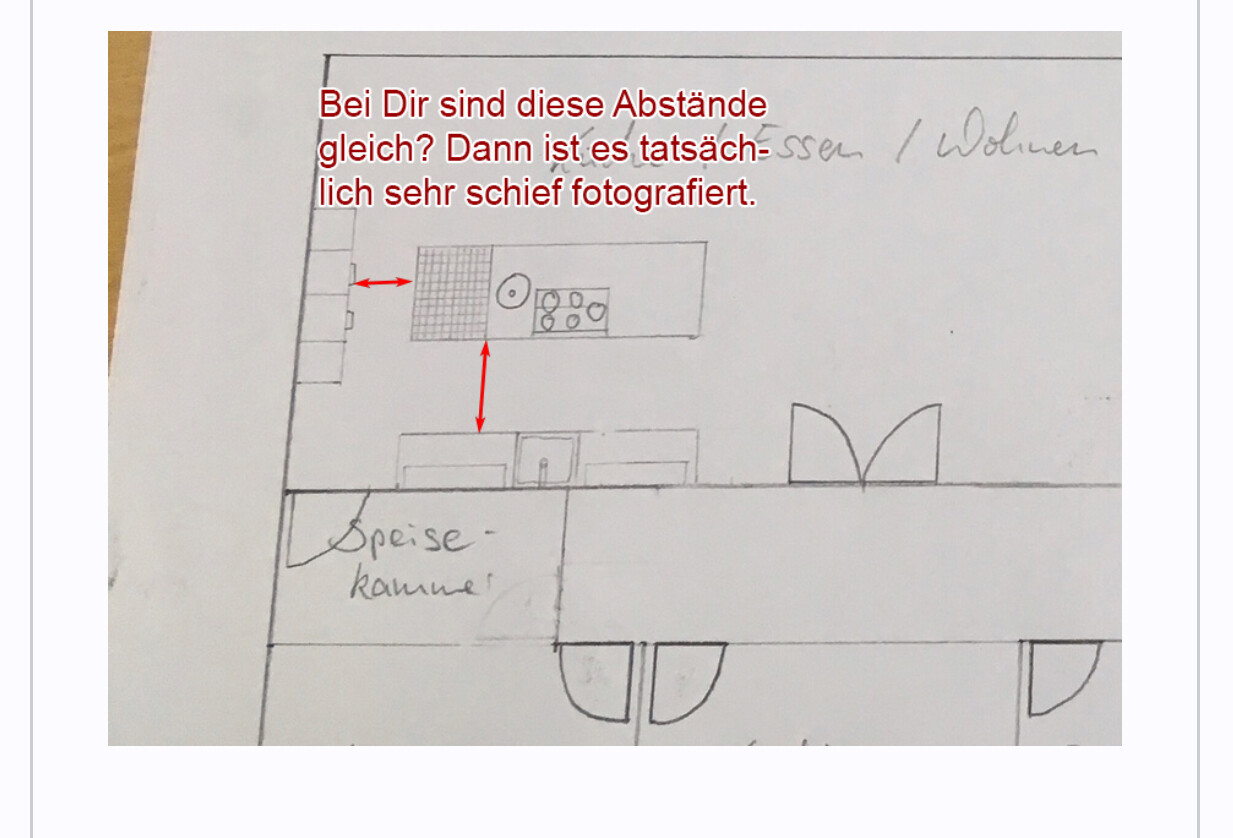

Some things are already different from the plans:

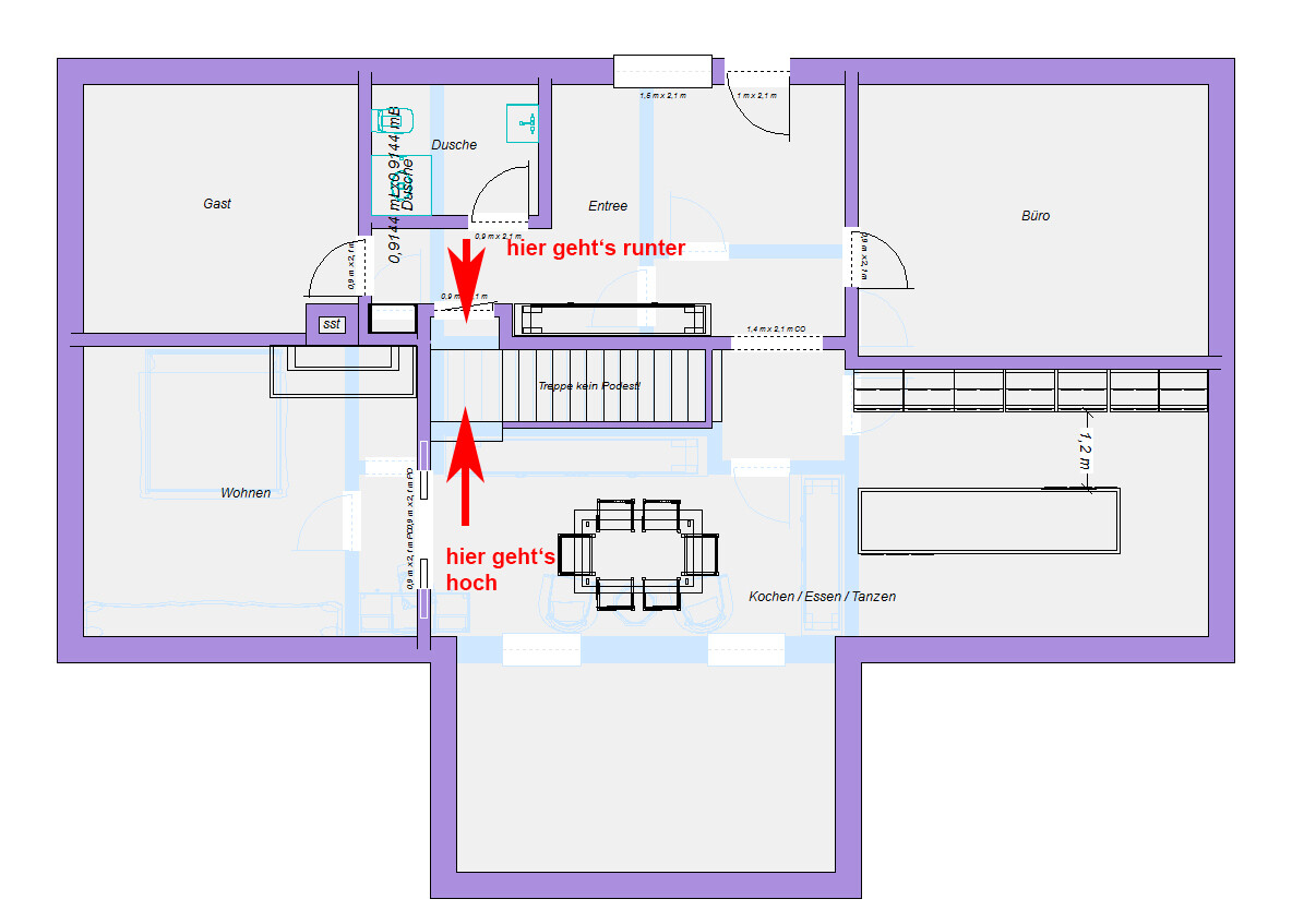

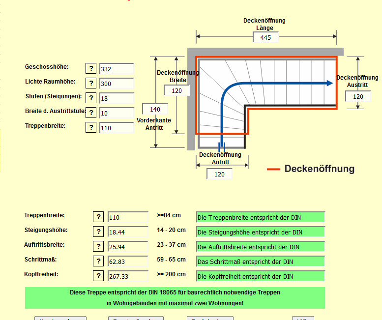

One more question about the stairs: If there is no landing, but that should be the lower part, don’t you have to keep a depth of 1m (3.3 feet) clear where the wall currently is? It’s still not entirely clear to me how you actually get up there… And does the basement staircase then lead down from the pantry? Or is it the other way around, but then when you go upstairs, you end up right in front of the wall on the upper floor?
We will make another round of drawings. If anyone has any suggestions: feel free to share them.

Will the staircase with the 2m (6 ft 7 in) height clearance work without hitting your head? It looks to me like the staircase, at least the basement stairs, would have to be extremely steep. Maybe it can be adjusted by shifting it a bit to the right on the first floor—I’ll give it a try with my drawing skills.

It should work with the staircase at a 330 floor height and 300 ceiling height. It will look approximately like this:
I always calculate staircases with a 1:1 slope for spiral stairs.
Headroom should be over 2.60 m (8 ft 6 in) with a 300 cm (10 ft) room height. Please confirm the exact ceiling height and floor-to-floor height again – otherwise, I might get lost trying to find it...
