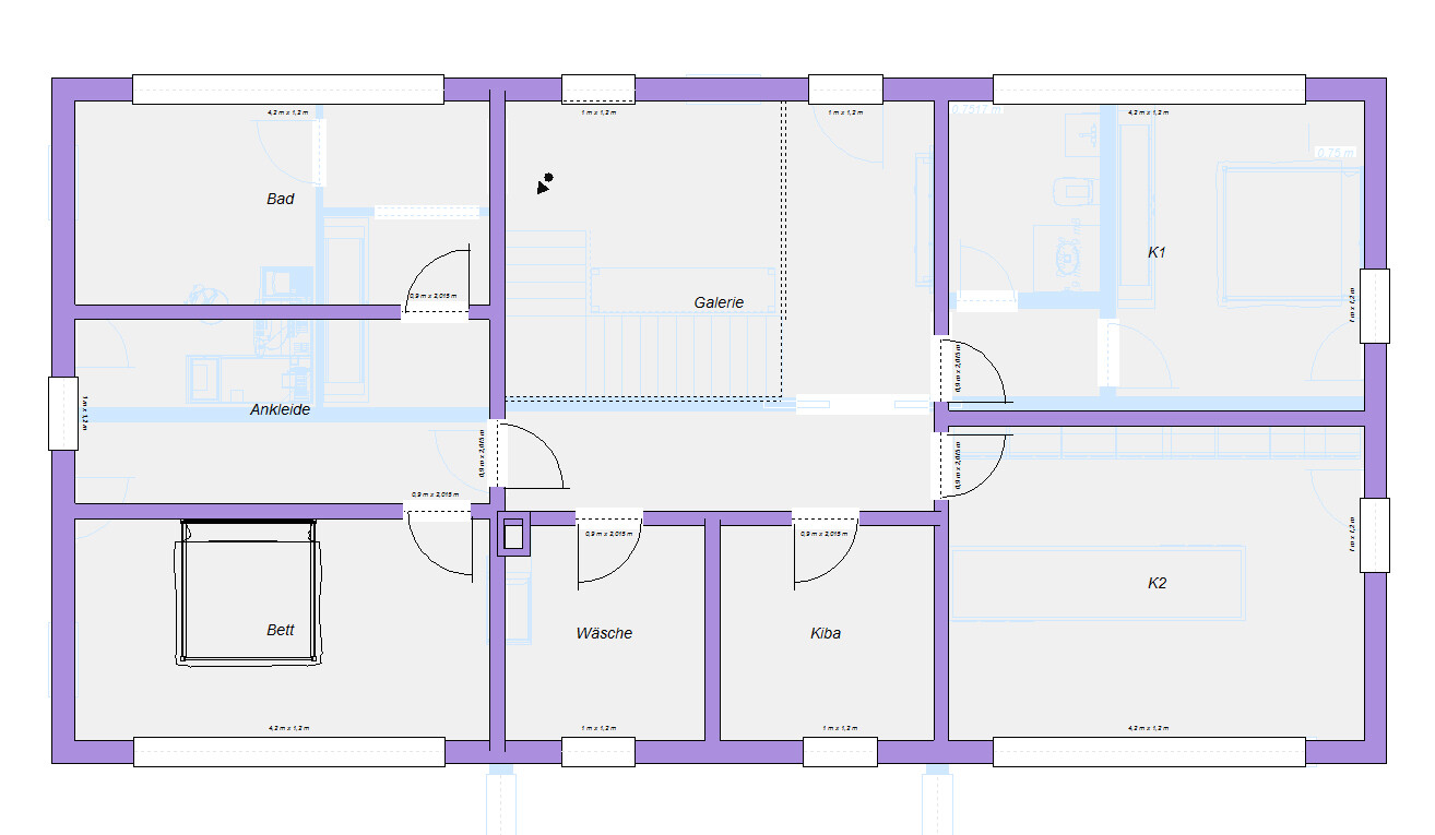

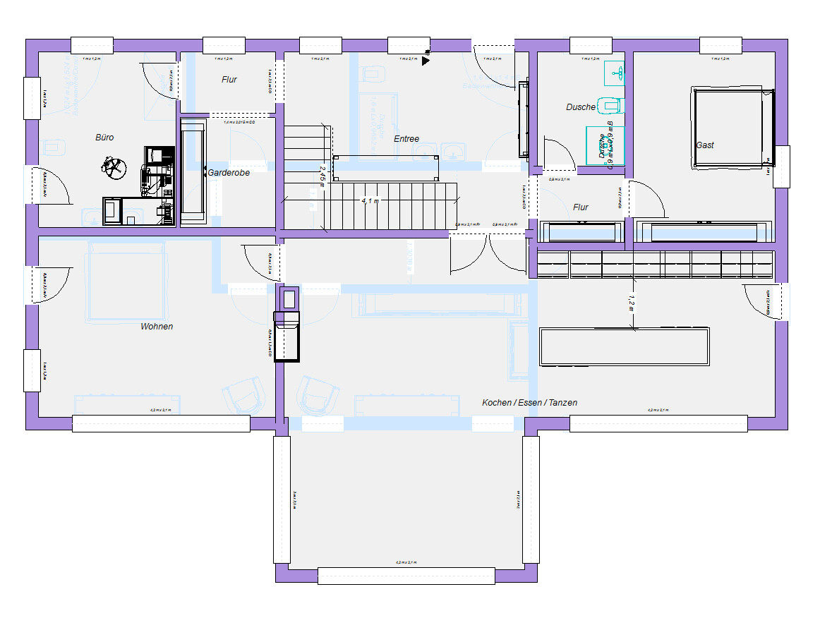

Who designed it:
The design was created with an architect, based on our drafts.
High ceilings and visible ceiling beams on the upper floor, separated area upstairs for us, the fireplace room as a second retreat, the single-story “extension” for the dining room, the large kitchen, the fireplaces... and especially the abundant wood.
What don’t you like? Why?
The gable windows should get an added triangular top to maximize light. The current window layout feels a bit outdated. We actually wanted an open void, but this can’t be sensibly integrated. Heating is a constant issue and never fully resolved.
The worst: the master bathroom fixtures. We want a large bathtub and a double shower. Either the bathroom is too small or we lack imagination. It doesn’t look cozy...
Preferred heating system: currently unfortunately natural gas. Solid fuel heating is out for various reasons: a wood gasifier is too expensive and labor-intensive; pellet or woodchip stoves are not economical, plus we can’t reliably get deliveries in winter when the road is snowed in. Natural gas is about 100m (330 feet) away; we are still waiting for connection cost estimates. Heat pumps only make financial sense with geothermal; however, installation and technology would then be more expensive than a current compact car. We do not want oil heating or liquefied gas tanks.
If you have to omit something, which details/extensions
-can you omit:
-can you not omit:
Why is the design like it is now? For example:
The architect received a draft from us, every room was discussed beforehand (use, size, contents), and the design was revised multiple times. We like that it implements nearly everything we wanted and that the house does not look too bulky — due to the half-hipped roof and the gables, it does not seem so on the plans at least.
What is your most important / basic question about the floor plan in 130 characters?
Apart from the effort for plastering: is the floor plan practical? For example: washing machine on the first floor where laundry occurs, bathroom for the children...
Now some free text — our notes:
Some things are already different from the plans:
We have also been thinking about other things:
I think that’s it. Thanks for your opinions!

- All windows can be opened.
- Sliding doors open outwards, not inwards.
- All dormer windows will not be rectangular but have added triangular tops.
- Between the hallway and living area there is no central post; instead, a large double door is planned.
- The basement has a technical room beside the stairs, designed as a through room. In my opinion, this is a poor solution; we probably also need to plan a separate boiler room.
- Where the embankment is drawn, doors will be installed. This will allow the large rooms to get natural daylight and be usable living space.
- The stair step projecting into the hallway is bad and will definitely be removed.
- The hallway upstairs is planned as a “library.” To bring in light, we intend to use two light wells with diameters of 30–35cm (12–14 inches). The advantage: it will never be completely dark at night when someone needs to use the bathroom.
- The fireplace will be a soapstone stove; no plan exists yet. Strictly speaking, it will not stand against a wall but form the wall itself. We also planned a second connection in the fireplace room; originally we wanted a tunnel fireplace but were convinced it’s not a good idea as a room divider.
- The children’s rooms are not ideal — one faces north, the other south. We could make two narrow, elongated rooms and a corridor so both face south, but we consider that clearly suboptimal.
- All doors on the ground floor will be 1m (3.3 feet) wide to at least accommodate wheelchair access reasonably.

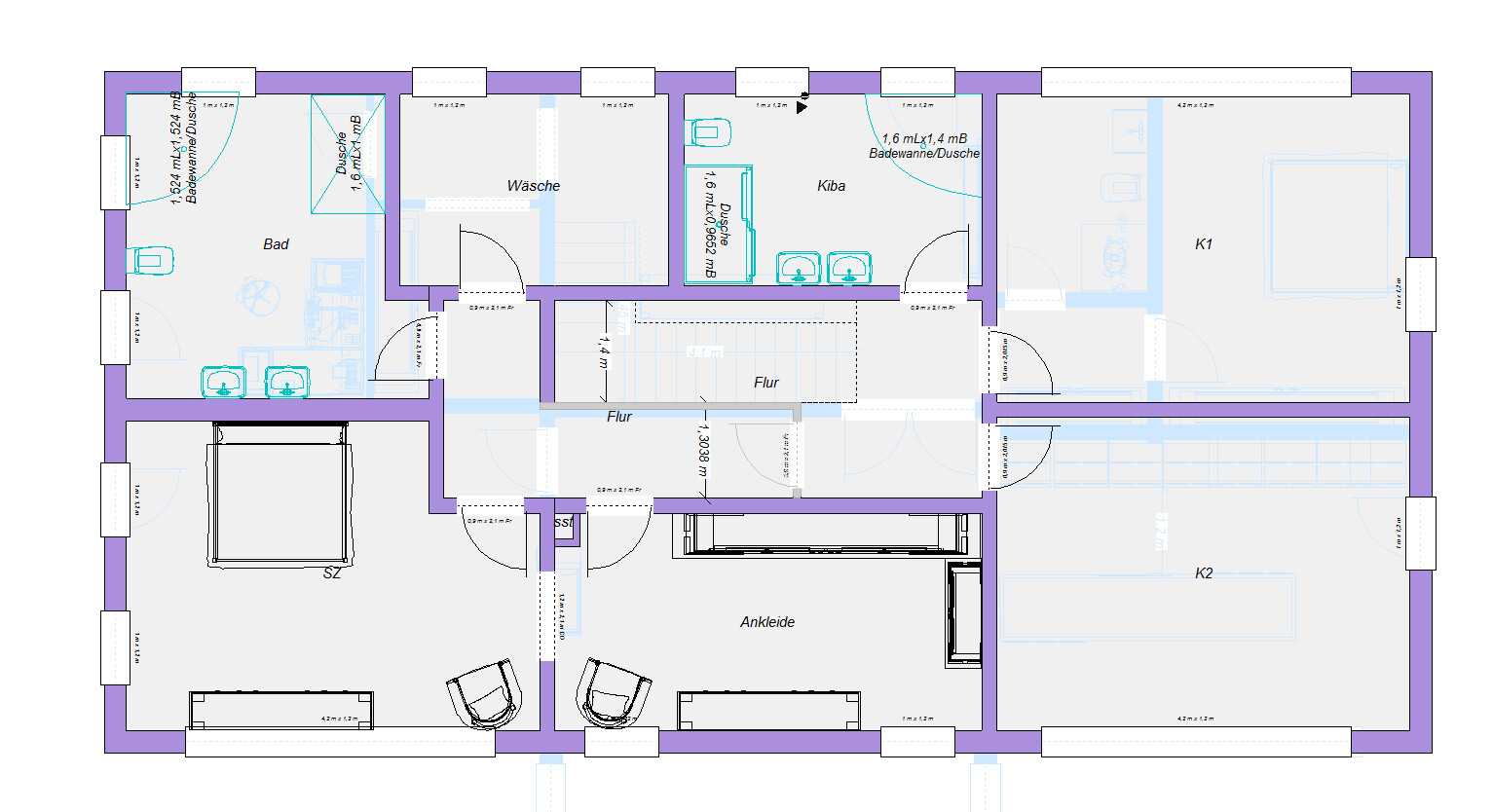

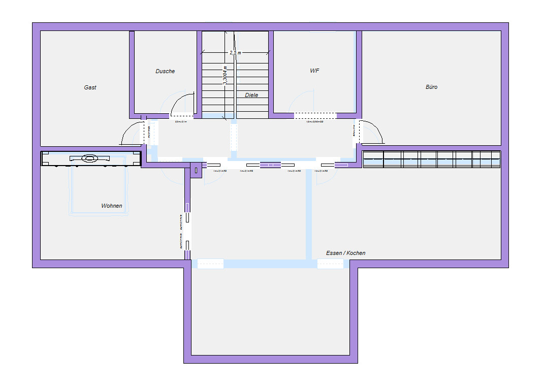

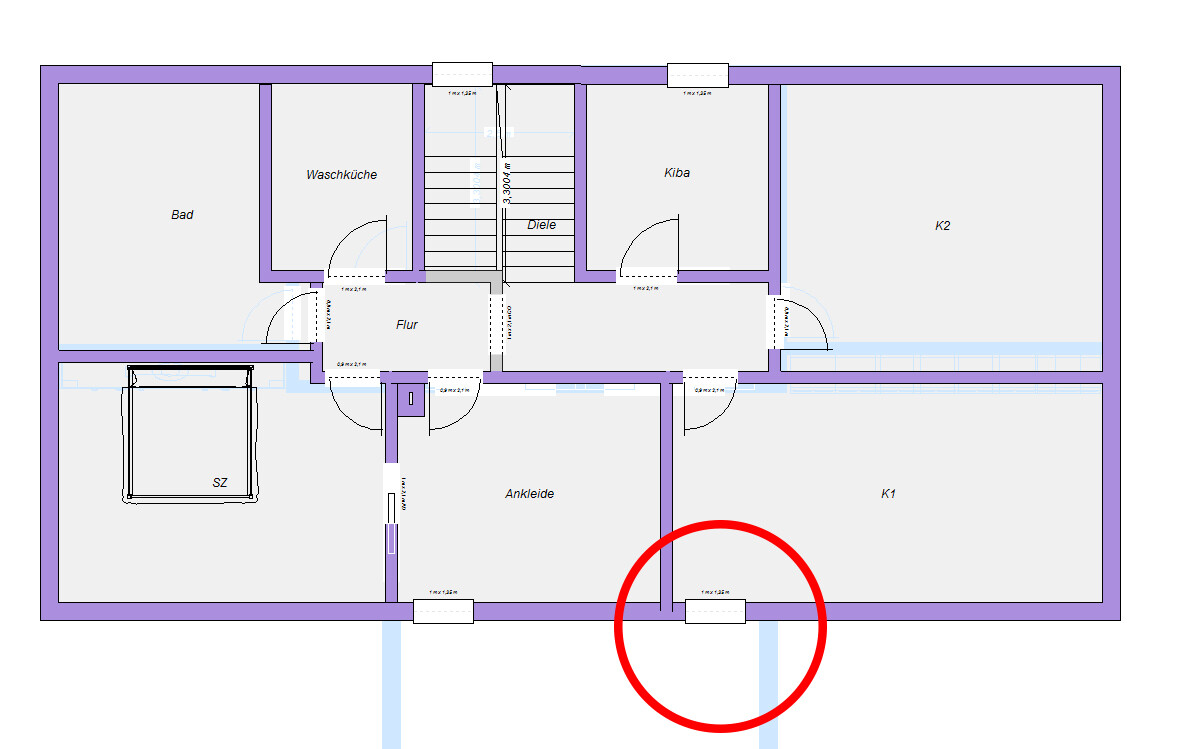

@kaho674
Thank you for your effort and work! The latest floor plan matches what we sketched yesterday, but our dissatisfaction with the overall project is growing. We feel like we’re playing a sliding puzzle – moving rooms here and there, but the overall concept of the house is becoming less and less clear to me. There are especially many compromises involved that really bother me. We are therefore close to tearing up the design submitted for the building permit / planning permission and starting over from scratch.
Because of this and based on our experience with the first draft, we have also started to ask ourselves some fundamental questions again, for example: Is it practical to place all the private rooms upstairs and thus break up the open roof structure into many small rooms where it loses its effect – while having a living/dining area that we can’t really use optimally, needing to run the chimney through the second floor, and so on?
Clearly, placing the living areas upstairs is generally more work because all groceries have to be carried upstairs. But having a laundry room on the ground floor makes a lot of sense if all the bedrooms are there. Currently, we live on the 7th floor in a building with an elevator that only goes up to the 6th floor – so for our retirement, we will need to plan a separate elevator shaft, which should work out.
We will look into different styles of timber houses this weekend and then try to revise our planning. We will get back to you once we have something.
Thanks also to everyone else who has encouraged us to reflect so far… Unfortunately, the house is not as great as we originally thought. But it’s better to realize that now than later.
@haydee
It’s an option, but it doesn’t seem very practical to me: If the kitchen is downstairs, we might still have odors upstairs. If the kitchen is upstairs and the bedrooms are downstairs, that shouldn’t be an issue anymore. The fireplace is very important to us; if it’s not in the center of the rooms where we spend most of our time, it doesn’t make much sense. Having guests and children upstairs gives us peace, but in the evening we can’t easily sit by the fireplace and chat without disturbing them when they are there.
Maybe we are overcomplicating things. Is there anything about the layout we have in mind that you would advise against?
Yes, I was already wondering why you want to put the cart before the horse. The building permit / planning permission is usually applied for only once you have the finalized plan in hand. At least you now know what is important to you.
Unfortunately, I can’t fully follow your thoughts. Why should the bedrooms be on the ground floor and the kitchen on the upper floor? Or did I misunderstand?
