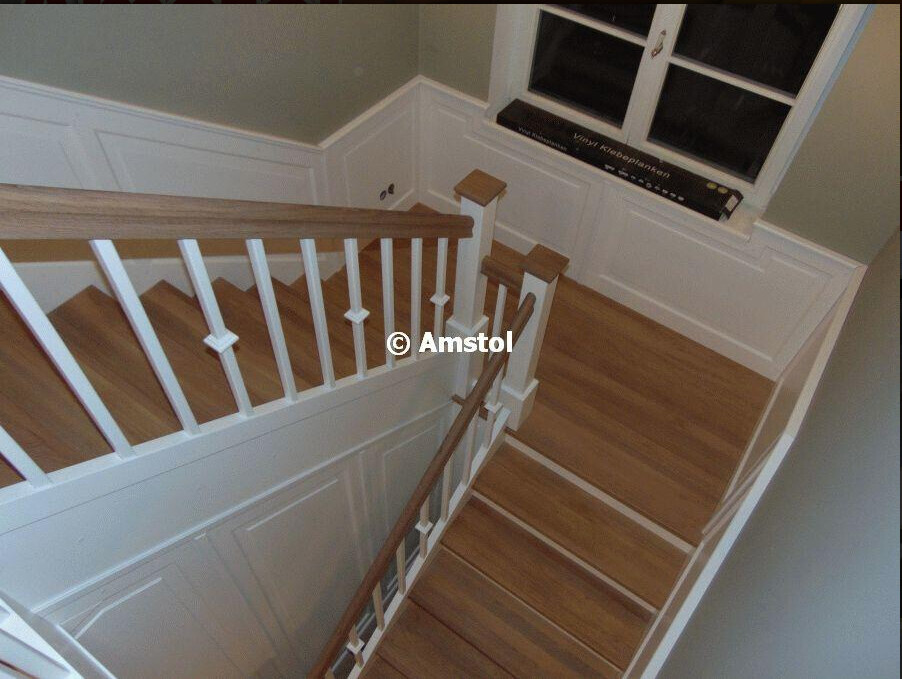

I need to take a closer look. Sometimes images just come to mind spontaneously. Especially your house, which really stands out.
For example, the staircase in your picture—I can already hear it creaking, and I can picture myself carrying my large trekking backpack upstairs without stumbling or knocking decorations off the wall. In short, it reminds me of cramped Scottish bed and breakfasts.
In your place, I saw a fireplace reaching all the way up, framed with natural stone, windows facing the forest up to the gable (I shouldn’t be looking at houses during vacation), a large open wooden staircase with slightly wider steps at the bottom.
It has to please you, not me. There are beautiful, modern wooden staircases that feel airy and light.

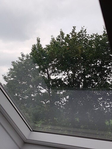

Hey @keychain,
regarding your concerns about the roof windows and the nearby forest, here are some photos of our windows (we have two).
We live right at/in the forest, about 6 and 9 meters (20 and 30 feet) away from mixed woodland with pines, firs, birches, oaks, poplars, and various other trees.
The windows were installed at the beginning of July last year, and since I’m not very keen on cleaning windows, I have cleaned them exactly once—last July to remove the adhesive residues.
As you can see, you can easily see through them. Now there are a few fingerprints inside, but our windows are within reach of children and cats and are also occasionally opened by me.
So I think that despite living near the forest, these windows don’t require much maintenance, and you can still see through them clearly with little to no cleaning.

From our experience, staircase placement is absolutely key for a good floor plan. We actually scrapped an entire design late in the process, right before the building permit/planning application, because of this. But on the second try, we ended up with a completely different and much better house for us. It was financially painful, and it takes real effort to start over, but we don’t regret it and wish we had done it earlier, in phase 2 rather than right before phase 4. That was a big mistake on our part to realize it so late.

I think the best view is from the top, right? ...
