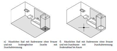

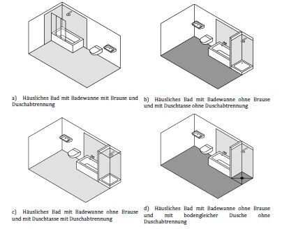

Yes, waterproofing in bathrooms is mandatory according to DIN 18534.
Depending on the shower design (without a tray, with a partition, etc.), there are different requirements for walls and floors.
Light and dark gray areas indicate the waterproofed surfaces.

Okay, this is a clear overview, perfect, and thank you.
