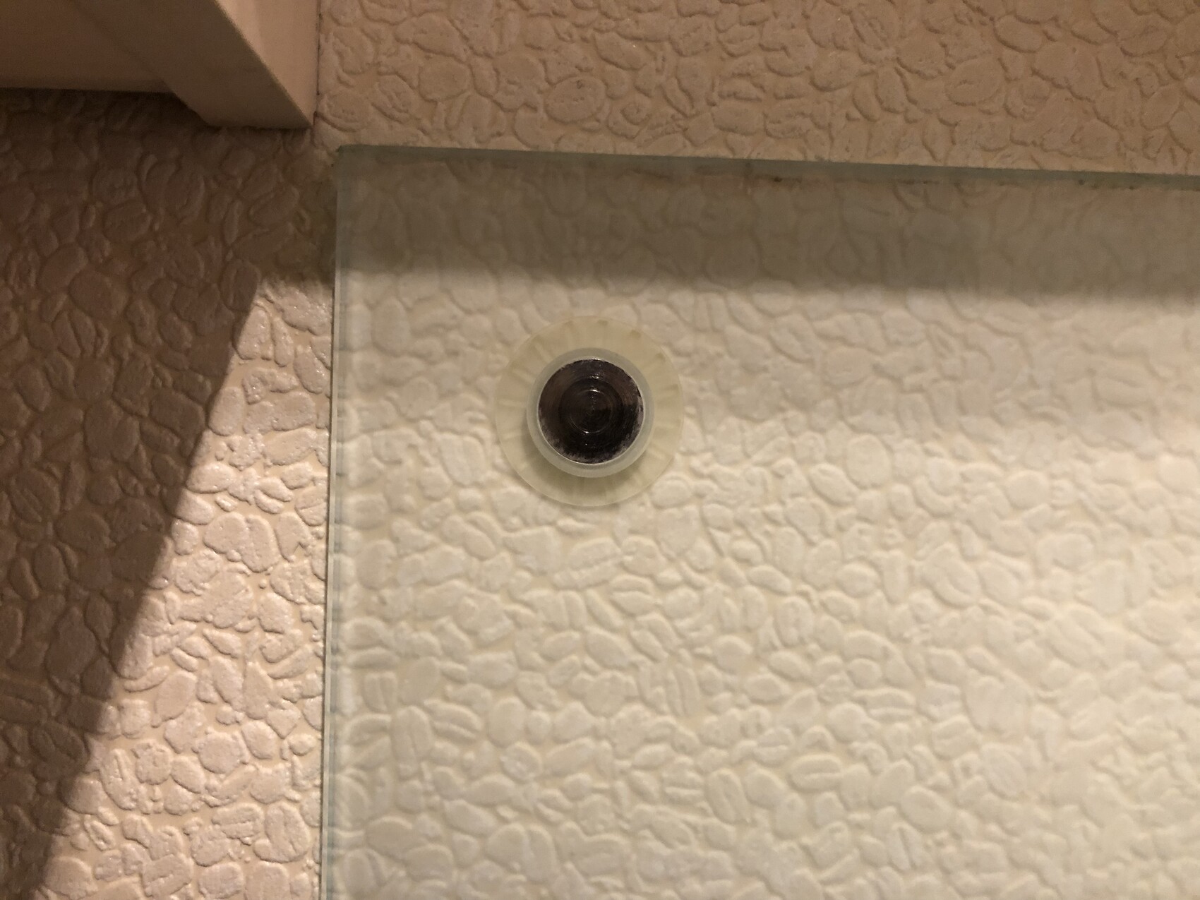

driver55
5 Dec 2021 16:47
Pacc666 schrieb:
How do we fix a glass cover? Is the glass glued on?
There are special mounts/clips/brackets for that.
The glass is not glued.
Small suction cup on a glass wall in front of a rough, textured wall.
kbt09
5 Dec 2021 16:56
@driver55 .. for transparent glass, certainly like in your case. Opaque glass, if colored, can definitely be fixed with a few silicone dots.
