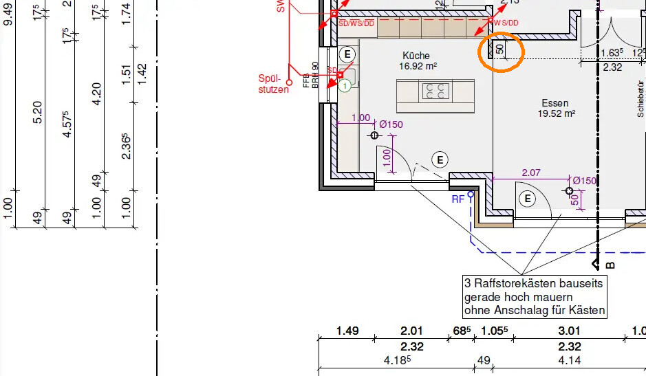

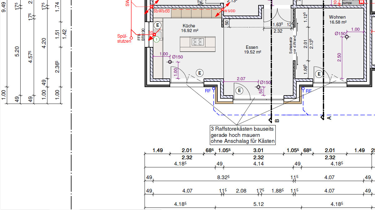

This concerns the southern area of the house:
As a note, the island would likely shift slightly further south because the passage to the 50 cm (20 inches) wall section becomes narrow, and the space between the cabinet wall including the oven is currently quite tight.
No matter how you open either of the two doors at the bottom left, either the left door blocks the cabinet intended for dishes, or the right door obstructs the walkway towards the restroom.
At the same time, we are also considering switching to a lift-and-slide door in the dining area, where the passage would be wider.
The terrace would be placed at the bottom left of the plan, facing southwest.
Hmm... what about the 50 cm (20 inches) stub (orange circle)? Is that just a ceiling beam or a full-height wall?
However, the left-hand door in the plan partly blocks the pull-out base cabinet at the bottom left of the plan. You can pull it out halfway, and if you still need something from it... well, then you just have to close the door again.

The small wall section is non-load-bearing, full room height, and is intended to create some separation between the kitchen and dining area. To the right of it, a sideboard is planned.
An outward-opening door would also be an option; the window fitter wanted to provide a quote for that and confirm its feasibility.
markusla schrieb:
or the right door blocks the path to the restroom.That made me laugh. I had to pause and think about what you meant by “restroom.” You mean when entering from outside? I don’t think it’s necessary to focus too much on quick visits, but rather keep a balanced perspective overall. markusla schrieb:
either the left one blocks access to the cabinet planned for dishesBecause you can also store items in that cabinet that you don’t need to access 10 times within an hour, especially if by chance the patio door is open. These coincidences don’t happen all year round. I definitely wouldn’t put calcium silicate blocks there. markusla schrieb:
At the same time, we’re also considering switching to a lift-and-slide door in the dining area,Here, I think a sliding door makes more sense. I would skip the 50cm (20 inch) wall and instead use the next wall as load-bearing. I would consider a distance of about one meter to 1.10 meters (39 to 43 inches) from the kitchen unit for this island length.
