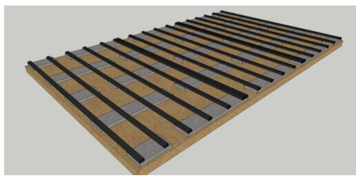

Personally, I find HPL decking visually appealing. However, most HPL boards are only 10mm (0.4 inches) thick. Even with a substructure spacing of 30cm (12 inches), these boards tend to flex underfoot. That was a deal-breaker for me. Unfortunately, I don’t know anyone who has an HPL terrace and can say how long such a finish actually lasts.
By now, I believe that a proper substructure and correct installation are crucial for the durability.
Thank you. I have ordered samples and will decide afterward. Installation instructions can be found from the supplier.
The reason why HPL is only half as thick as WPC is probably due to the price.

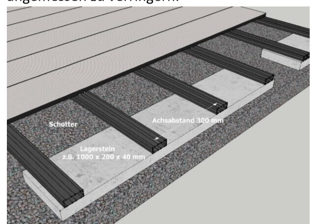

The joist spacing of the substructure is specified as 300mm (12 inches).

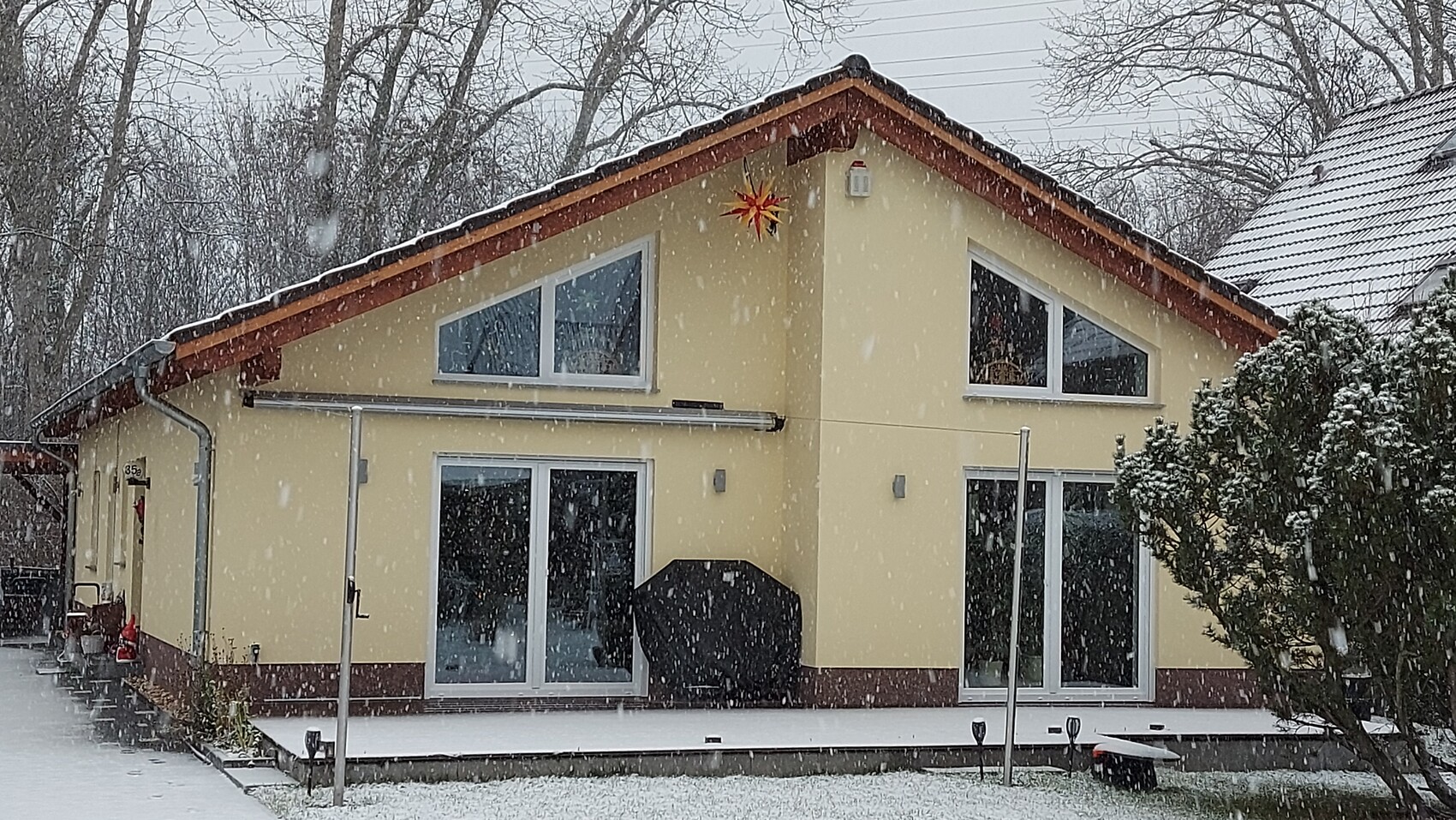

Yes, when the sun beats down at 35°C (95°F), going barefoot is out of the question, but it’s similar for stone and wood surfaces.
We have a sunshade sail above, which is always half or fully extended during the summer.
It provides shade for the open patio door as well as the table and chairs, which otherwise get very hot.
From March onwards, our living space is extended to the terrace and garden, and we switch to barefoot living.
