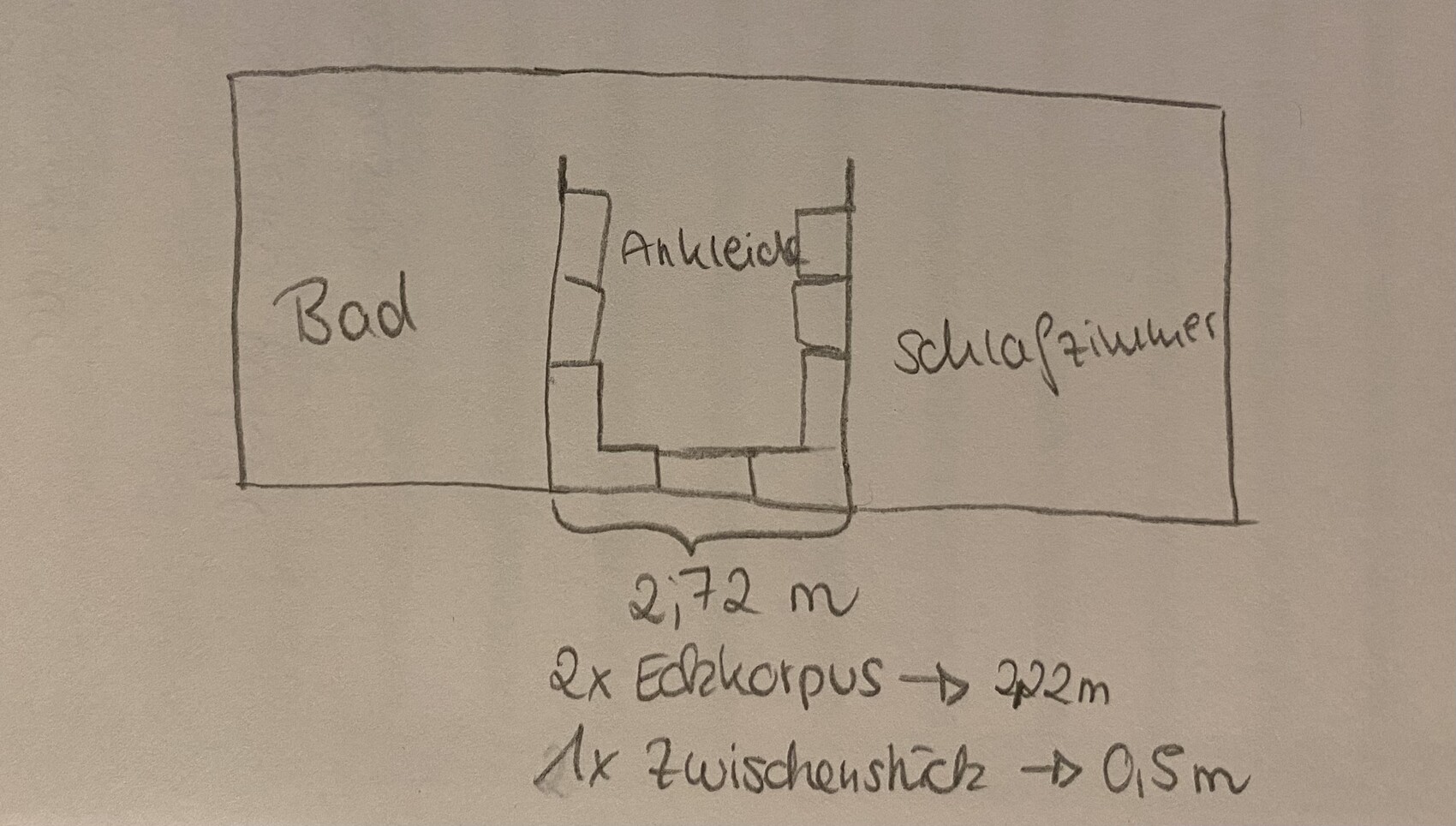

It is very important to me that the IKEA Pax wardrobe fits into the walk-in closet. According to our planning, the Pax is 2.72 m wide (9 ft). Should I make the distance between the walls exactly 2.72 m (9 ft) wide, or do you usually allow some clearance? If yes, how much?

I’m really curious to know which Pax wardrobe combination adds up to 272 cm (107 inches).
Katha_92
31 Mar 2022 20:23
kbt09 schrieb:
I’m really curious about which Pax wardrobe combination adds up to 272 cm (107 inches).
Thanks for asking, maybe I’m making a mistake in my thinking. I quickly sketched it out below.
Image 1: my drawing

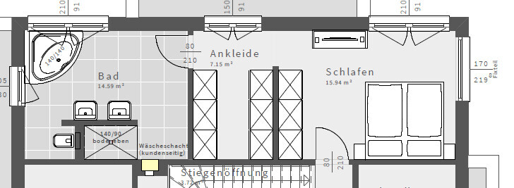

Image 2: our floor plan. I want to move the wall between the dressing room and bedroom so that the Pax fits perfectly, hence my question about the available space.
Looking forward to your answers and ideas.
Hand-drawn floor plan sketch showing bathroom, dressing room, and bedroom
Apartment floor plan: bathroom, dressing room, and bedroom with furniture like bed and wardrobes.

Katha_92 schrieb:
Thanks for asking, maybe I have a flaw in my reasoning. I quickly sketched it below.
Image 1 my drawing
Image 2 our floor plan, I want to adjust the wall between the dressing room and bedroom so that the Pax fits perfectly, which is why I’m asking about the tolerance.
Looking forward to answers and ideas.
Don’t take this the wrong way, but it will never fit perfectly at the corner like that.
If you arrange the dressing room as shown on the floor plan, it will fit. The corner arrangement requires both walls to be built, plastered, and wallpapered with millimeter precision. I can predict that due to tolerances, this won’t work.
If you want something that nice, consider having a built-in wardrobe installed there. It will be made to fit exactly to the millimeter. But it will also cost more than the Pax.
