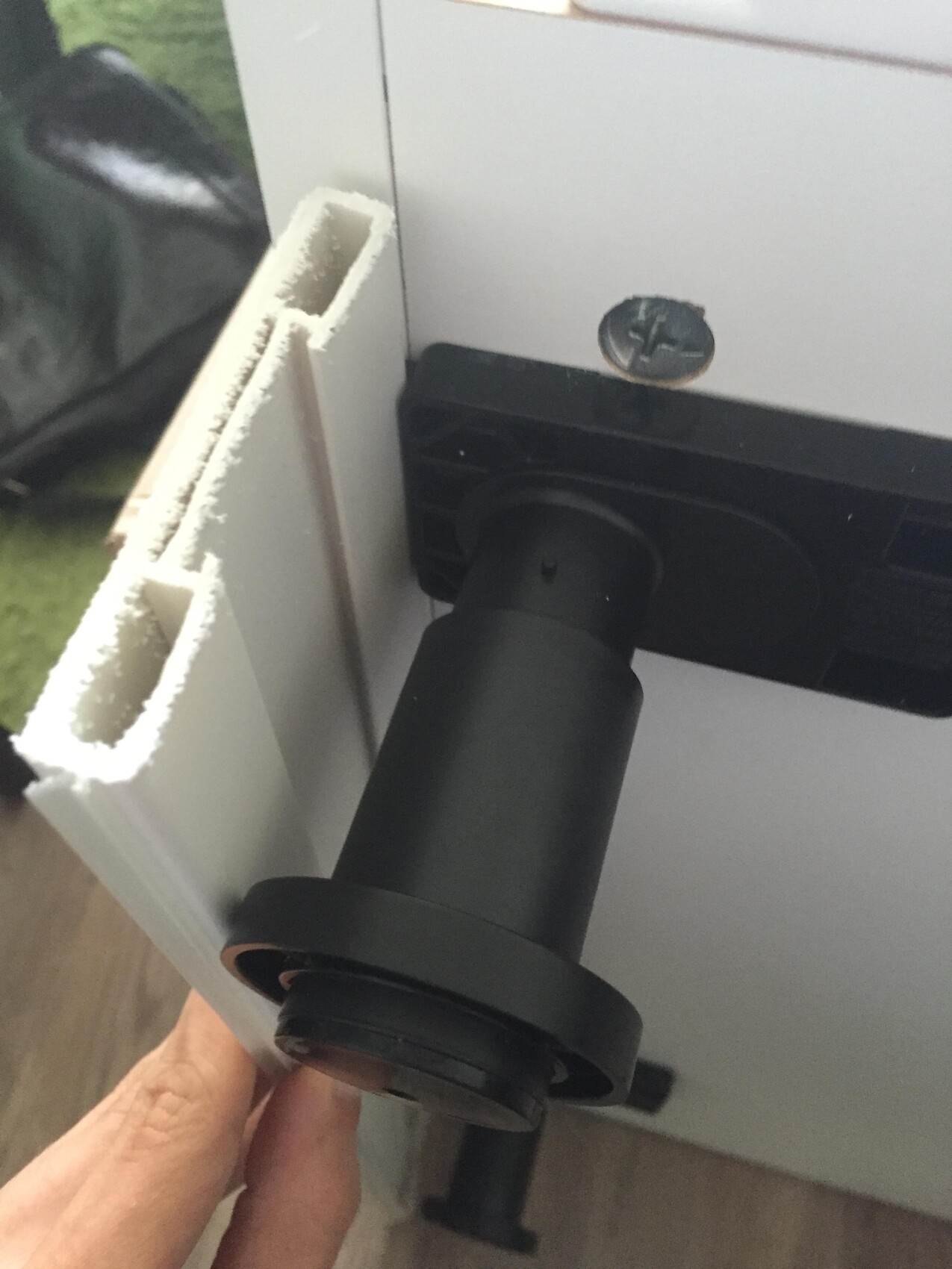

We will attach the cabinet to the wall tomorrow and hope that the feet can support it. The issue with the baseboards remains. The biggest problem is that I don’t know exactly how the side parts of the baseboard are supposed to be fixed.
Option 1: This way, the brackets that surround the feet would hold the foot perfectly. However, the manual seems to indicate that the baseboard should not rest on the narrow black surface of the foot.

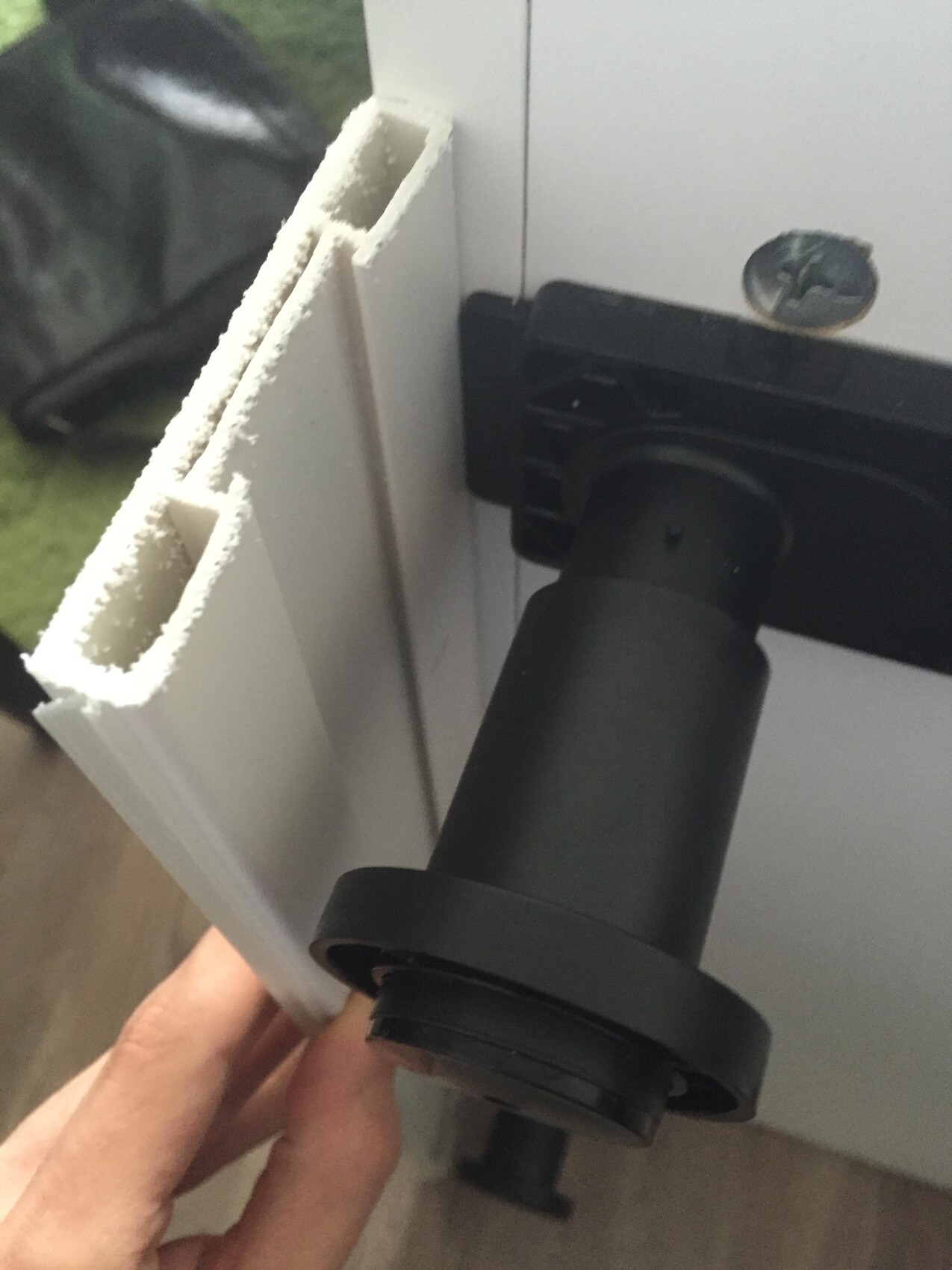

Option 2: In this case, the baseboard would not rest on the narrow black surface of the foot (as shown in the manual), but the brackets would no longer be long enough to fully grip the foot.
So, I’m not sure how to proceed here.

robi_aus_ffm7 Aug 2016 13:45On page 2 of the foundation base instructions (top left graphic), you can see the correct version.
In your case, the first picture.
