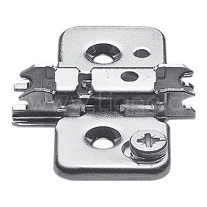

13 Feb 2016 20:11
32 - Hole spacing
37 - Edge to hole spacing
You can get the plates at hardware stores, for example
