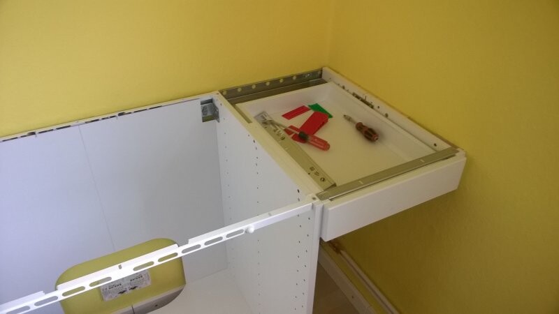

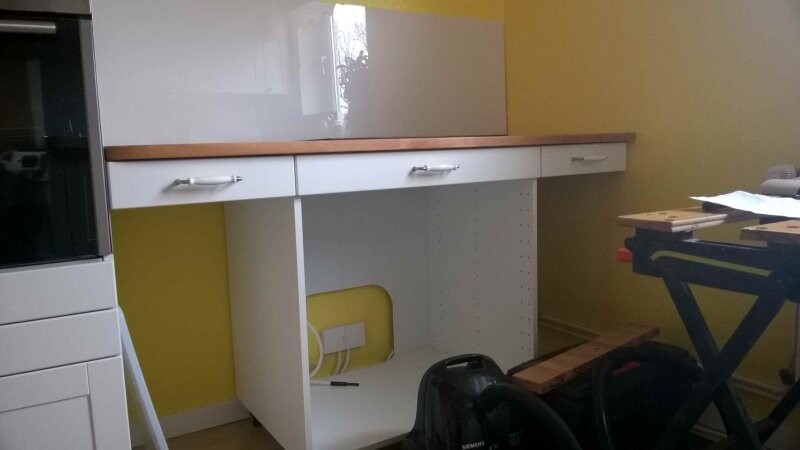

Handling individual parts through customer service varies with each customer, but I don’t think the steel braces for the base cabinets are orderable as separate parts. For my own design, I needed braces that were 40cm (16 inches) wide, so I simply bought the cheapest cabinet that included them. As expected, I was able to cut four “top panels” from just one cabinet instead of only two, because the side panels are perfectly symmetrical at top and bottom, including the rows of holes. This is in response to your question about how interchangeable/rotatable the parts of the Metod Modular are. See the pictures to understand why I did this:
Regarding the back panels, I previously thought there was no difference between top and bottom or whether it is a tall cabinet or not. However, it does depend on the cabinet width. Specifically, only the 80cm (31.5 inch) cabinets have two-part back panels (for packaging reasons). By the way, these are not reversible, so you will need to cut the back panels, including the cutouts, precisely. But if you measure carefully and work meticulously, this is very feasible using a jigsaw.
