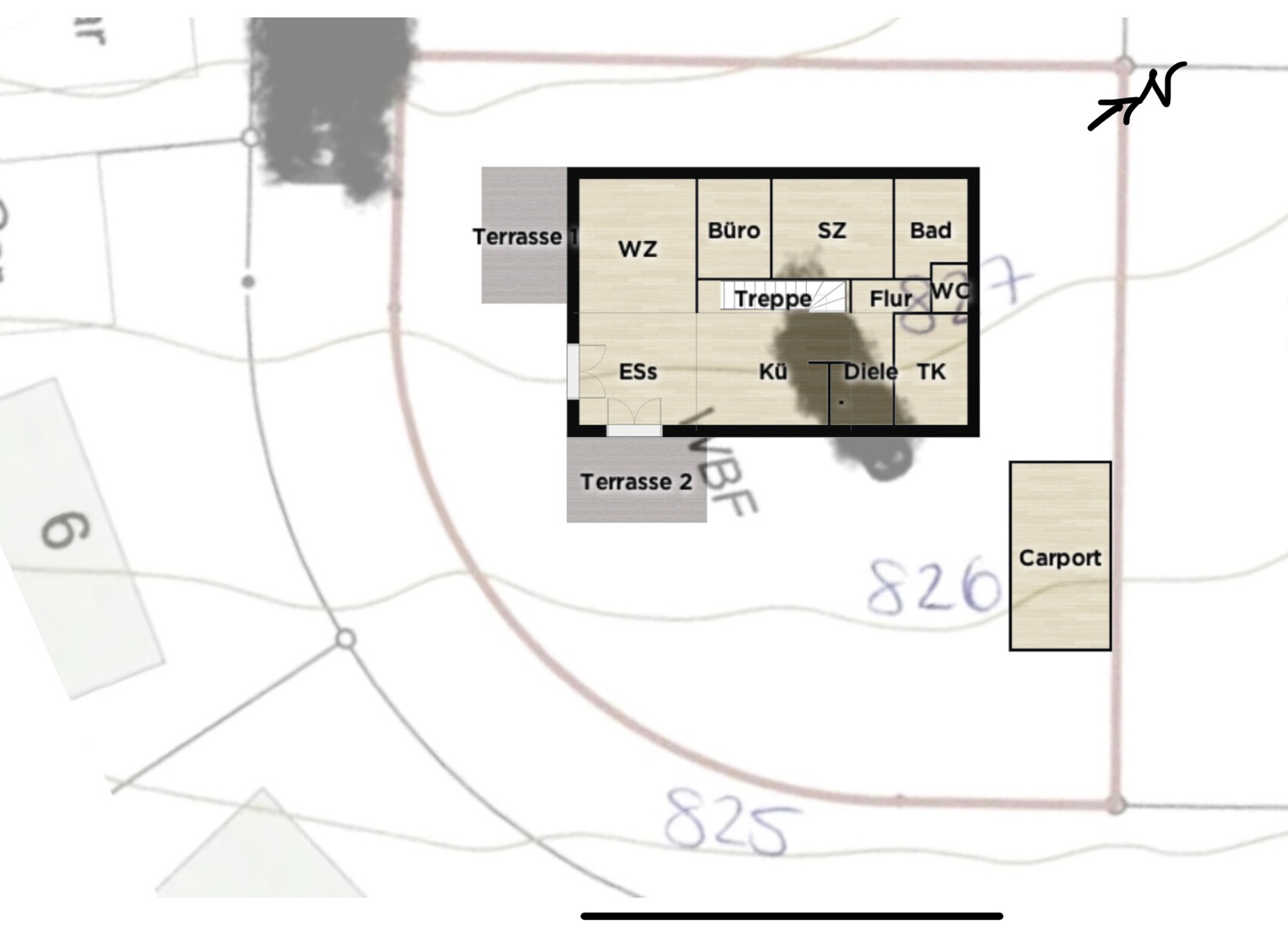

From which side would the driveway to the carport be? Am I understanding correctly that you place the ground floor into the slope towards neighbor no. 19 (elevation 827), which means one side of the house wall is embedded in the slope? The carport and house would then be at different heights, right?
@ypg: would it be possible for you to illustrate your ideas with a sketch for a rectangular bungalow? Maybe this is already included in your description, but just to be sure: should the house run along the side of plot no. 19 or 24? At what elevation would you place it, and where would the driveway to the carport/garage be? Thanks in advance

Osman82 schrieb:
@ypg: would it be possible for you to illustrate your ideas with a sketch for a rectangular bungalow? Maybe it’s already included in your description, but just to be sure: should the house run along the side of plot no. 19 or 24? At what height would you place it, and where would the access to the carport/garage be? Thanks in advance.
I have taken another look at the slope and ended up here to keep the earthworks minimal. The floor plan is just a compact example, but the child’s room and storage area (and a multifunction room if there is still space) will be under the roof with a gable facing SSW.
The height of the upper wall is at 827.5 or 827 meters (2714 or 2713 feet), on the southeast side next to the carport there will be a terraced garden, and towards the entrance there will be steps. The carport is located lower down.
P.S. Measurements are not exact and are therefore rough estimates.

I’ve taken another look at the slope and ended up here to keep the earthworks minimal. The floor plan is just a compact example, but the child’s room and storage space (and a multipurpose room if there’s still enough space) will be located under the roof with a gable facing south-southwest.
The height of the top edge of the wall is around 827.5 or 827 meters (2715 or 2713 feet), with a terraced garden to the southeast beside the carport, and stairs leading toward the entrance. The carport is positioned lower down.
PS: Dimensions are not exactly measurable and are therefore estimated.
I really like your suggestions. I will discuss or propose them to the architect during the initial meeting next week. Now I wonder if I need slope stabilization in front of the top edge of the wall or not. What do you think about the complexity of the earthworks? Does it make sense to place the photovoltaic system on the carport?
