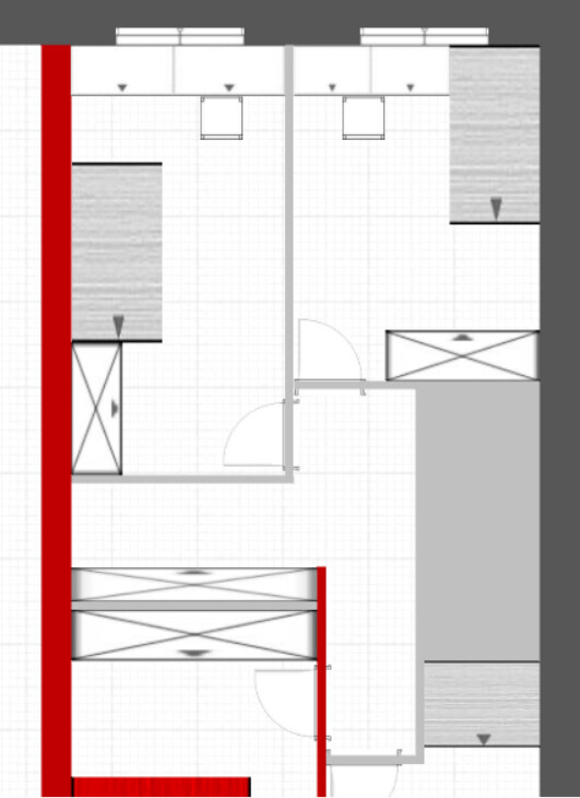

I am looking for ideas to optimize the use of space on the ground floor of our semi-detached house currently under construction.
The floor plans show the standard versions. We would like to close off the hallway to create a small entrance area. This is a bit challenging because the staircase and the door to the boiler room are awkwardly positioned. The boiler room door can only be installed to open outwards.
We are also considering extending the wall between the stairs and the living room to create a TV corner there. However, we are unsure if this would reduce the natural light too much.
The house is oriented east-west and has interior dimensions of 5.47 m x 11.37 m (18 ft x 37 ft).
I would appreciate any ideas!

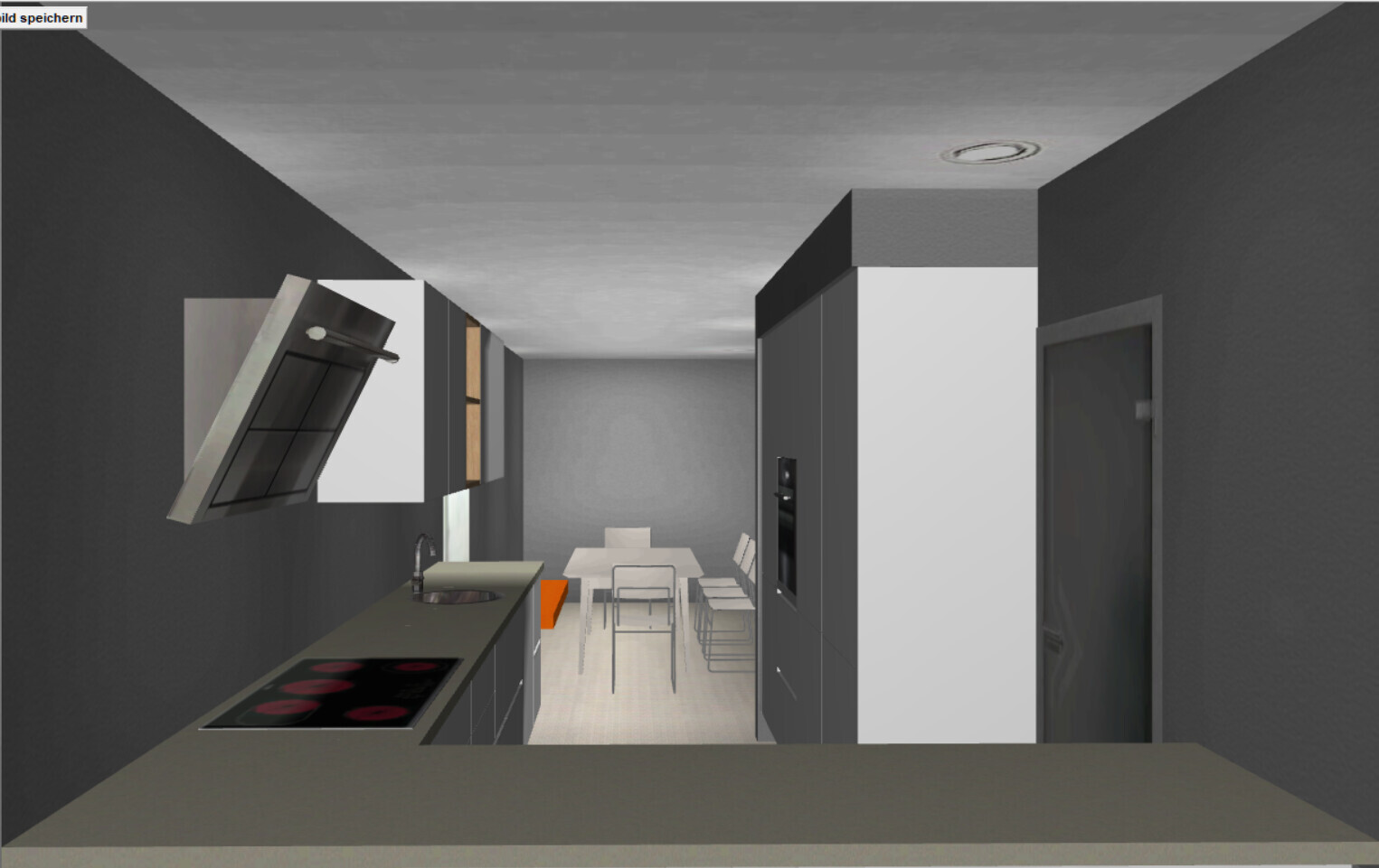

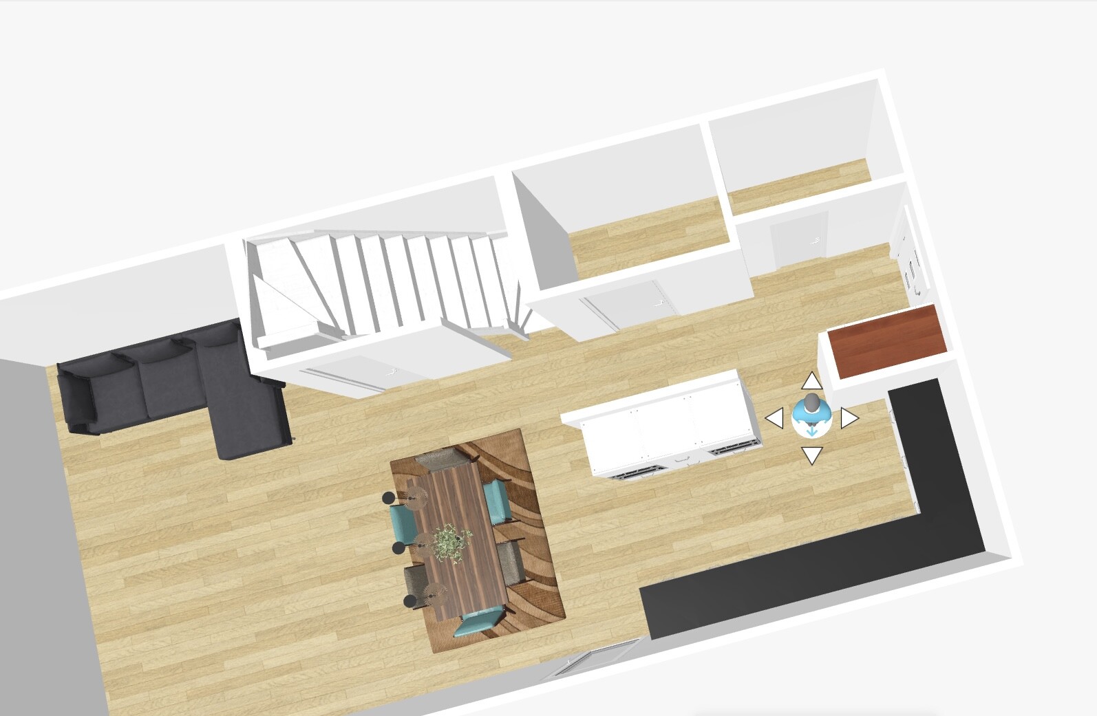

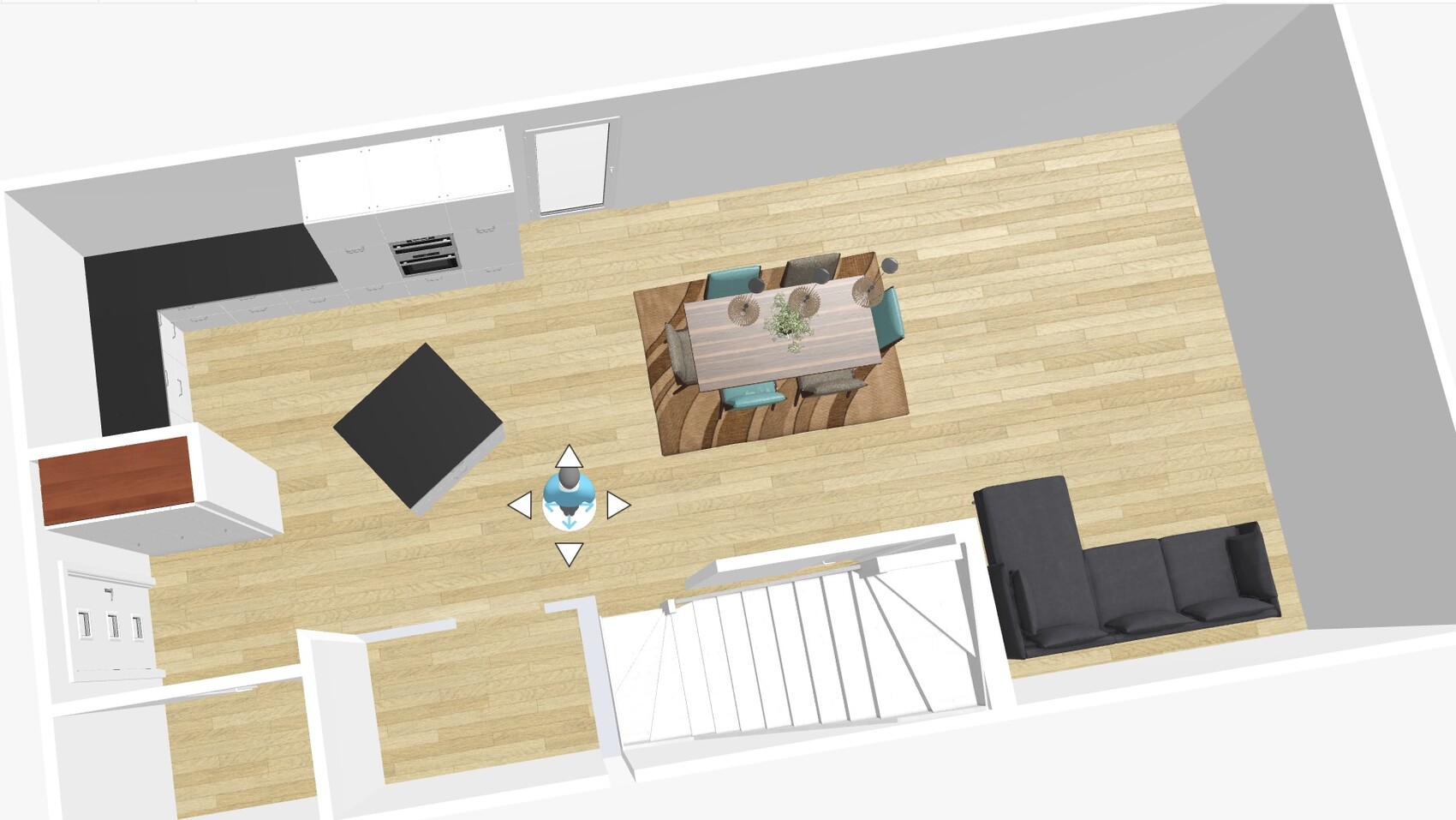

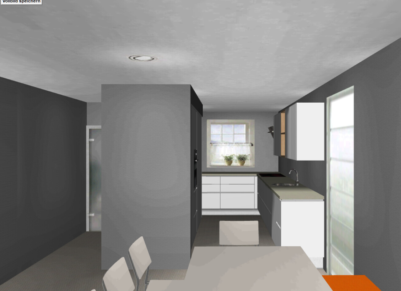

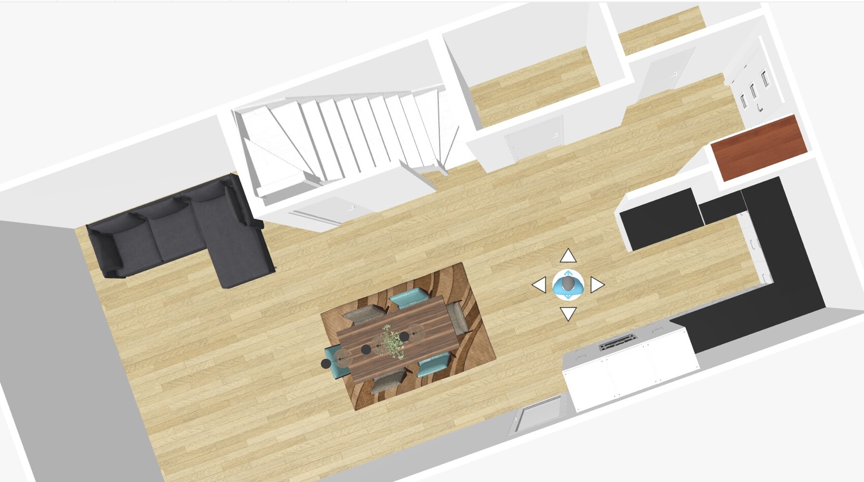

Thunderbolz schrieb:
My idea improves several things.
1. Closed hallway = no cold air flowing into the living area.
2. Separate heating circuit in the hallway that doesn’t have to be used = lower heating costs.
3. Slanted wall in the hallway = creates enough space between the open door and the staircase + direct view into the room when entering.
4. Extended wall in the living room = creates a cozy living area and space for a TV, etc.

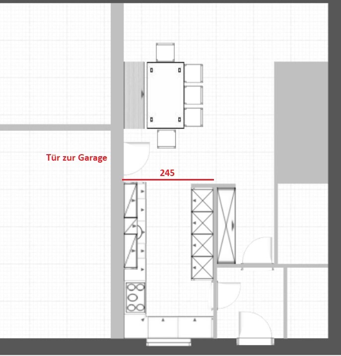

5. With straight walls, the kitchen appears sufficiently wide to me. The refrigerator could possibly be placed next to the oven cabinet. However, this might compromise ergonomics and potentially increase energy use (heat from the oven vs. refrigerator???). If anyone has constructive improvement suggestions, please share.

And here are the alternatives I would prefer before making a narrow house even narrower. Because the hallway will hardly make any difference, neither will an additional door. The heating system will probably heat the hallway together with the guest bathroom, and anyone entering the house will first want to feel at home rather than linger longer than necessary in a cramped hallway… so they will initially spread out into the room. This is something you will have to live with and be able to accept in such a tight space.

[ATTACH alt="grundrissideen-eg-doppelhaushaelfte-577714-1.jpeg"]72126[/ATTACH][ATTACH alt="grundrissideen-eg-doppelhaushaelfte-577714-2.jpeg"]72127[/ATTACH][ATTACH alt="grundrissideen-eg-doppelhaushaelfte-577714-3.jpeg"]72128[/ATTACH]Thanks, I will take a closer look at that.Thunderbolz schrieb:
