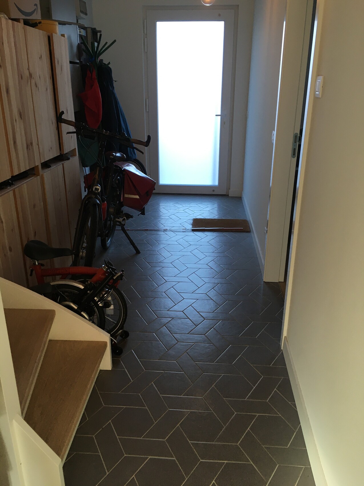

Bertram10024 May 2022 06:59I live in a house with the same dimensions and a slightly different floor plan downstairs: the WC and utility room have been moved to the middle of the hallway. The utility room is opposite the staircase, and the WC is beneath the stairs. This creates a wider hallway and a narrower connecting section in the open-plan living area. I don’t have the plan on hand right now, but there is a thread about it somewhere here in the forum.
In our case, the architect planned the kitchen in the narrow connecting space. I have storage and an office there instead, and moved the kitchen to the back in the large room with the terrace.
I think you have quite a lot of open-plan space for dining and living.
From experience, I can say that the hallway with a coat area is really important. I have a narrow shoe cabinet and a bicycle in the hallway, and there is still enough space to pass through. I hang jackets on an old-school coat stand.
I find living in a house like this very practical. Not too much area to clean, but everything is convenient and easy to use. Of course, a bit more house width would be nicer, but it’s really quite okay. The hallway could be a bit brighter. My front door has a lot of glass with frosted film. That lets in some light, but not a lot.

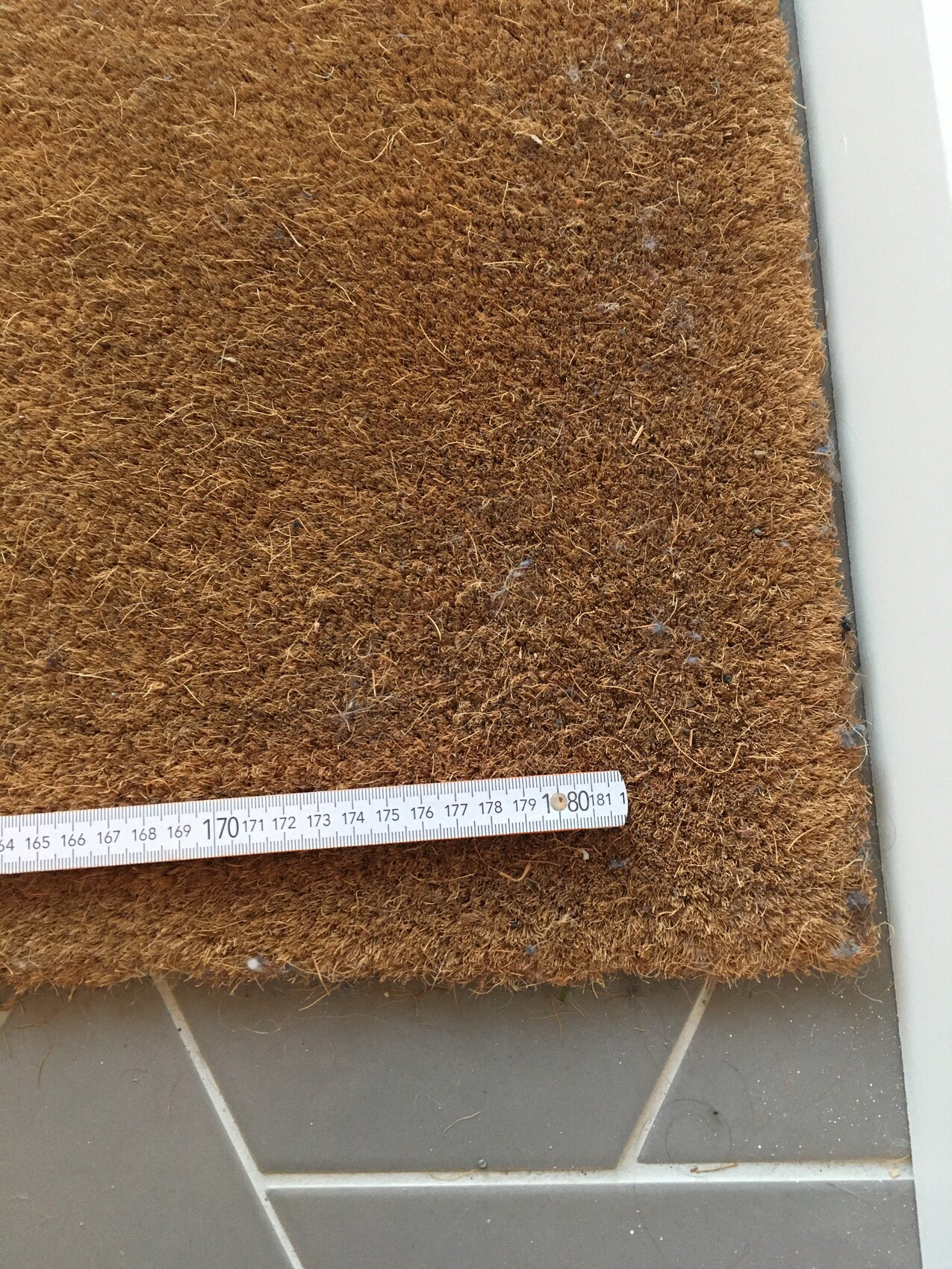

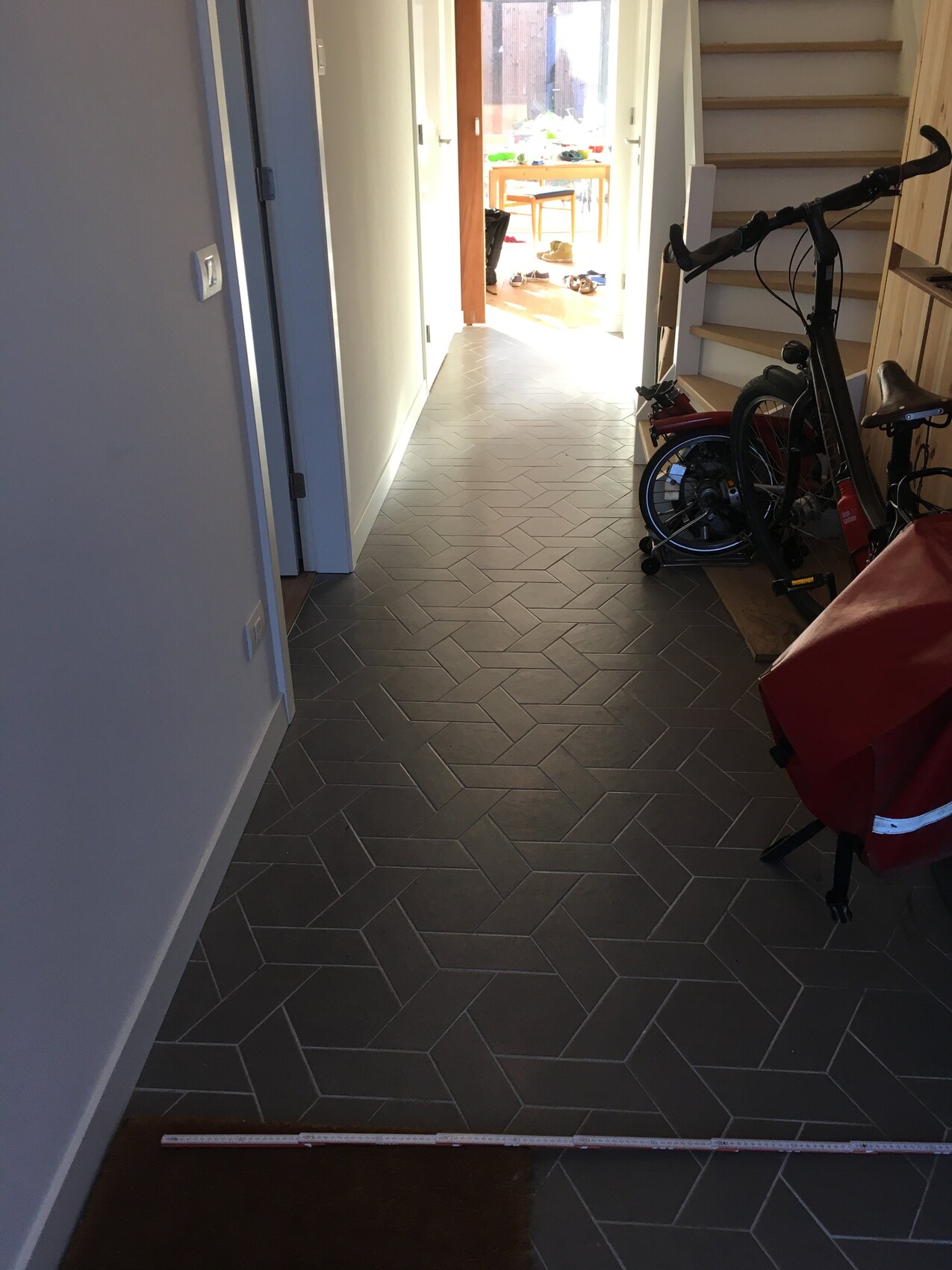

Bertram10024 May 2022 07:34Bertram100 schrieb:
I have a narrow shoe cabinet and a bicycle in the hallway, and there’s still enough space to walk through. I just measured again and took a photo: the hallway is 185cm (73 inches) clear width at its widest point. I find having the coat rack "along the walking direction" the most practical solution ever. Large houses often have a coat nook that offers more room to move but is usually not aligned with the walking direction; instead, it forms a recess you have to “step into.” Not very practical, in my opinion. But I’m also not a fan of hanging jackets on hangers. It’s too complicated for me. Hanging jackets on hooks suits me better.
I think the narrow house would have benefited from a side door opposite the stairs on the south side, the kitchen/dining area in the west, and the living room with a wood stove in the east. But it’s too late for that now. For a household with children, I would probably prefer a separate hallway. In any case, I would definitely allow natural light into the kitchen, as it makes everything feel more spacious. I would also go with @Myrna_Loy’s suggestion to include the cupboard between the kitchen and hallway.
