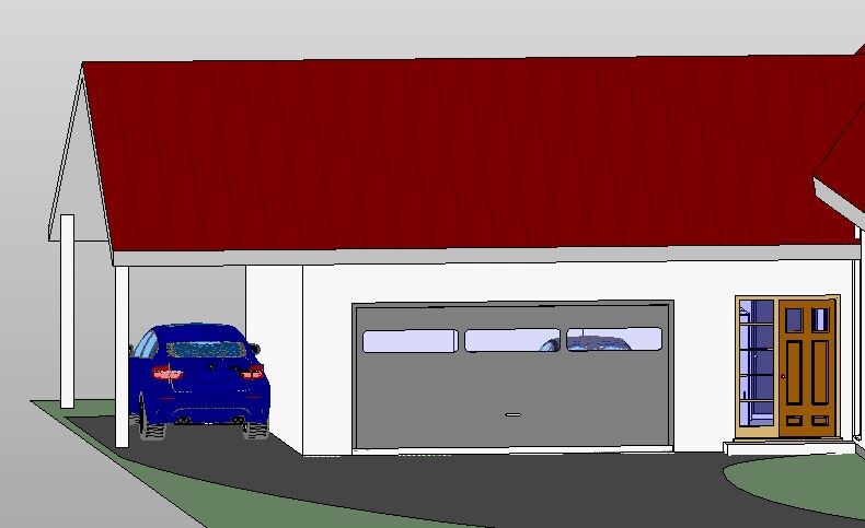

Is a carport considered independent from a garage? Our idea was this: We want to build the garage set back from the property line, so we can design the entrance area (windbreak) as we want and could even convert the garage later on. Since not all three vehicles would fit into the garage, we planned to build a carport by extending the garage roof:
Grundriss eines Hauses mit Garage, Carport, Windfang, Diele und WC
Frontansicht eines Einfamilienhauses mit rotem Dach, grauer Garage und Holztür.
Is this allowed under building regulations/planning permission, or have we overlooked something from the authorities?

MarcWen22 Aug 2016 18:14
Chilledkroet3 schrieb:
Then I guess that’s just how it is 🙁
However, a new question comes to mind:
Is a carport considered separate from a garage?
This is possible as long as the carport is at least 3 meters wide (10 feet).
Alternatively, you can divide a double garage into two single garages. That way, your plan would work.
You just have to know that—we didn’t want two single garages.
It’s paradoxical, but that’s how the authorities’ rules are.
