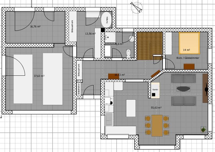

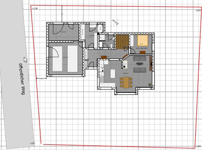

Hello dear forum members,
as a previously silent reader, I have already gained some valuable insights from your posts, thank you for that! I would now appreciate feedback on our current planning status from this distinguished group of experts. I am open to any criticism and would, of course, also welcome constructive suggestions :-)
I hope the information provided is sufficient to get an idea of our project.
Best regards and many thanks
Thomas
Key Data:
Development Plan / Restrictions:
Plot size: 740 sqm (8,000 sq ft)
Slope: approx. 2.6 meters (8.5 ft) across the entire plot
Setbacks: 1.75 m (5.7 ft) on the east side (public path there), and 3 m (9.8 ft) on north and south
Number of parking spaces: minimum 2
Number of floors: maximum 2 full stories
Maximum heights / limits: ridge height 6.30 m (20.7 ft), knee wall 0.75 m (2.5 ft), roof pitch 35 to 50 degrees
Client Requirements:
Roof type: gable roof
Basement, floors: no basement, 1.5 floors
Number of occupants, ages: 4 people – 2 adults, 2 children aged 1 and 3 years
Office: home office 1 to 2 days per week
Guests per year: 1
Open or closed architecture: open architecture
Traditional or modern style: open modern style
Open kitchen, island: open kitchen with island
Number of dining seats: 6
Fireplace: yes
Balcony, roof terrace: optional roof terrace above garage
2D floor plan of a house with living room, kitchen, fireplace, and guest room
Modern 3D house view with garage, large windows, and visible interior
3D house model with garage and dormers, side view.
Floor plan of a single-family house on the plot showing the street side and interior rooms
2D floor plan of a house with bedrooms, children's rooms, bathroom, and hallway
Detailed 3D house model with roof and interior in gray
3D house model: gray building with sloped roof and chimneys

Hello!
You must be joking, right? You’re about to submit the building permit / planning permission and come up with such minor details? I doubt an architect has even seen this.
Where is the input planning? Sections and elevations? Where is the development plan? You have a 2.3m (7.5 feet) slope and you present perfectly flat elevations?

PanoramaBau schrieb:
provided information
Dimensions would be helpful. The site topography as well. You can still rotate quite a bit on the floor plan. The small office is pointless, the hallway to the possible terrace too. I would also try to reduce the corridor area a bit. 30m² (320 ft²) is quite a large figure.

Why do you think the draft of the application planning is needed? Maybe for the measurements and the orientation? The position on the plot? The contour lines on the plot? Want to know anything else?
31 Jan 2019 21:24
What made you decide to position the house, including the entrance, on one side, turned 90 degrees to the street?
