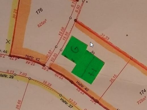

PanoramaBau1 Feb 2019 09:19Hello everyone,
first of all, thank you for your feedback!
I understand that some information might still be missing. Unfortunately, besides the key heights indicated in the "Property" image, I don’t have any additional drawings yet.
Maybe I wasn’t completely clear: we would like to submit the building permit / planning permission application soon but are still currently in the design phase. The construction will be done without a general contractor, and based on an initial rough estimate, the financing seems feasible for the house size and our requirements.
From the chat discussion I took away the following:
- Possibly reconsider the size of the hallway
- The small office might not be practical
- The slanted wall on the ground floor may not look very appealing
Here are a few more thoughts on the plan:
- The office is intended as a "backup" solution in case a third child is expected, which is not ruled out :-). We also considered an office in the attic but prefer a solution on the upper floor.
- The driveway is located on the south side (see image), and to the east there is only a public footpath.
Thomas

Mottenhausen1 Feb 2019 10:27I like the idea of the west-facing roof terrace. However, I would shift all the rooms on the upper floor and place the access to the roof terrace through the office. This way, hallway space is saved, which can then be used to expand the office by cleverly rearranging the other rooms.
Uh, and just because he's an “expert,” he’s allowed to act like a macho guy here? If someone uses the wrong tone, it’s okay for the original poster to respond, but a third party doesn’t necessarily have to get involved, in my opinion. ;-)
PanoramaBau schrieb:
- Slanted wall on the ground floor might not look so nice An 80s wall can definitely work with a modern floor plan. I would question the headroom over the bed and bathtub, but besides that, I find the design quite well developed. Of course, there are many ways to do it differently—tastes vary.
In any case, I’ve seen many much clumsier designs here (where you can only access the toilet by backing in, or wardrobe doors won’t open properly, and so on). In your case, I only notice somewhat too thick interior walls, but that’s fine—it gives you a few extra centimeters (inches) of room width during the fine-tuning phase everywhere.
