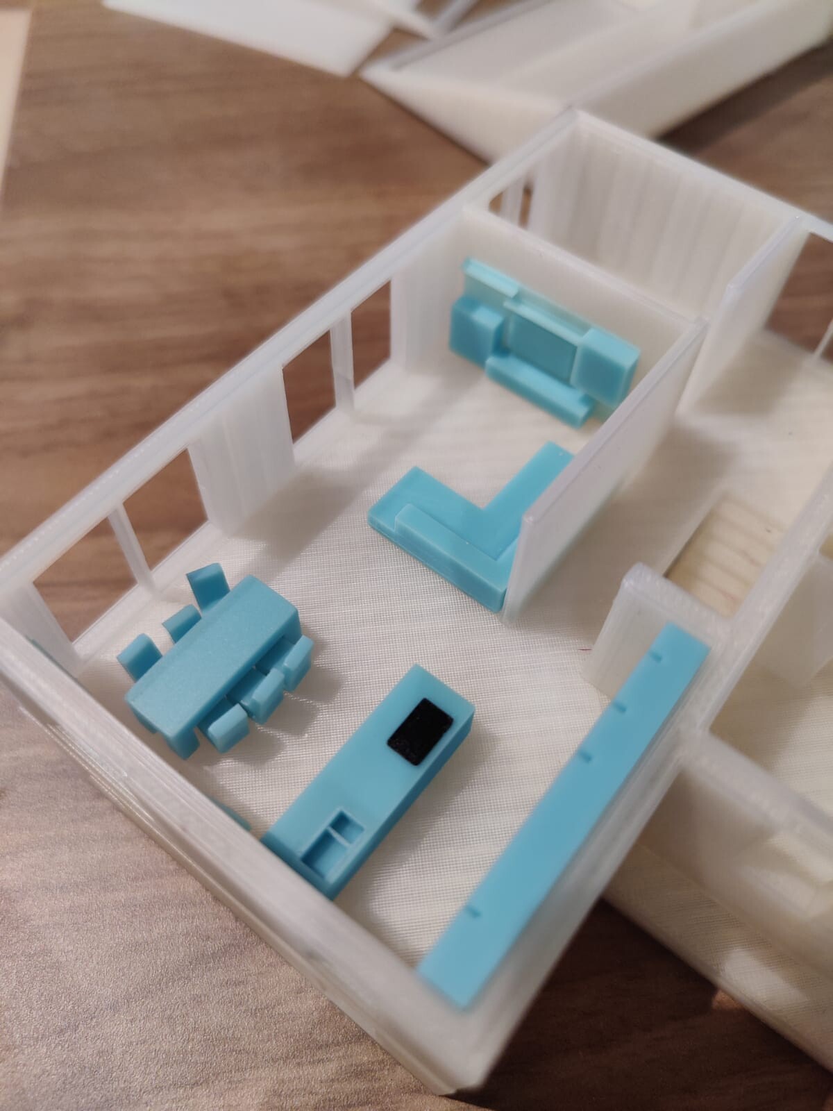

The furniture shown in the plans is 90% our current furniture.
My husband wanted to optimize the “furniture in the floor plan” a bit. The results are attached.
NoSchnitzers19 Dec 2020 09:30We prefer the model as well, but if we have a fireplace, the passage will become very narrow. For us, it was important to see that both options would be possible.
Yes, a swivel arm definitely has its advantages.
