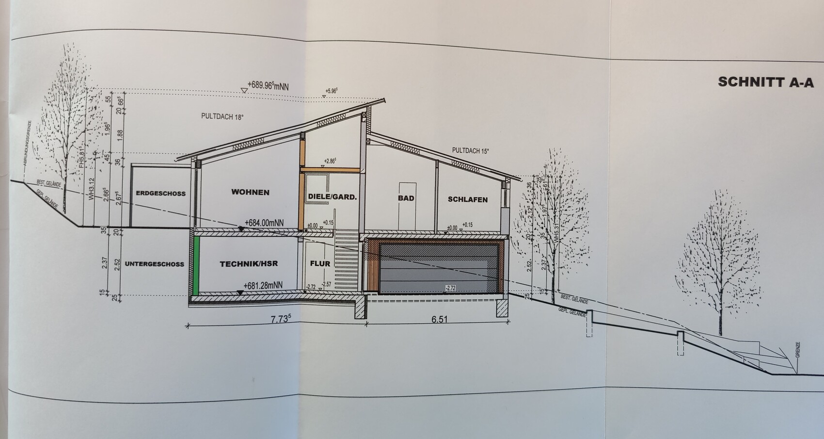

Please add more height references. Why do you call a first floor a "ground floor" when its floor level is above the eaves of the neighbors?
My recommended reading is: https://www.hausbau-forum.de/threads/werkplanung-efh-180qm-flachdach-mit-keller-doppelgarage.26277/ by @ivenh0
NoSchnitzers29 Nov 2020 13:22Hello 11ant,
what exactly do you mean by upper floor and ground floor? Basically, we have a basement, ground floor, and attic.
The floor is above the eaves of the neighbor on the right but at the same level as the residential building of the neighbor on the left (the building on the left, which is so close to our property, is a barn).
Attached is a sectional drawing for reference.
Regarding the height measurements: do you mean those related to the slope?
The street is at about 678 meters (2224 feet) elevation.
The basement is currently at about 681.5 meters (2236 feet), and the ground floor at 684.5 meters (2248 feet).
We are satisfied with the position of the house; our main focus is on the room layout on the ground floor.

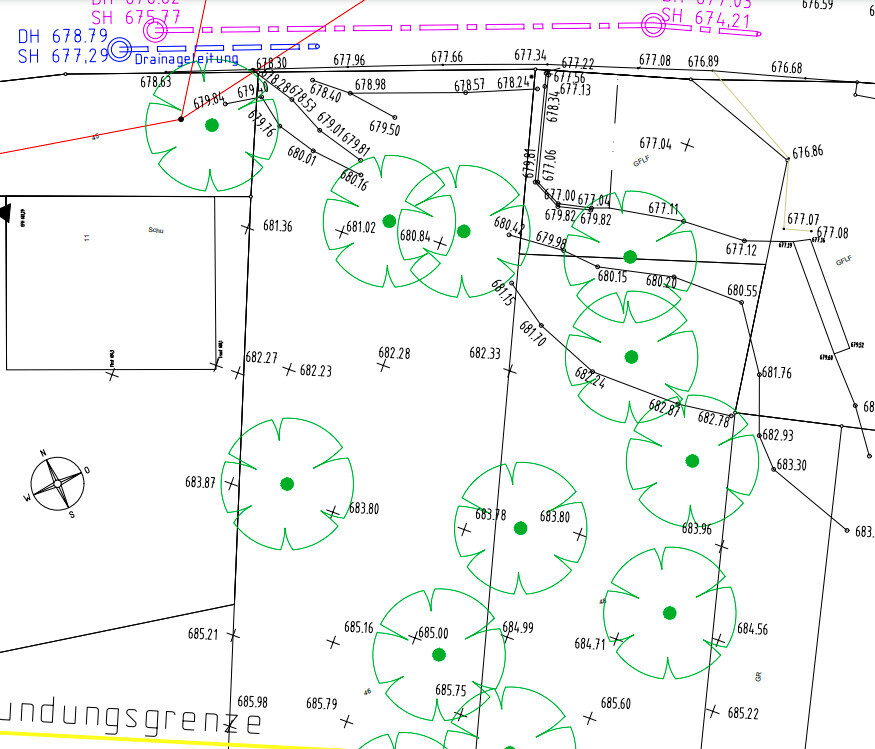

NoSchnitzers29 Nov 2020 14:03haydee schrieb:
How does the building boundary run?
What is this tiny granny flat for?
Why do you block windows with the garage? The line marked as the rounding boundary is actually the end of the building plot. Otherwise, we only need to respect the boundaries to the neighbor. But as I said, we are satisfied with the position of the house. We are only concerned about the layout of the bathroom, children’s room, and master bedroom.
We do not intend to rent out the granny flat. We have various options for how we want to use it, and the size is sufficient for these purposes.
Which windows are being blocked by the garage?
The garage borders the hallway in the basement and the workshop, which has windows on the side.
hampshire29 Nov 2020 14:04This is not a garage wall in front of the window, but the end of a foundation wall at ground level. The garage serves as a parking space.
