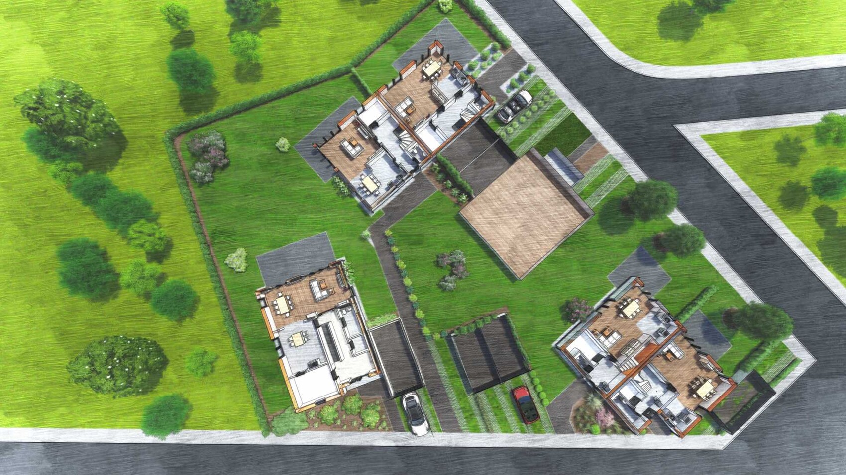

Only the kitchen windows would be located directly by the carport or across from the neighbor’s garage.Yes, a site plan plus any applicable regulations regarding access or parking spaces would be helpful. What about the neighbor—do you already know them? Is the same general contractor building their house?kaho674 schrieb:
Talk to us first before bothering 100 times. Otherwise, he’ll just become resistant.
Yes, a site plan plus any regulations regarding access or parking spaces would be helpful.
What about the neighbor, do you already know them? Is the same general contractor building there? Yes, it is the same developer; so far, we don’t know any of the other buyers.
Attached is the site plan or overhead view. It’s the house at the very top...
Basically, it would be optimal if the kitchen were where you have currently planned the staircase, hallway, and WC.
But due to the garage/carport, unfortunately, the entrance cannot be placed on the other side.
Wow, that’s what I call a bad offer. Honestly, I wouldn’t buy that. It would have to be located right in the city center to be worth it. If I may summarize:
The west side is blocked by the neighboring half of the building, the south side by a garage and another neighbor, the garden and terrace face the street to the northeast (it couldn’t be worse), and the plot is tiny.
This will be a dark cave. No sunlight, neither inside the house nor in the garden – and on top of that, you’ll have to breathe in traffic fumes from the street and be watched by passers-by while on the terrace. Plus, you’ll be living right next to a stranger.
What does the general contractor want for the land? At least is it really cheap?
If you buy it, you should consider what to do with the car beforehand. I would try to keep the south side clear – no carport or garage, just a parking space. The southern neighbor will probably build their garage there, so to what extent you’d still get light through the southeast corner would need to be tested with a sun simulator. But for that, the southern neighbor would have to finish before you. You should also consider a more open design concept, for example bringing additional light through the stairwell from the upper floor or something similar.
Honestly, I’d tell the general contractor to go take a hike and keep looking.
