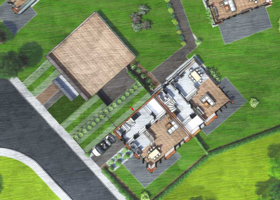

Looking at the other designs, one wonders if the designer has any understanding of sun orientation and natural light at all. Almost all the houses face north. The only one with a southern view has no parking space next to the house. The showpiece seems unsellable. What a waste of building land!
duke1085 schrieb:

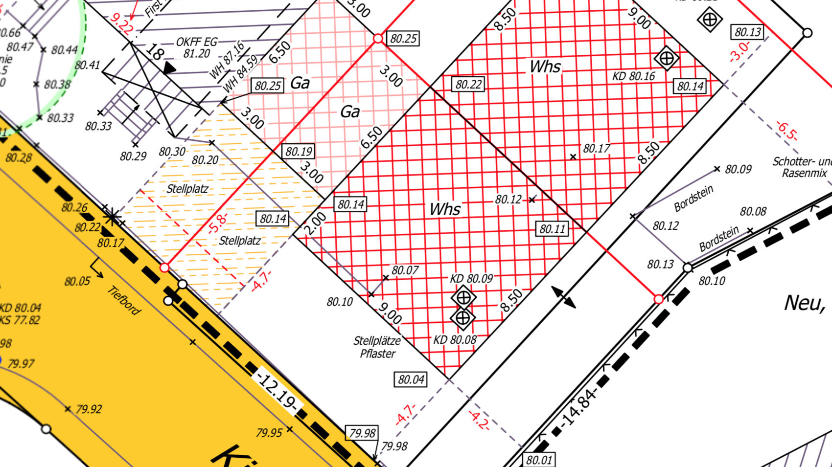

Good morning, I forgot to mention that the orientation in the plan is not aligned to the north.
This means the street side is the west side. The terrace/garden with the large window front faces south.Hello. Oh, that changes everything, of course. So please rotate it 180°. I take back everything and claim the opposite.
If it were mine, I would only reserve one parking space for the car in front of the house. If you push a little, maybe enough space for two. Definitely relocate the entrance to the northwest. Kitchen in the west corner.
A new plan is needed.
kaho674 schrieb:
Hello.
Definitely move the entrance to the northwest side. Kitchen in the west corner.
That's exactly what I meant. Oh, and on the top floor, we want to have one large room instead of the guest room. Possibly with an additional walk-in closet. I would also swap the bathroom and laundry room on the first floor.
