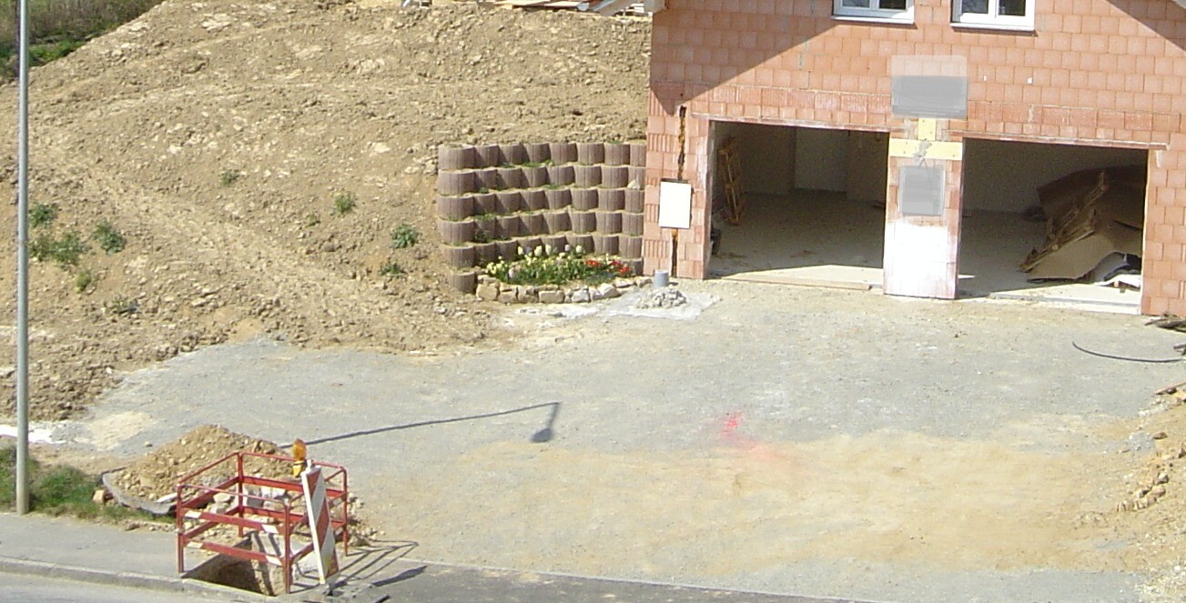

@aniussi89 if possible, take a look at the original first, especially regarding rain; I also have some pictures related to this. Rain and the resulting water volumes were a real problem, which you shouldn’t underestimate if you decide on the pathway surface. I’m not sure if the issue was caused solely by mediocre workmanship. As mentioned, the surface then becomes almost impermeable, but with gravel the problem disappears.
I also recall a YouTube video about the difficult repairs. I don’t want to discourage you at all, just want to make you aware of these circumstances.

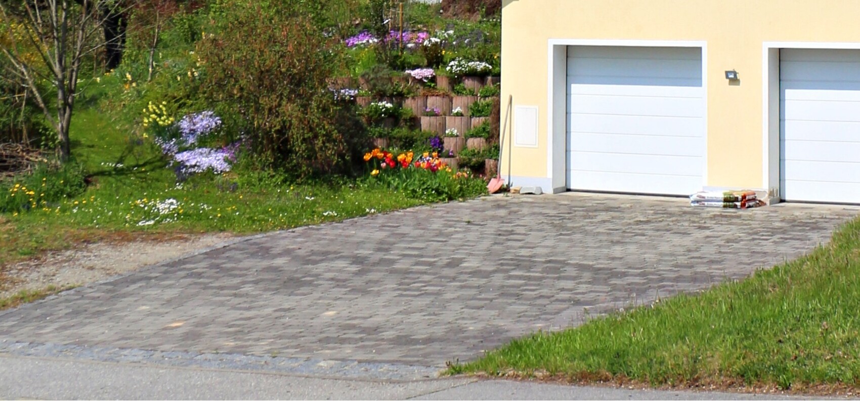

felicitias_123 Feb 2025 09:07Gravel was spread in our driveway, and an additional parking space was gravelled on the left side of the picture (the brown area is soil washed in during heavy rain from the neighboring field).
The area in front of the garage was paved later, while the parking space remained as it is, is in use, and does not show any ruts or similar damage. It is gradually being overgrown with vegetation. We mow it regularly to keep it short.
