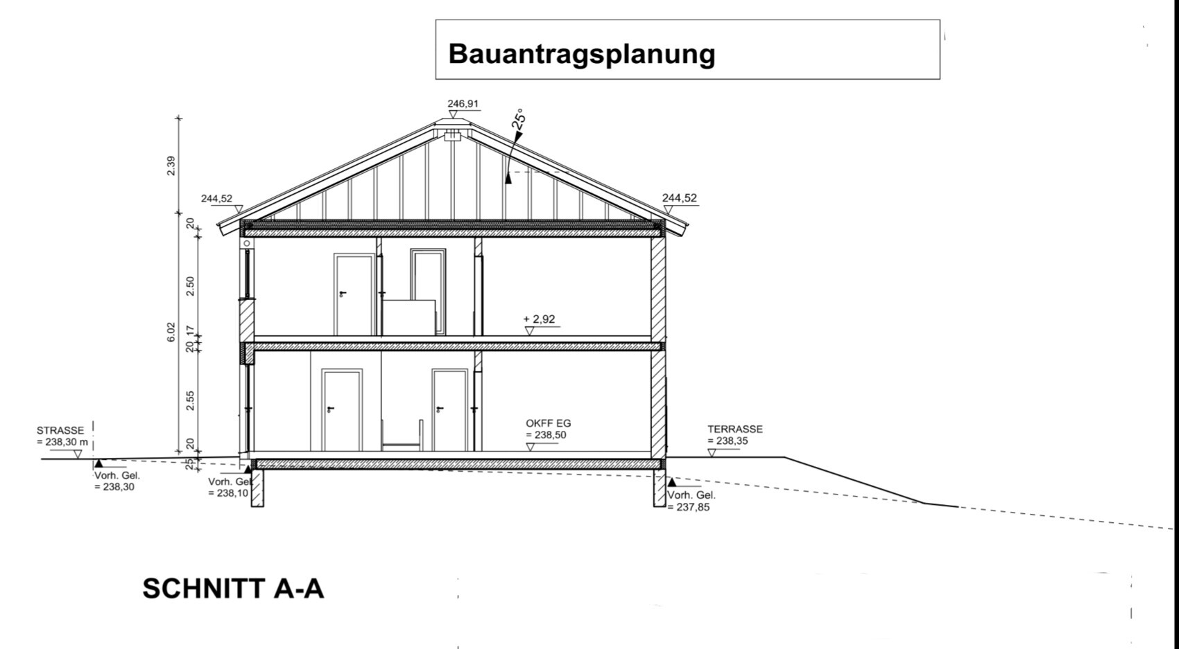

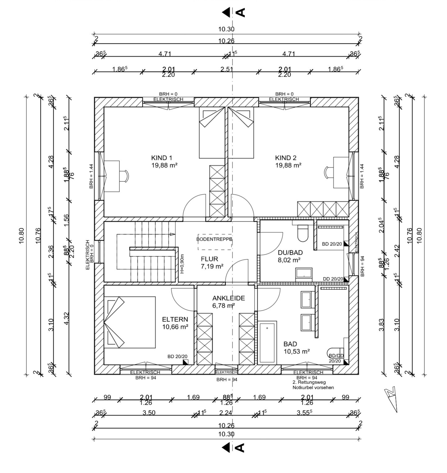

- A partition wall will be added in the walk-in closet. That would theoretically allow watching TV from the bed. I am considering a lightweight wall. I plan to place a 211cm (83 inches) Pax combination wardrobe in the closet. The closet is planned with a raw width of 218cm (86 inches). Do you think 218cm is enough for the Pax once the walls are plastered, or how wide should the rough dimensions preferably be?
- Is the hallway on the ground floor too narrow?

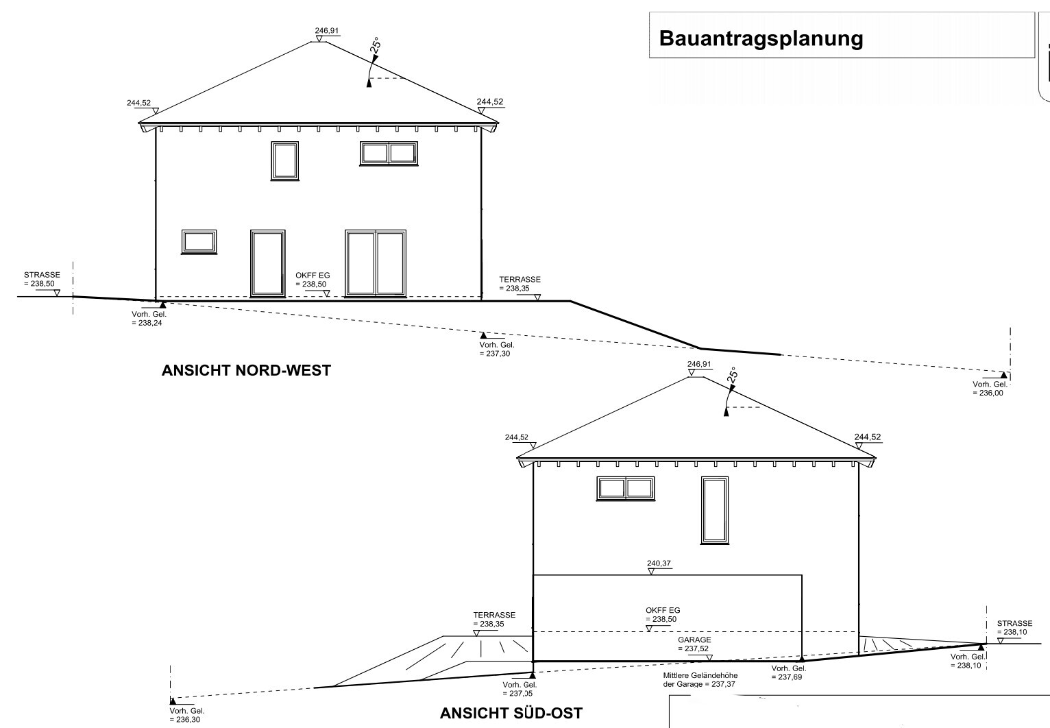

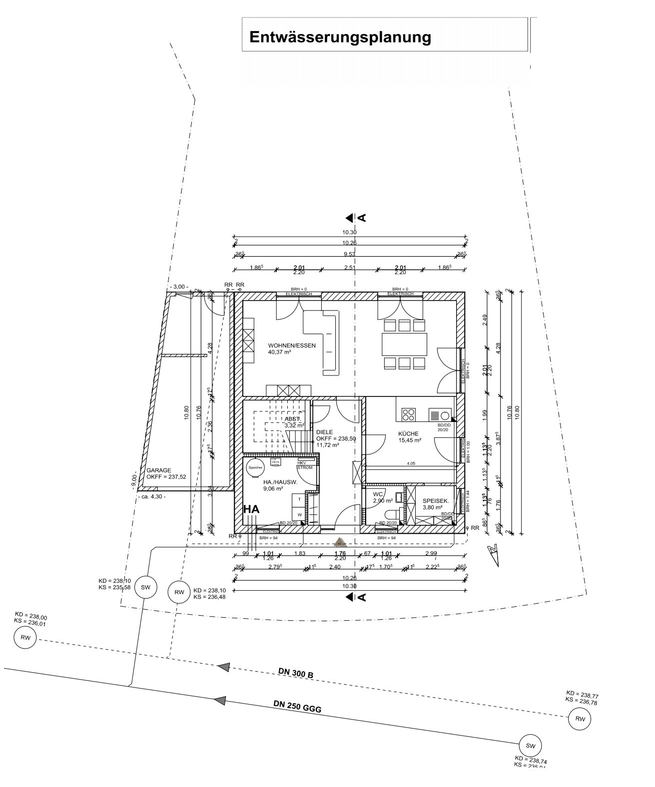

- Would you raise the ground level? The house would be 40cm (16 inches) below street level. If I build a terrace into the garden, it would be about 1m (3 ft) difference. You could raise only the house level, resulting in approximately 1.6m (5 ft) difference between terrace and garden. I don’t know anyone living below street level. Raising the garden would probably not be allowed without permits, and affected neighbors likely wouldn’t agree. On the sides of the house adjacent to neighbors, raising is permitted only up to certain limits. I am overwhelmed with the decision.

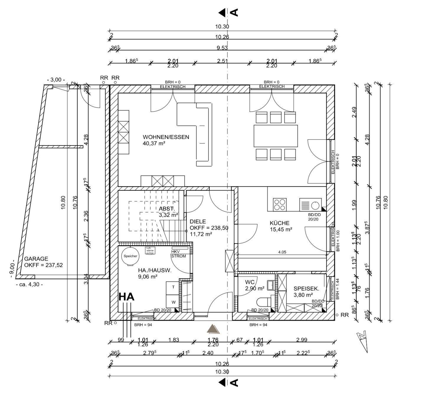

- Do you have any ideas for arranging the sofa differently and placing the TV sensibly? My husband doesn’t want the sofa back facing a window. I still need to get used to placing the sofa in the middle of the room.
- Is the kitchen size sufficient for a nice kitchen with an island?

We would move the staircase up by 20cm (8 inches), which would make the lower rooms larger. Now you want to rearrange a few centimeters again *sigh*
Shiny86 schrieb:
Or do you already like the current layout? (in which post) did I miss a fixed external dimension? – I don’t understand all the splitting of centimeters.

Hello, the new drawings are here. What do you think?
We are backfilling around the house, but unfortunately, the garage will be 1m (3.3 feet) below the level of the house.
I’m not completely satisfied with the plumbing layout in the bathrooms. I want to manage without shower doors made of glass. Somehow, I had imagined it differently. Do you have any ideas for the bathrooms on the upper floor?
The window arrangements have all been changed as well. What do you think about the directions in which the windows and doors open?
