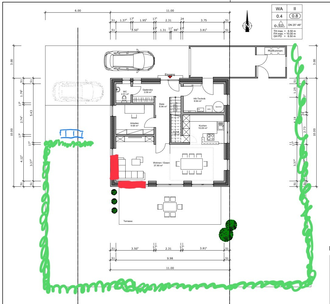

I quickly sketched a rough layout of how we currently envision the hedge (green), trash bins (blue), and windows in the living area (red). For the windows, as mentioned, we want floor-to-ceiling glass with a width of about 2–2.5m (6.5–8 feet). To the west, privacy will be provided by the hedge, and to the south is the garden.
For the coat area, we are planning it as it has worked for us so far, so we expect it to be less than 2m (6.5 feet). That is sufficient for us. However, we appreciate this detailed point.

I quickly sketched something in a rough & ready way,
Corner window 😱 I’m out!
